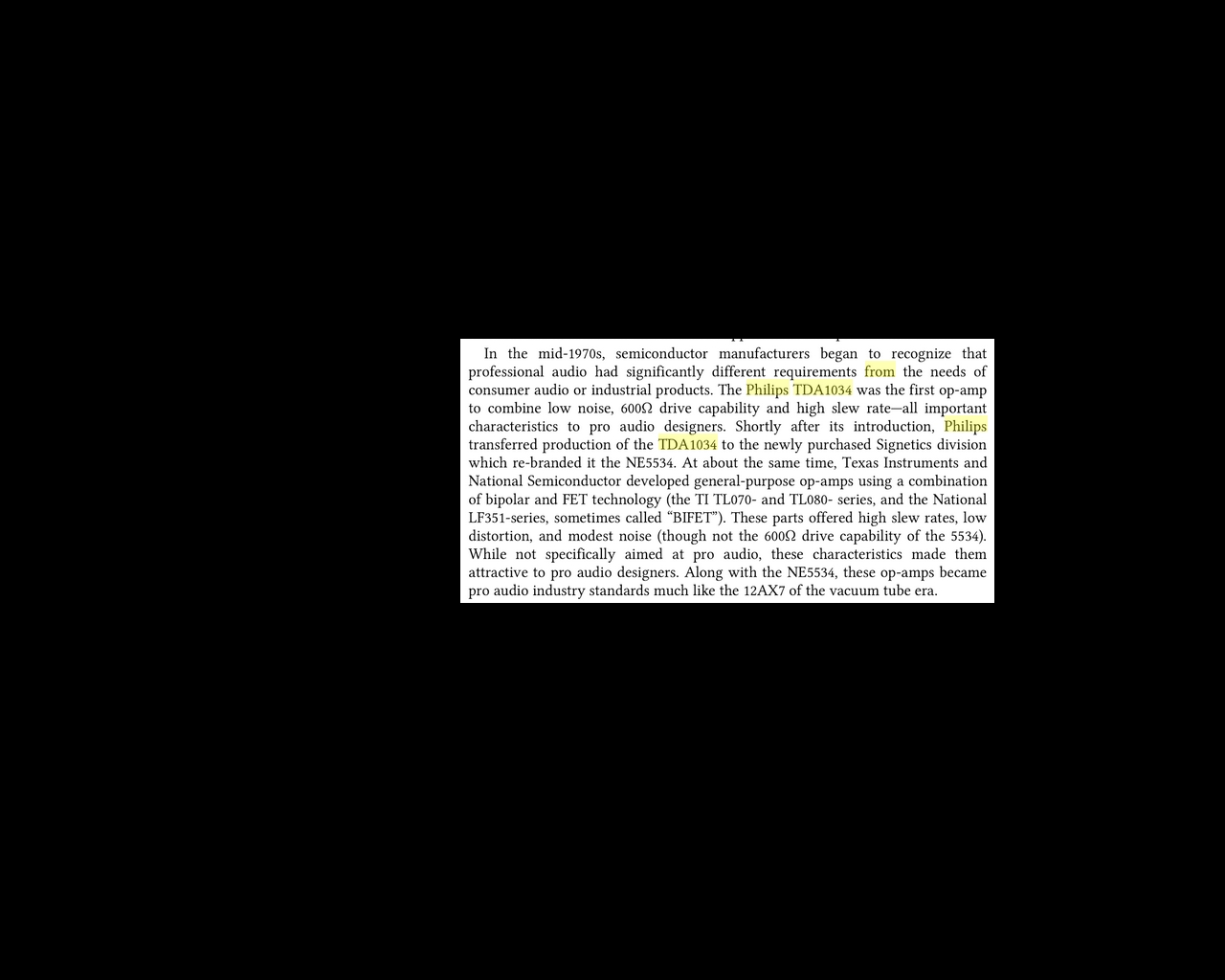

When did signetics and philips join up? was it 1975?
When did signetics bring out the NE5534?
I think it was 1979, or a bit earlier.
I don't know exactly but it started as the TDA1034 from Philips. Then with the acquisition of Signetics it changed to NE5534.
I also have a few Fairchild SE5534's and even some milspec Raytheon RJ5534's
Jan
I had forgotten about the TDA1034
Here's what I found:
