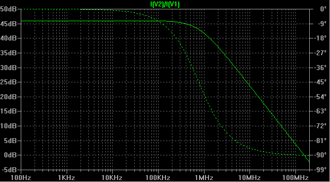

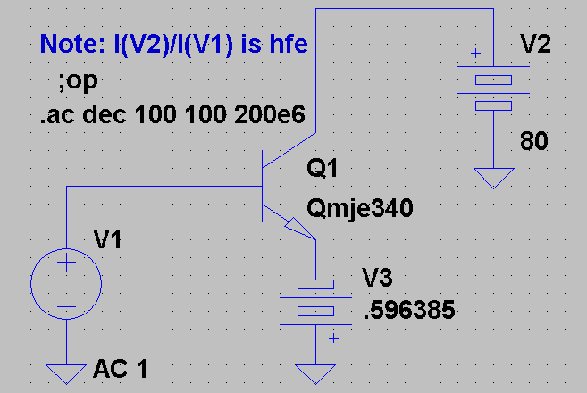

Well, ACR's post got me to wondering what's going on. So I came up with a simple circuit to simulate ft for the MJE340 and MJE350. The test circuit for the MJE340 is shown below. I'm running them at 5.2 mA, with about 80V across them. I got the models from OnSemiconductor. I've pasted the models below. I first put a current source of 5.2 mA in the emitter, then did a DC operating point sim to find Vbe. Then I replaced the current source with a voltage source of the Vbe value just obtained. This is to provide the required AC ground to the emitter for determining hfe correctly. I'll show the plot of hfe vs frequency next...
.MODEL Qmje340 npn( IS=1.03431e-13 BF=172.974 NF=0.939811 VAF=27.3487 IKF=0.0260146 ISE=4.48447e-11 NE=1.61605 BR=16.6725 NR=0.796984 VAR=6.11596 IKR=0.10004 ISC=9.99914e-14 NC=1.99995 RB=1.47761 IRB=0.2 RBM=1.47761 RE=0.0001 RC=1.42228 XTB=2.70726 XTI=1 EG=1.206 CJE=1e-11 VJE=0.75 MJE=0.33 TF=1e-09 XTF=1 VTF=10 ITF=0.01 CJC=1e-11 VJC=0.75 MJC=0.33 XCJC=0.9 FC=0.5 CJS=0 VJS=0.75 MJS=0.5 TR=1e-07 PTF=0 KF=0 AF=1 Vceo=300 Icrating=500m mfg=OnSemiconductor)
.MODEL Qmje350 pnp( IS=6.01619e-15 BF=157.387 NF=0.910131 VAF=23.273 IKF=0.0564808 ISE=4.48479e-12 NE=1.58557 BR=0.1 NR=1.03823 VAR=4.14543 IKR=0.0999978 ISC=1.00199e-13 NC=1.98851 RB=0.1 IRB=0.202965 RBM=0.1 RE=0.0710678 RC=0.355339 XTB=1.03638 XTI=3.8424 EG=1.206 CJE=1e-11 VJE=0.75 MJE=0.33 TF=1e-09 XTF=1 VTF=10 ITF=0.01 CJC=1e-11 VJC=0.75 MJC=0.33 XCJC=0.9 FC=0.5 CJS=0 VJS=0.75 MJS=0.5 TR=1e-07 PTF=0 KF=0 AF=1 Vceo=300 Icrating=500m mfg=OnSemiconductor)
Okay, here's the plot. ft is defined as the frequency for which the magnitude of hfe extrapolates to unity, assuming a 20 dB/decade slope at the extrapolation point. You can see that the slope is 20 dB/decade all the way out to the 0 dB point, so we can read it straight off the graph. The value of ft is 152 MHz. If anything, this seems optimistic to me. But it's hard to say, since the data sheets seem scientifically designed to say as little about the devices as possible . At any rate, I wouldn't call this a problem at all. Perhaps there's some other problem, or ACR used a different model than I did? BTW, I got very similar results with the MJE350.

Regarding the pessimistic results you're getting, you wouldn't happen to be using the On Semiconductor MJL3281A and MJL1302A models would you? If so, I've found these models to be way out in left field - completely wrong. I'm not sure if the devices were oscillating when they measured them, of if they just don't know how to extract the parameters correctly, or what. If you are using these devices, I can post models for the Toshiba 2SC3281 and 2SA1302 that match up much better with the data sheet and expected theoretical performance. Also, the brand new MJL4281a and MJL4302a have models which are totally wrong. 0.4 Volts VBE for 45 mA Ic? I don't think so!
With SPICE in general, the problem is usually the models, not the simulator. The simulator is really just a big nonlinear equation solving system. I've compared CircuitMaker, PSPICE and LTSPICE using identical models and gotten nearly identical results (within hundredths of a dB), even including FFT stuff. But to get the same results with the FFT, I had to force the time steps to be the same between the different simulators. The CircuitMaker residual distortion is extremely low. They must do some additional processing behind the scenes to get this kind of performance. I'm calling "nearly identical results" with the FFT the values of the signal and harmonics, not the residual noise in between. The only thing I don't like with LTSPICE is that the FFT stuff is extremely fiddly to set up. I wish they'd improve that.
Unfortunately, there's tons of totally wrong models floating around. One of the first things I did with CircuitMaker was to do some DC biasing with a current source that used a 1N4148. I got some really strange results. I put a current source of 1 mA into the diode and found that it gave me a voltage drop of 0.8 Volts. Wrong! Put in the 1N4148 model from LTSPICE and everything was fine.
