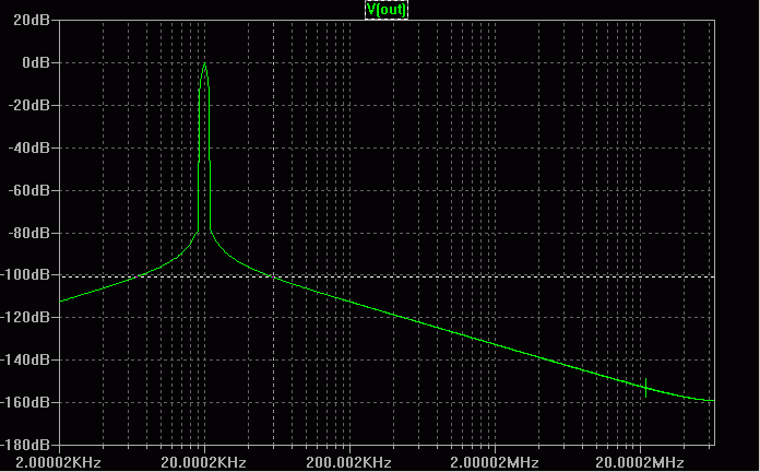

traderbam said:Andy,
When you are measuring "distortion" what exactly are you/the simulator measuring? Is it all distortion or a subset like THD?
BAM
I'm only looking at the third harmonic, so it's a pretty limited concept of "distortion". This all started when I read a discussion in the LTSpice user's group on Yahoo about doing Fourier analysis. What people were doing was choosing the time duration of the transient simulation and the number of points in the FFT such that the resulting time step was much smaller than what LTSpice would use if it chose the time steps itself like it does normally. The required time step is then calcuiated by hand and specified as the maximum time step. I do 12 cycles of 20 kHz for a total duration of 6e-4 sec. I choose 65536 points for the FFT, so the time step becomes the oddball value of 9.155273438e-9 sec. Applying this to a simple sine wave source gives the results shown in the plot, with the residual noise about 100 dB down at the third harmonic of a 20 kHz sine wave.
At this point, I'm just trying to figure out the combined contributions of the VAS and input stage. The VCVS shown in my earlier schematics is there to eliminate the loading of the feedback network from the VAS. My original current feedback design had a third harmonic that was only 40 dB down from the fundamental at full power and 20 kHz. With the Slone circuit with collector resistors in the input diff amps, it's about 60 dB down. The feedback factor in this amp is only about 15 dB at 20 kHz, giving a unity loop-gain frequency of a little over 100 kHz. So given this low level of feedback, I'm satisfied with the performance. I don't expect the actual measured performance to correlate very well with this, but it does offer a way of comparing the current feedback and voltage feedback designs.

Hello Mathias
you have to switch off any kind of compression mode in
Control Panel -> Compression . Please click all buttons off.
Next choose a time step of <= 1us, e.g. .TRAN 0 10ms 0 1us.
The result then looks very promising.
I recommend to move the .Fourier statement to its own command line,
otherwise you will not get the comfortable selection box for
the .TRAN statement.
I have attached another thread about fourier analysis with LTSPICE
where I was involved in the past.
Best Regards
Helmut

> > Hello Pierecarlo,
> > when you do discrete Fourier Transform(DFT,FFT), you only take a
> > snapshot from a signal. The discrete Fourier transform then
> > delivers the fourier coeffients of a signal which is equivalent
> > to an infinity number of concatenated snapshots.
> > What do we learn from that?
> > If your snapshot does not contain exactly full periods of all your
> > frequencies(signal), there will be a big discontinuity in the assumed
> > concatenuated signal from one snapshot(window) to the next.
> > As a result, your FFT gives you very broad peaks.
> > That's were the FFT-windows come into play. They force the signal
> > and there derivatives to zero at the ends of your snapshot
(window).
> > This helps but is by far not as good as a well choosen time frame
> > which contains only full periods of your signal.
> > FFT versus DFT
> > The result from the FFT is the same as from the DFT. The only
> > difference is the faster calculation with the FFT. This is
> > especially true when the number of data points is a power of 2.
> > Then a lot of similar calculations can be avoided by the clever
> > FFT algorithm.
> > Resolution and max. frequency
> > The frequency resolution of the DFT is 1/time.
> > If you have a FFT-time of 100ms, you get 10Hz resolution.
> > The max. frquency you get is fmax = 0.5*FFT_data_points/time .
> > Example: time=100ms, data points=16384 -> fmax about 800kHz.
> > Best Result of FFT with SwitcherCADIII
> > 1. Select .TRAN for exactly a full number of periods of your
> > lowest freuency in the signal.
> > 2. All compression modes off in the menue
> > Tools -> Control Panel -> Compression
> > 3. FFT Settings: Window none
> > Data points; 16384 points or more, depends on up to what
> > frequency you want to look.
> > You will reach sidebands below than -120dB and often they are
> > below -150dB which is more than adequate for your ears.
> > Best Regards
> > Helmut
> Just one minor adjustment :
> The signal must *not* contain full periods but full periods *minus*
one
> sample time (see what happens at boundaries when connecting the
samples).
> Using full periods leads to some still significant leakages that might hide
> useful details.
Hello Fred,
thank you very much for this correction. It is really important as you said that the last data point in the taken window is not the one which is the first data point of the the next window. This is as more important as less data points we use.
Example with a window of one period and 8 data points.
o o o o
o | | o o
o | | | | o o
o o | | | | | | o o
0 1 2 3 4 5 6 7
The whole thing is a bit more complicated due to the .TRAN analysis
which is normally set to another timestep then used by the FFT.
SwitcherCADIII then has to nterpolate the data points used for the
FFT.
Hey, a great idea came into my mind.
Select the time step for simulation to span/16384 for a intended
FFT with 16384 data points. The time step looked very odd,
but the result has been impressive. Now I have achieved -180dB !!!
spurious signal level for a pure sine source. Thanks Mike too for
the high numerical precision.
(window).
> > FFT versus DFT
> > FFT algorithm.
> > Best Regards
> > Helmut
one
samples).
> useful details.
Hello Fred,
o o o o
o | | o o
o | | | | o o
o o | | | | | | o o
0 1 2 3 4 5 6 7
FFT.
> One way to deal with that is to apply windowing to ensure both extremity of
> the curve will nicely join but this still leads to some leakages. This also
> apply only in the case you can post process the waveform, and I
don't know
> whether SWCad can do that or not.
> The other way is, provided you anticipate the FFT number of points,
to set
> the total simulation time to
> N*SigPeriod*(1-1/(2*FFTDataPoints)) i.e. N*SigPeriod - 1 sample
time
> Also let enough time for the transients to settle i.e. provide a
non null
> start recording time to the .TRAN
I agree, this is the next pitfall, because we always have bandwidth limiting elements (C, L) which lead to startup transients in the .TRAN simulation.
Best Regards
Helmut
