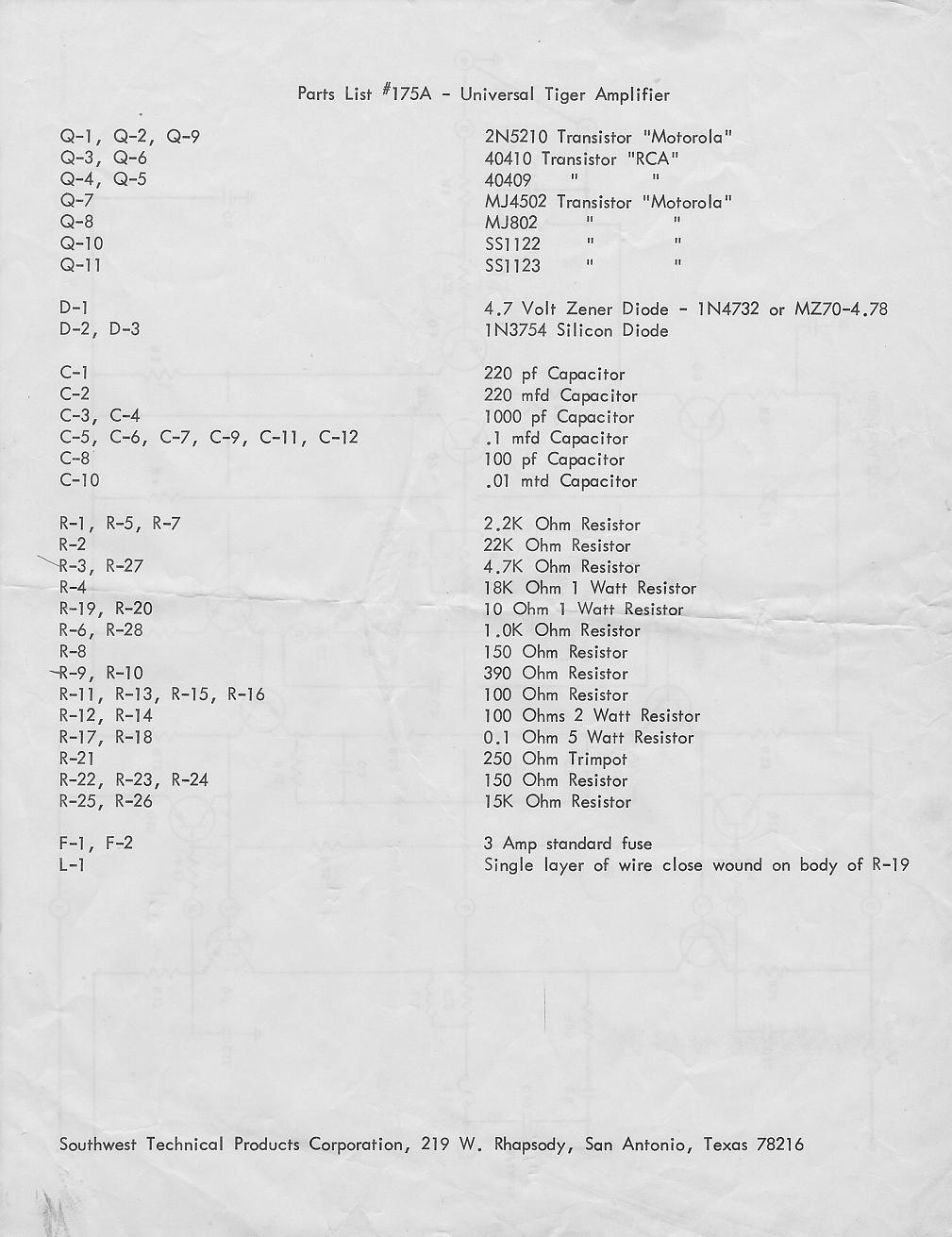

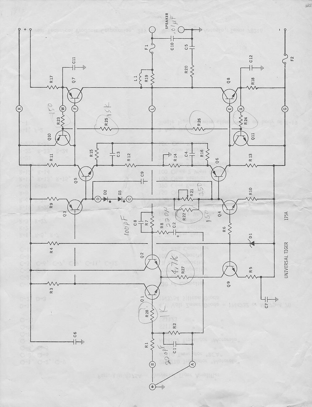

Universal Tiger MKII Schematic
George also sent the Universal Tiger MKII schematic which is the version with protection transistors and a few other minor changes:
C8 reduced to 100 pF
C10 reduced to .01 uF
R28 added 1K in series with the base of Q1
R27 added 4.7K in tail of diff pair
R21 bias pot increased from 50 to 250 ohms
R22 added 150 ohms across R21
Protection is SS1122/23 transistors:
C to base of outputs
E to rail
B through 150 ohms to Emitter of outputs
15K from B to output collector
Schematic and parts list are attached.
