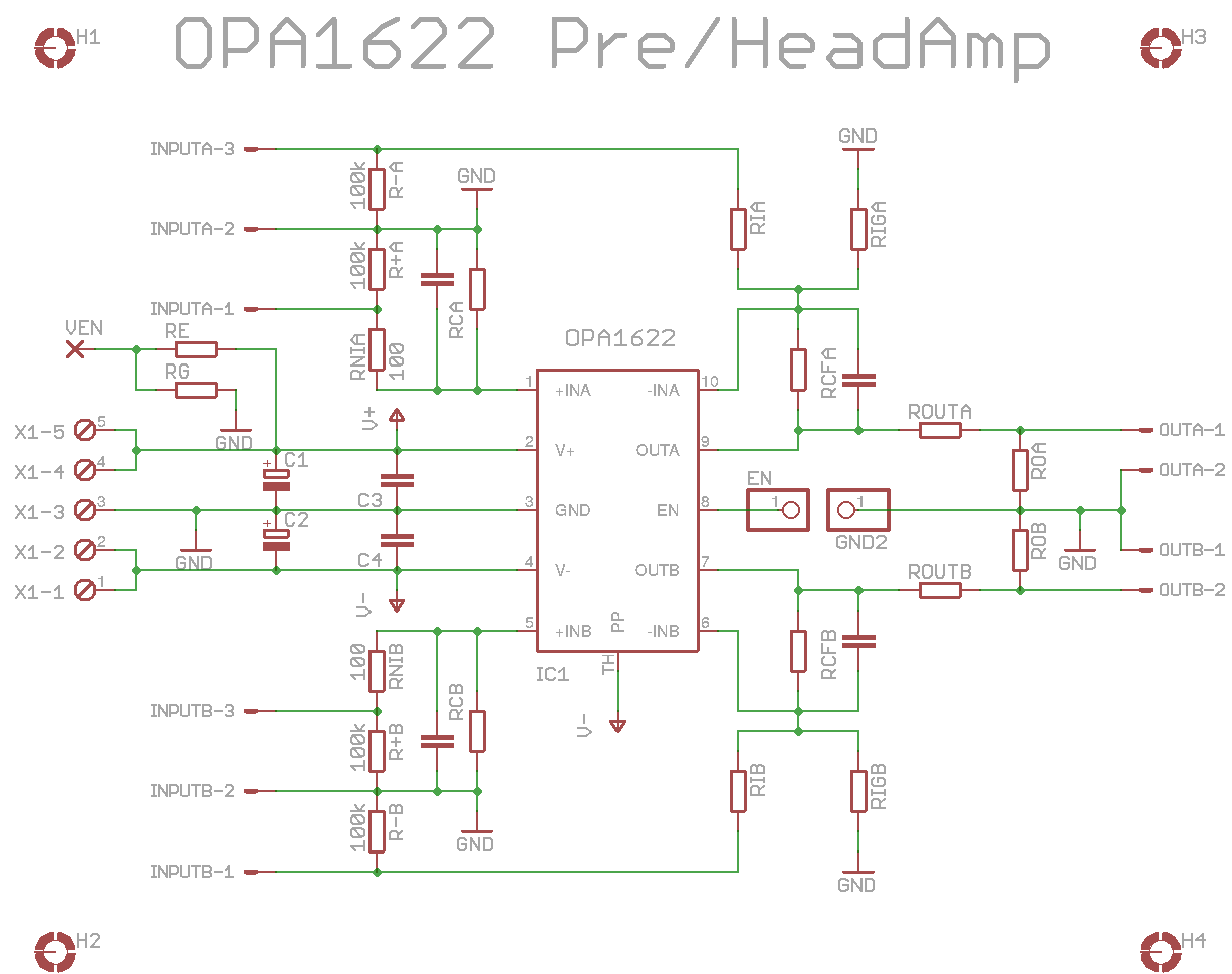

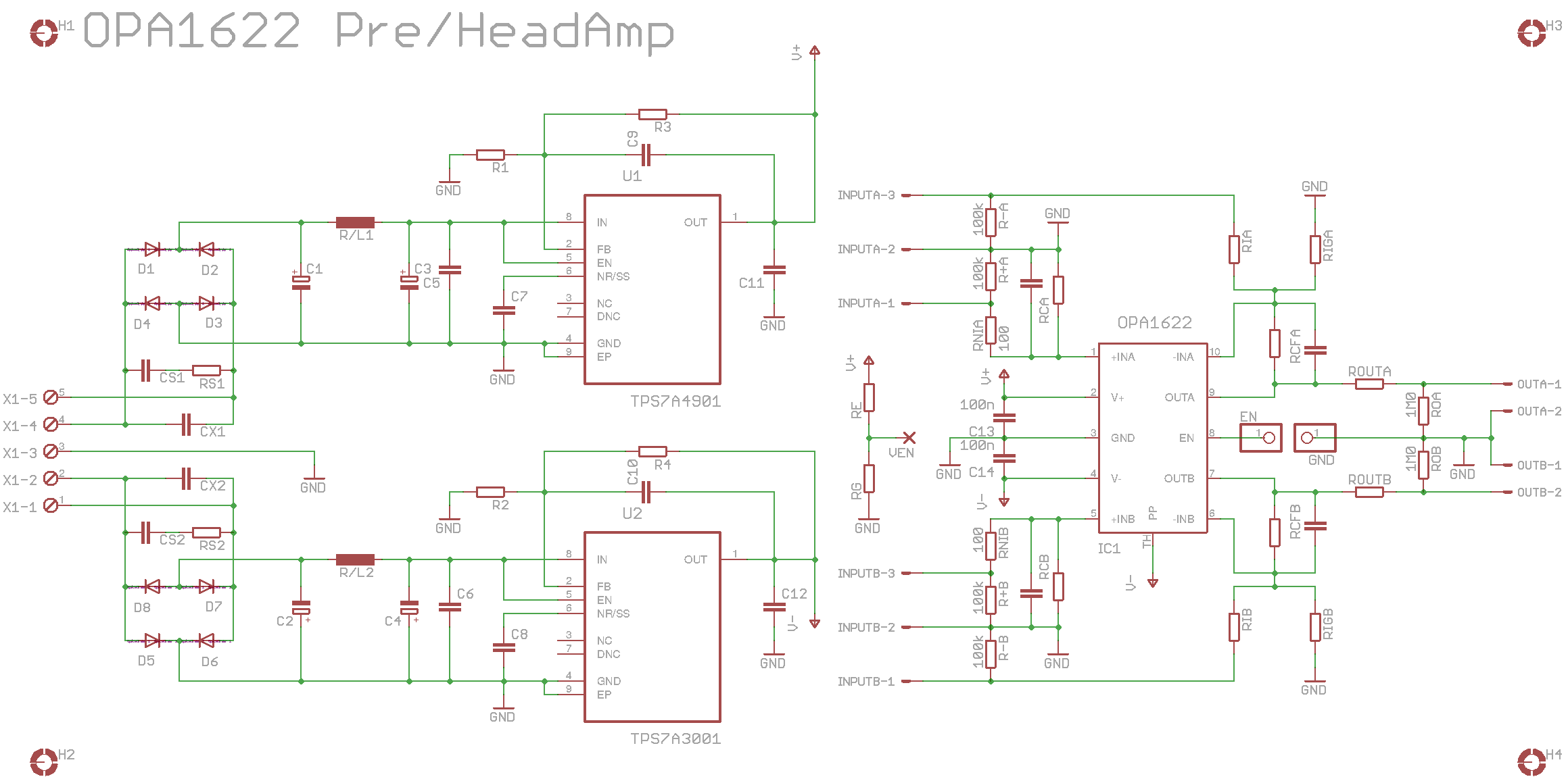

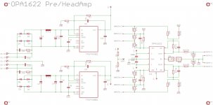

Universal buffer/headamp based on OPA1622
Actual schematics for the boards with and without the PSU.
The thermal pad has to be connected to the most negative supply externally. It should also be soldered to the copper pour for heat sinking. The other pins do not protrude outside of the package but as is typical in electronics all the pins should be soldered to the respective pads on the PCB;)

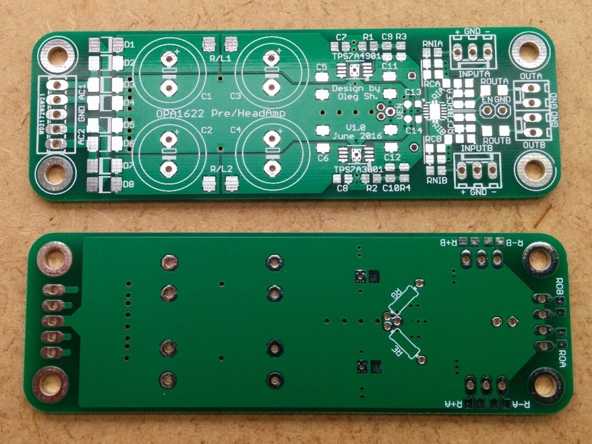

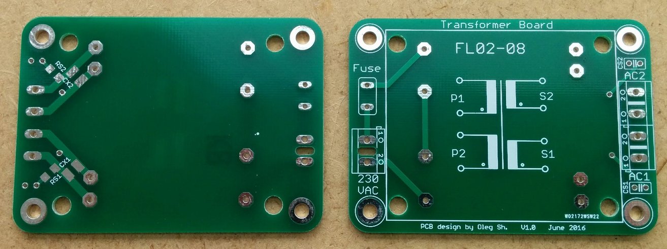

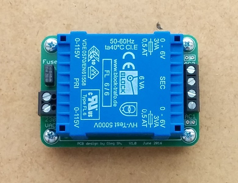

PCBs arrived!
All is fine except there are some traces left from the snubber circuit on the bottom layer of the PCB with PSU (next to the PSU input connector) and there are two exposed GND pads next to the power pads of the regs. Electrically everything is fully OK. Just aesthetics:) The CRC transformer snubber is now on the transformer board.
The other PCBs are all OK.

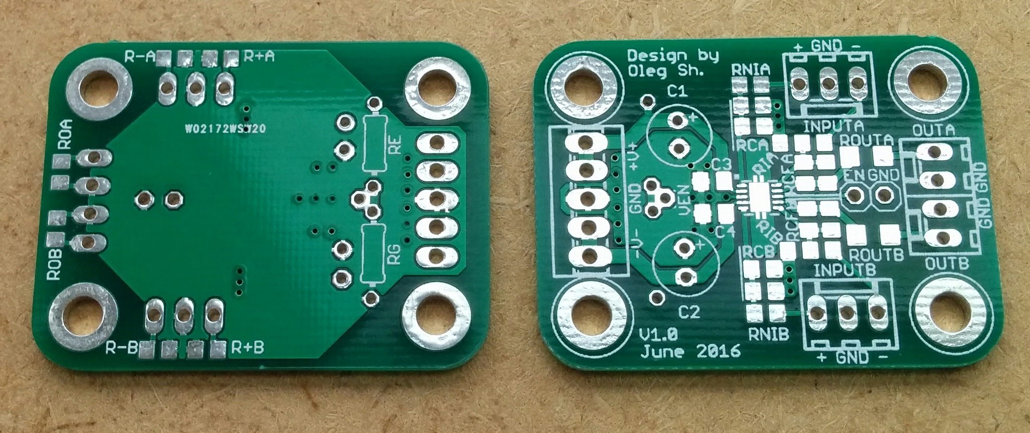

I have also made reduced version of the pre/head amp without the PSU part. This PCB is only 3x4 cm in size. I am going to order both designs with and without the PSU. Most probably I'll get a dozen of each design but I need only fraction of it. So I'm curious if there is interest in such PCBs from forum members?
Oleg
Hey Oleg, I'd definitely be interested in a couple of the reduced boards and 1 of the larger boards. :)

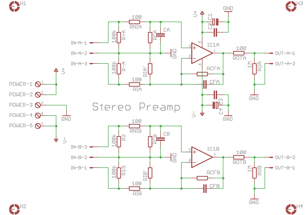

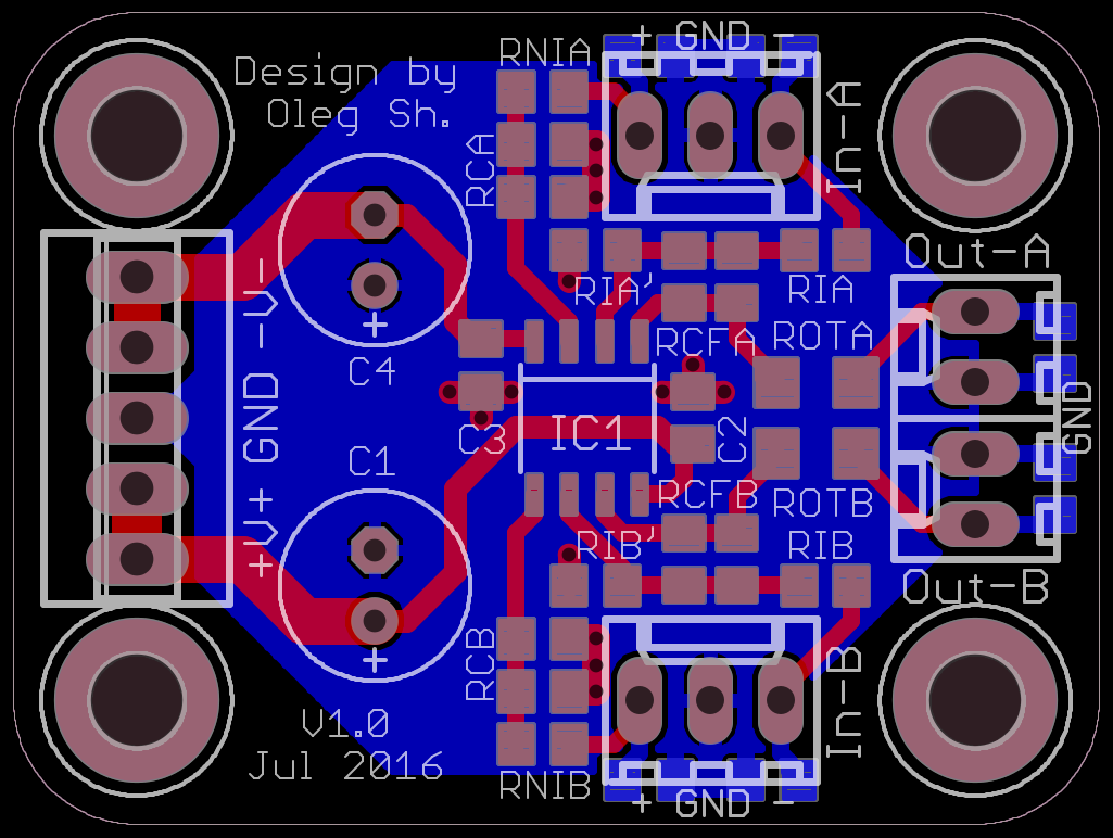

Another PCB design
Have been playing with Eagle CAD... Always wanted to design a small PCB for buffer/preamp based on dual op-amp in SOIC8 package. The preliminary PCB version is attached. Similar to OPA1622 PCBs this one also allows inverting/non-inverting/differential configurations. The PCB is not suitable for automated assembly due to tight spaces between parts but manual assembly using conventional soldering iron should be relatively easy.
Please have a look and let me know if I overlooked something.
Oleg
