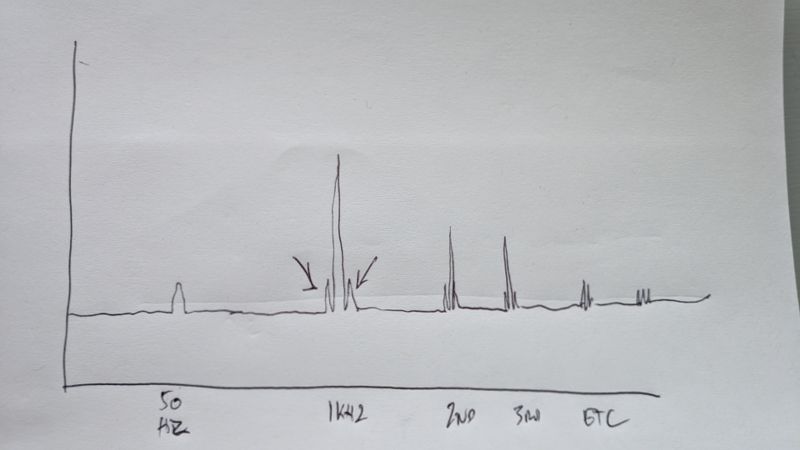

Well, I recently pulled this amp off the shelf to have a listen to it after using some SS amps for a while. I was surprised again at how good it sounded, so I had a bright idea to use my new distortion measuring rig to see what it looked like. This turned out to be a mistake, when I hooked it up and took a look at the spectrum, it wasn't terrible, but also wasn't great. Distortion at 1W in 8R was 0.4% and noise wasn't brilliant either at -50something dB down. A fair chunk of that noise was from 50hz and its harmonics, and also from some sidebands around the 1kHz pilot tone. These looked really odd, spaced perfectly 100Hz either side of the fundamental, and I could see it mirrored on the 2nd and 3rd harmonics.
So I got to reading around a little in between other jobs, and saw a post here saying that 100Hz side bands either side of the fundamental could be related to AC heaters (I think it was @6A3sUMMER) . I had some DC supplies, so I got to thinking about fitting these, and wondering if I could do any better on the B+ I had a built Maida HV module I reckoned I could press into service. Anyway, I got time today to open it up and fit the modules, doing some other tidying up in the amp while I was at it (not that you'd know if you saw it). Anyway, the end of this story is that this had a very positive effect on the noise and also THD. Noise is now down to -67dB, and THD is down a lot to 0.069% on the channel shown. The second channel is a bit higher at 0.11% (all 1W into an 8R "real life" load). You will see that the harmonic profile is more 3rd than 2nd, about twice as much, even if low enough overall.
I used a simple LM317 CCS on the tail of the 2 EL84s, with a balancing pot. I know that I can minimise distortion in total by adjusting that balancing pot but it doesn't much change the ratio of 2nd to 3rd.
My B+ is a bit lower than Broskies original, 300V or so, with the front end about 40V less as per his schematic. I don't want more distortion, but I am curious as to how it would sound if the ratio of 2nd to 3rd were reversed. I've added his schematic here again for ease of reference. In my build I have DC heaters, Maida reg for B+ with an added RC stage for the front end B+, I have a red LED in the cathode of the input 6n1p and the LM317 ccs in the tail of the EL84 instead of the cathode resistor/cap. Also, I have mine wired as ultralinear rather than triode mode as his sch shows.

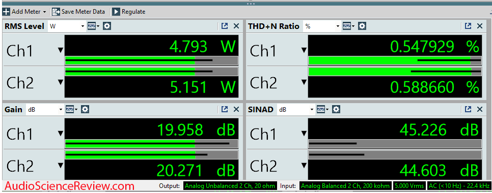

PS - If you look at the couple of tube amp reviews w/ measurements at Audio Science Review, you'll see that yours is comparable to very expensive commercially made tube amps.
Bob Latino modded Dyna Stereo 70 measurements (with NFB applied):

Ok, I hope I haven't mislead anyone or misconstrued what you said. Just when I read it after searching around I thought maybe that could be my issue. Note that it wasn't hum that was my issue so much as THD peaks either side of the fundamental. I'm regretting not taking a screenshot of the before amp tbh. What I've done to (badly) compensate for this is (poorly) draw what it looked like.
Moving on from that, I understand the 2nd harmonic cancellation now having read some more - being able to measure things opens lots of questions! The 6p14p used here are not matched. It is very interesting to see THD go up or down depending on adjustment of the balancing pot before the CCS.

So just to be clear - I no longer have those peaks/intermodulation either side of 1kHz in the hand drawn example above - some combination of moving to DC heaters and Maida reg solved that. I posted that drawing because another poster asked for it above.

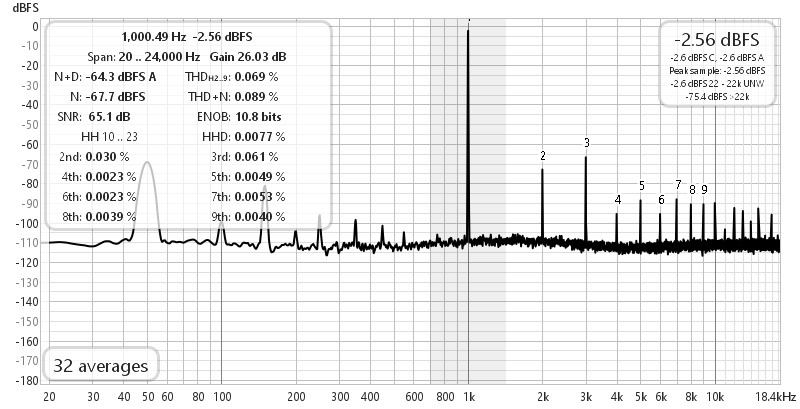

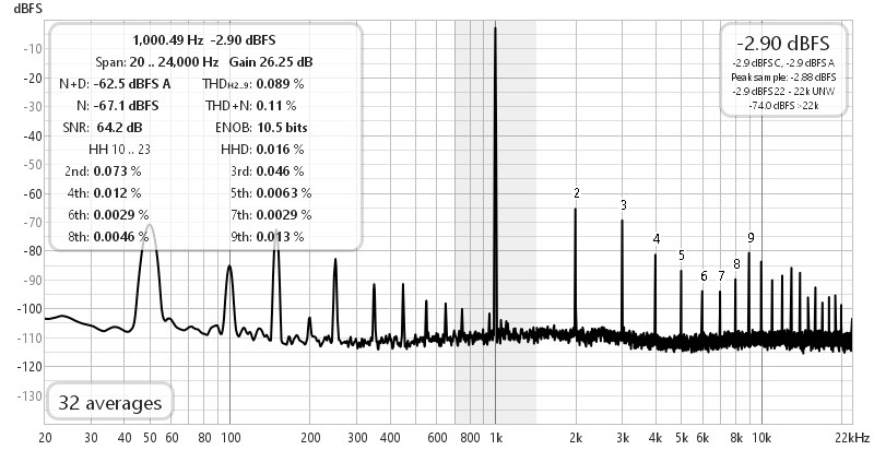

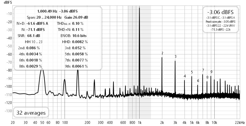

Attached are distortion measurements for each channel and also 19/20khz IMD as well. I'm pretty confident now of my THD measurements, but not so much with the IMD as I have little enough experience. Hopefully I am not incorrect in how I have done it. All measurements taken at 1W into 8R.
So this is Broskie's circuit as linked above, but with DC heater supplies, Maida HV reg for the B+, red LED in the cathode of the first tube, and 80mA LM317 in the tail of the EL84 cathodes. I have an adjustment pot on the cathodes, and using this I have tuned the distortion to give me just a hair more H2 than H3 - which actually means one EL84 runs a bit harder than the other but still well within spec.
