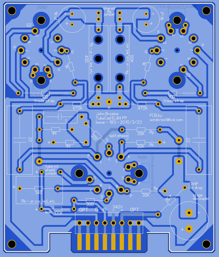

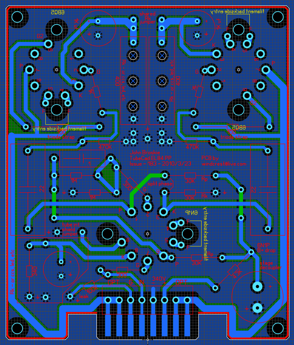

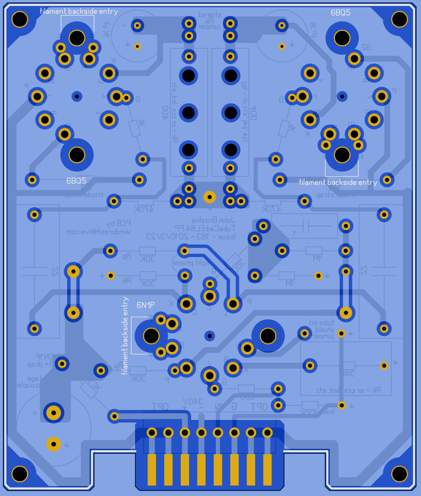

I'm finally putting this project into a chassis, designed a PCB, was hoping for a few random reader pointers before I place the order to China. Specs:
1) It will be dual mono boards so I have more chassis freedom in moving things around.
2) I have a crapload of 8/16 3.96 pitch edge card connectors so the header is 3.96 gold fingers. I like the large amount of surface area edge card connector gives, especially if you double-up both sides or even adjacent pins. But above the gold fingers are holes for a 3.96 screw or Molex harness header if not using the edge card.
3) Nearly all component drills are 1mm nice and roomy, I over sized component lead distances too.
4) I made sure that all standoff mounting holes are at least 2mm away from the ground plane because I wouldn't want a brass standoff to be inadvertently connecting my ground plane to my chassis, I want to ground the board myself via the harness once.
5) The sockets tubes are on the back side, all other components are on the other side.
6) Filament wires will come into each tube from the "tube side" (backside).
7) The incoming RCA jack ground has a dedicated trace to the bottom of the grid leak resistor. I didn't want the RCA shield to be going directly to the ground plane right off the bat, the bottom of the grid leak is the first time the input shield hits the ground plane.
8) I tried to keep grids away from everything else.
9) only 3 traces crossed where they needed to do a hop across the other side of the board (the green ones).
10) In John Broskie's original schematic (first page of this thread) he uses a common Rk. I provided for separate Rk resistors but with a jumper to build it with a common Rk. (btw the common Rk should be 200 ohms I believe not 400, I will use 400R Rk resistors split.).
11) Most board mfg's dont like when you pour copper right to the board edge, so ground planes stop .5mm from the edge. Less chance of delamination too at the board edges.
12) The entire "tube side" is a solid a ground plane with the exception of the 3 traces that had to do a hop across.
13) I tried to keep B+ scooted away from stuff. Filaments go direct to pins, no traces for that, and I positioned the grid wiring to always scoot away from filaments.
14) The "photo" views below show the unmasked solder areas good, the edge fingers will be gold plated.
15) At first I'm going to use this board as a test mule to learn about different ways to do CCS on Rk. So I may install spring clips at the Rk leads so I can plug in different shield boards with led's or LM, or zener cathode lifts, just for learning and listening for differences.
16) Grid stoppers are in close to the tube pins.
17) Full outer profile is 99mm x 116mm
This is one of my first PCB's, hope I didnt make any serious mistakes.
Layout (blue traces are component side green traces are on the "tube side":
Component side "photo" view:
"Tube side" photo view:

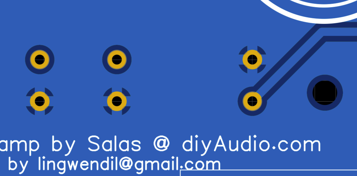

Should use thermal reliefs on the pads to the ground plane.
PCB Thermal Relief Guidelines for Manufacturing - VSE
Thanks, well I just learned something new!
I did have those as thermal pads at first. Now I learn that thermal pads have to do with good soldering, (not with whatever else was clanking around in my brain about what thermal pad was)! Yes I will change those. I can see how hard it would be to try to solder to these flood pads I made, same goes for my big B+ flood pad on the right.
Also I noticed a chunk of stray unattached copper I need to carve that off.

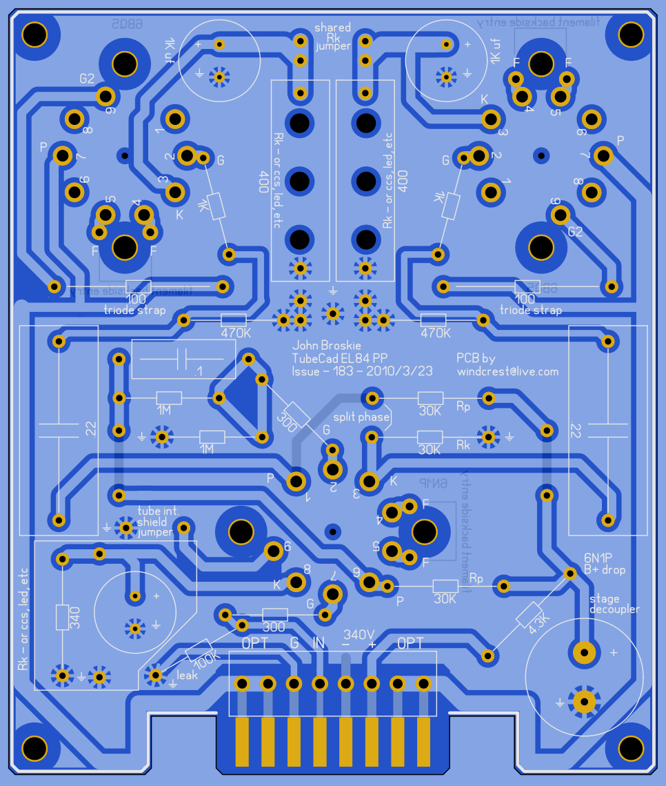

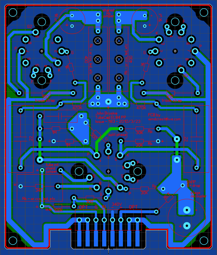

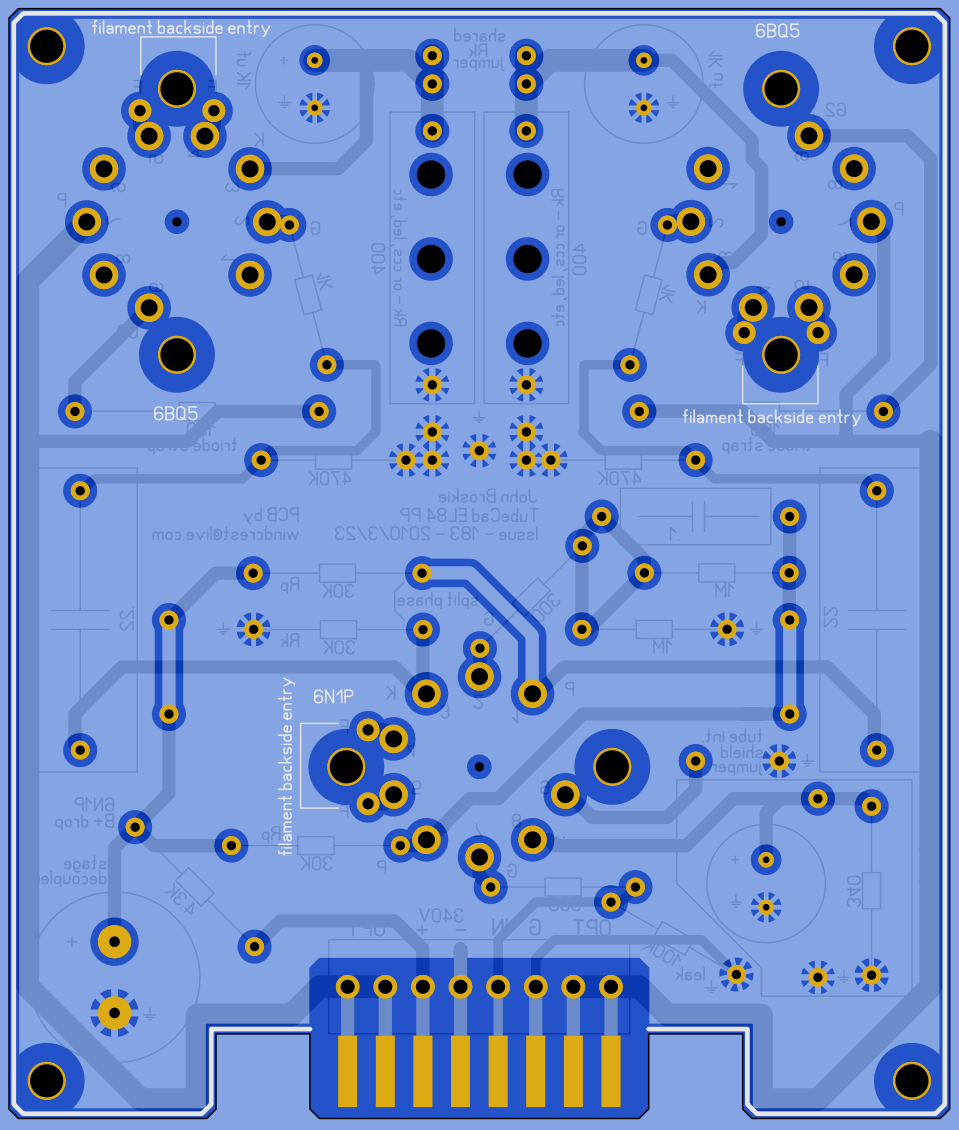

I started doing them a few designs back, it makes it much easier to solder with the typical hobby irons.
Yeah, I can see how the large copper flood would require a lot more heat, and with more heat you run the risk of component damage. I omitted all the large copper planes I had, my traces are big anyway. All trace spacing is .8mm, I added the thermal pads and made a little more room for 6N1P Rk options like using a LMxxx stand up shield board. Broskie didnt call for a Ck on the first tube, but I added space for an optional Ck there.
I have 4 corner holes but in my chassis the whole board will be held in by the tube saddles. I first bolt the socket to the board with a brass standoff screw through bottom. Then I solder the socket. Then I have a way to thread 3mm screw directly into the saddle through the chassis top, with no need to even hold a nut on the other side. You just have to be accurate on chassis hole making but leave some wiggle room. This way the board experiences no flex whatsoever when inserting tubes, its like it was a point to point socket mount.
Design view:
Component side photo view:
Tube side photo view:

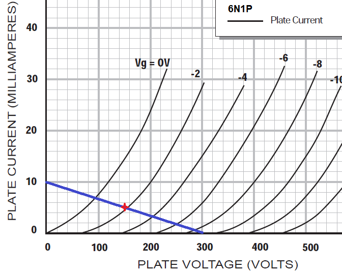

Please look to the first post schematic, there is 6N1P bias point: 150V, -1.7V bias and 340R cathode resistor, but this doesnt make sense. If you look at the curves the tube should conduct about 11mA with 150V and -1.7V. But this translates to cathode resistor of roughly 150 ohms.
Joined 2016
I remember that I operated my 6N1P's with 300V B+ and 330R cathode resistors. Probably the bias voltage was larger than 1.7V --- because in my curent configuration, I have replaced the 330R cathode resistor with a green LED, giving a bias voltage of about 2.2V for balanced operation (~150V first anode).
Regards, Claas
I checked. Broskie got it right. The value of Rk might come out to be 360R or 330R in real life, but 340R is really close.
Ebb = 300V
Rp = 30k
Rk = 340R
Vp = 150V
Vk = 1.7V
Ip = 5mA
See load line attached
