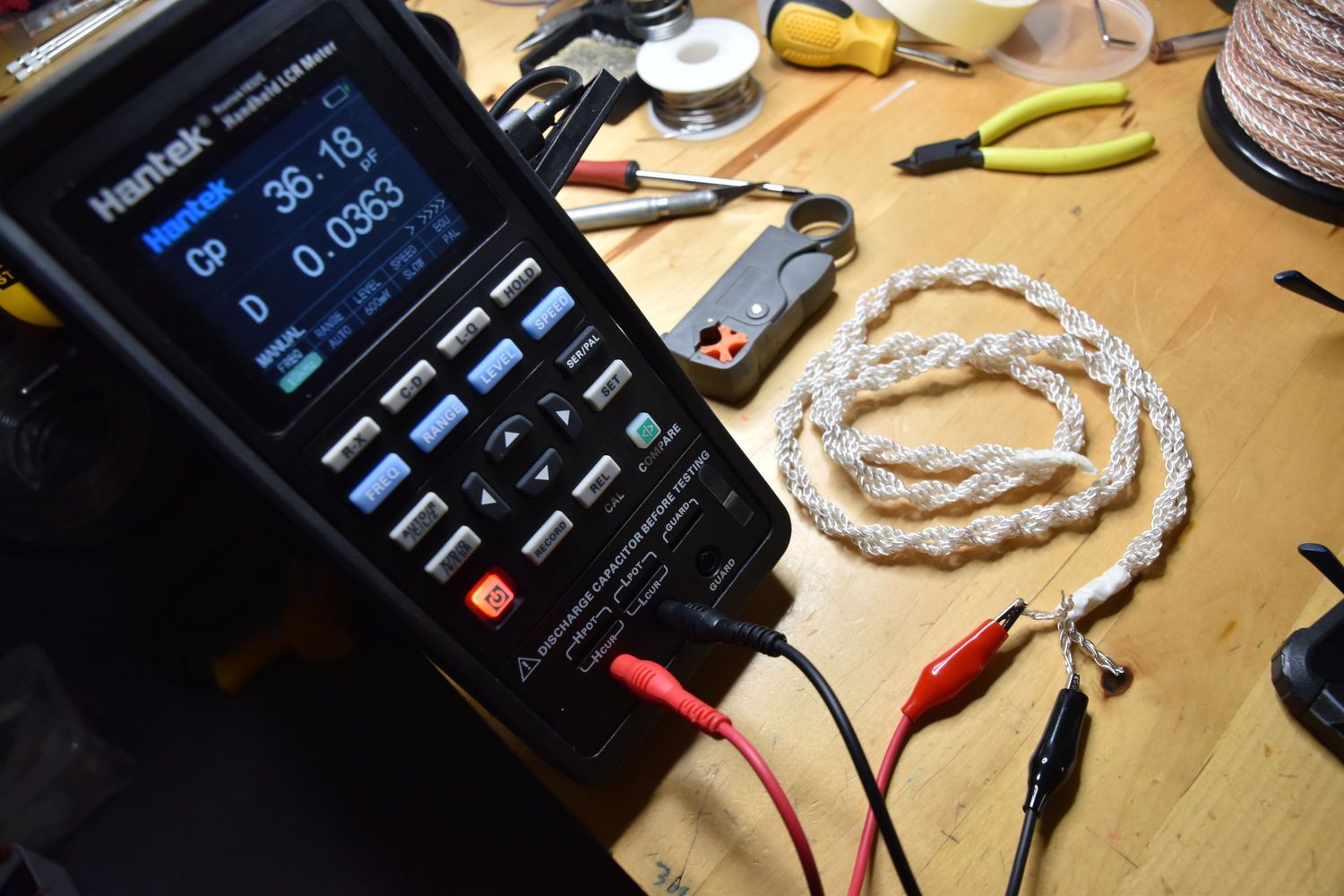

I recently developed a 36pF/m phono cable utilising a 16-core braided conductor geometry.
I'm a firm advocate for the CMRR principle which a braided wire geometry facilitates admirably and which provides a better EMI/RFI shield than any built-in cable shield.
I also observed significant and audible differences between SPC, Cu and hybrid SPC/Cu configurations.
The most important thing to remember with phono cables is that shorter is always better as is the lowest capacitance possible in order to create headroom for the higher frequency range in the rest of the signal path.
DIN connectors also have significantly lower capacitance-loading than RCA connectors but the best connection method is direct-soldering to completely mitigate any capacitance increases.

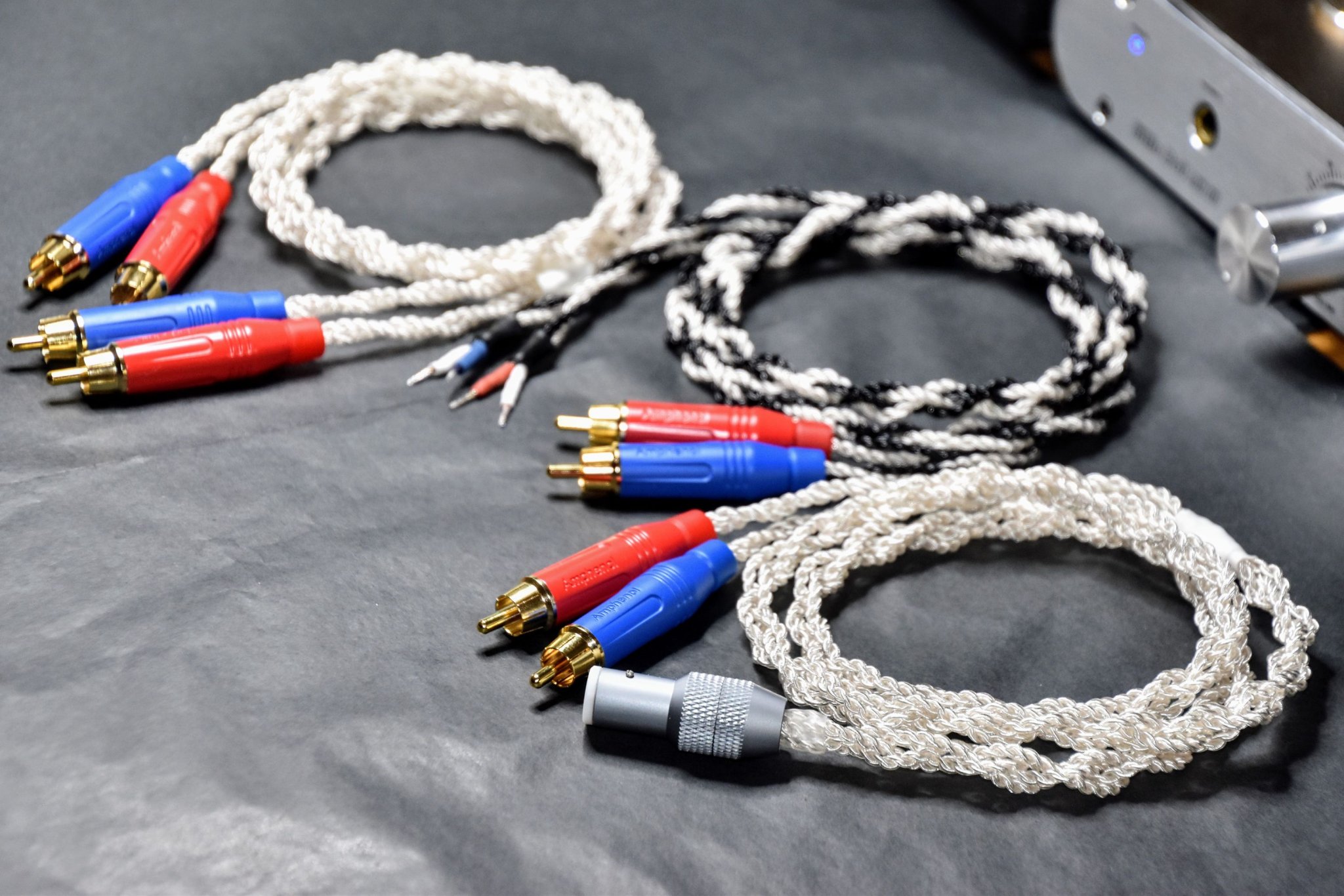

Full SPC braided 16-core

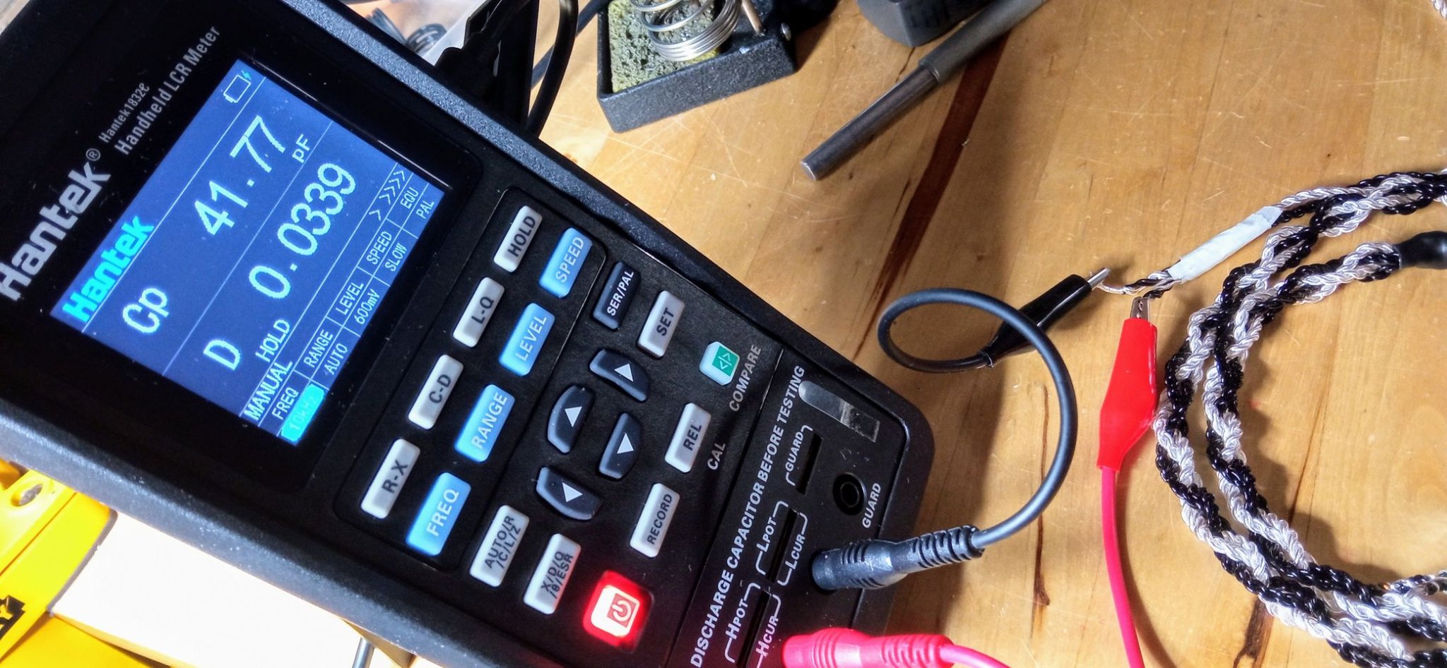

Hybrid SPC/Cu braided 16-core

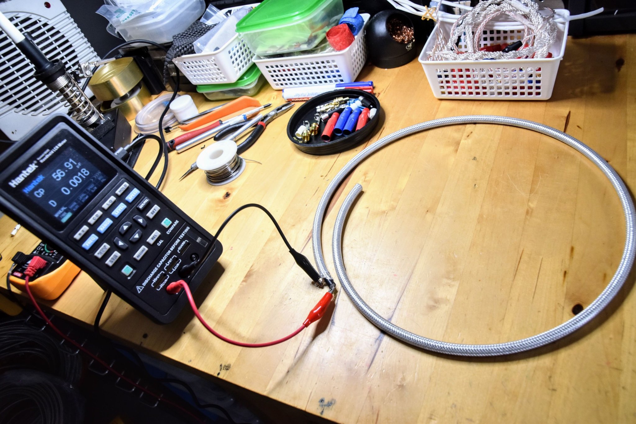

Measuring some vanDamme Silver Series LoCap (55pF/m) cable as a control.
I measured it at 57pF/m but hey, my LCR meter is just a Hantek so who's gonna miss 2pF/m? :D
Use DIN connectors where you can. Even better is directly soldering to TT/amp to terminate the connections ;)

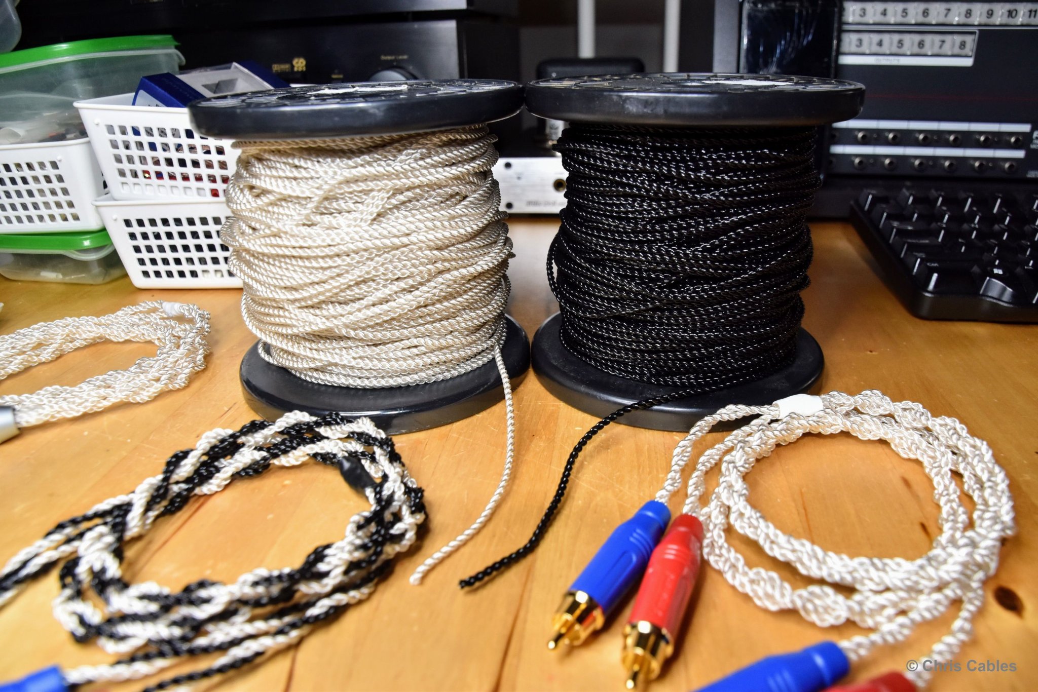

I use 49-strand silver plated ofc copper wire in a 4-core braided configuration and then braid 4 separate lengths to get 16-cores. That's the all-silver coloured cable in the photos as the jacket is transparent PVC.
The 'hybrid' cable I refer to is a 50/50 blend of the SPC wire (2x 4-core lengths) and the same 49-strand configuration but in pure OFC copper (the black strands) and the same 2x 4-core lengths.
It takes a bit of time to braid and prepare as the wire strands are enamelled, so when I have configured them for L/R +/- the individual cores are combined and de-enamelled via solder-dipping.
I started using this configuration for headphone cables initially as it's really supple and flexible and has zero microphonics which is important for headphones ofc.
I started looking for a suitable cable to use in a turntable application and tested about 40 different cable types for the lowest capacitance then realised I hadn't measured the overall capacitance of the braided stuff I was using for headphone cables and discovered it was super-low. It was a nice surprise and I only wish I'd have realised before I acquired and tested the other 40 types!

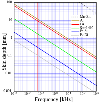

Silver plating has the added effect on stranded cables of avoiding strand-to-strand copper-oxide conduction. The skin effect is also at high audio, but using thinner gauges reduces this. Copper-to-copper oxide was the first semiconductor diode. High audio does not have much energy so the effect is academical.
