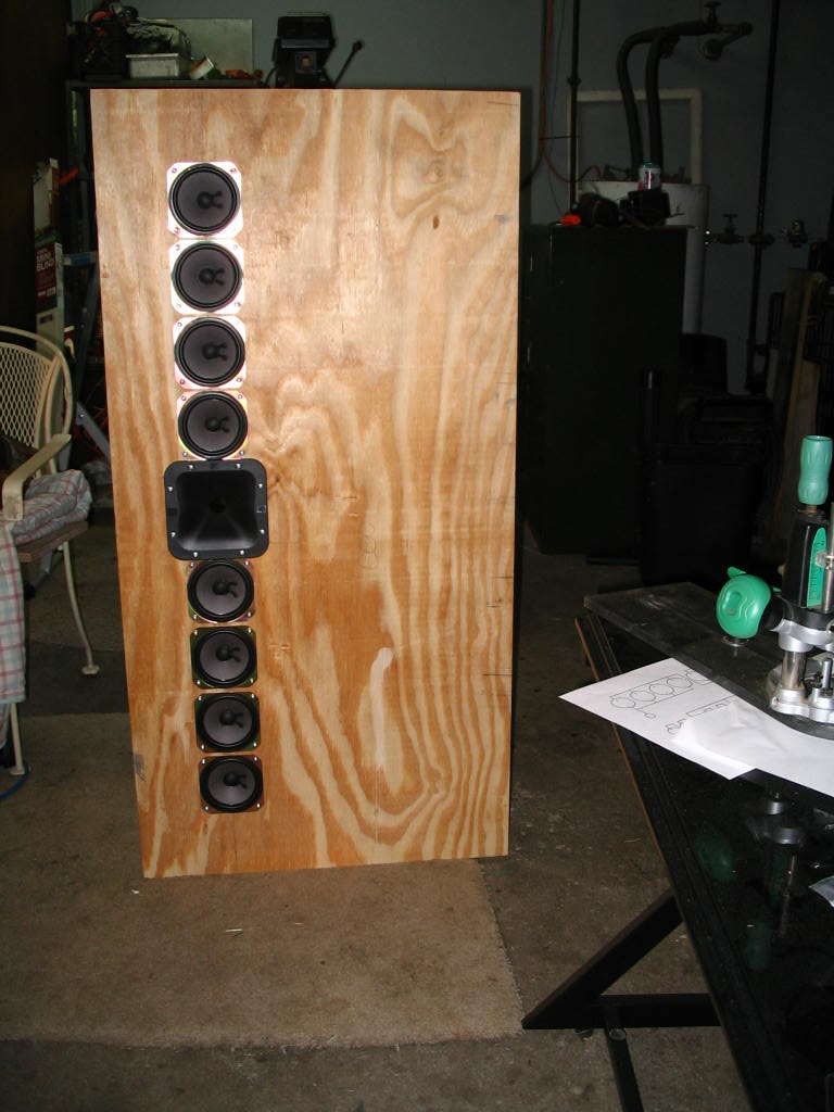

Hey Badman, I am just getting into OB and this is a pic of the project I built this weekend. I used the JBL 6x6 wave guide with the Selenium 210.

Badman, I'll check it out! Thanks.
