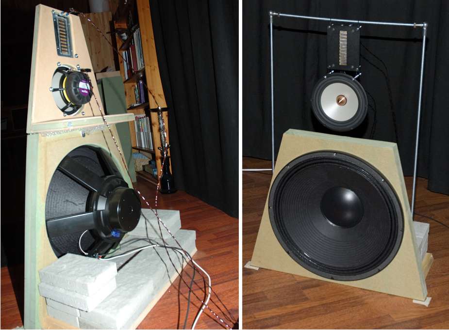

StigErik,
if I remember correctly, you made a jump from a rather large baffle (left) to baffleless and suspended drivers (right). No real small baffles as a step in between. Would you dare to roughly guess how much of the positive change was due to "no more baffle" and how much to the suspension?

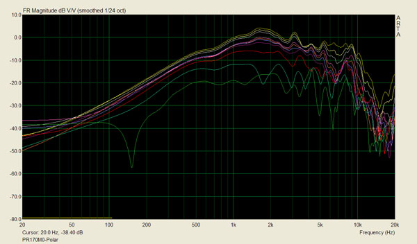

Counting the number of curves in each plot I haven't been able to make sure which curve represents which angle. Would you please clarify?
It's all eyeballed, I don't have a turntable. I'd say, roughly 15 degrees to start with, then getting wider towards the end, and the last one is usually a big step up, and at around 75 degrees.

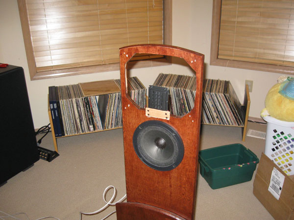

Do you have any pictures of the back of your speakers? I'd like to see how you mounted everything, since my mechanical skills are really poor. For example, it looks like you mounted the Neo3 upside down, and I was wondering why I didn't think of that, that would simplify some of the mounting problems right there :)

StigErik,
Difficult to say for sure... but I'll try. I had three versions of the midrange baffle with the same size. That should account for the improvements gained with decoupling to some degree. The baffles were:
1) Regular MDF baffle as a a part of the woofer baffle
2) A new separate baffle, sand-filled for damping
3) The same as 2), but suspended from the woofer baffle (not a swing, but suspended with several layers of bubble-wrap
The difference between 1) and 2) was huge, no doubt. The difference between 2) and 3) was more subtle, but clearly audible. It was a greater freedom from "grain" and harshness. The sound got cleaner with what some call "darker background" in the soundstage.
Then I moved on to the fully suspended baffle-less thing with the same drivers. There was an improvement, although fairly small.
The greatest gains came from making a separate very dead/damped baffle, and from suspending the baffle.
I had the same experience with my giant twin 21" H-baffle subwoofers. When placed right on the floor they sound resonant and distorted. By just placing bicycle tire tubes under them, they "float" both physically and sonically! The difference is huge.
My conclusion might be that suspending the baffle and/or drivers is maybe the most important part, more important than having a baffle or not.

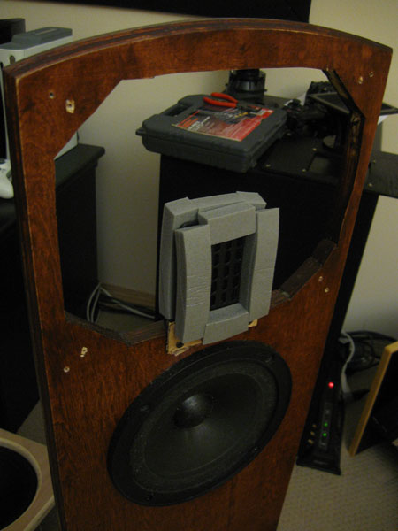

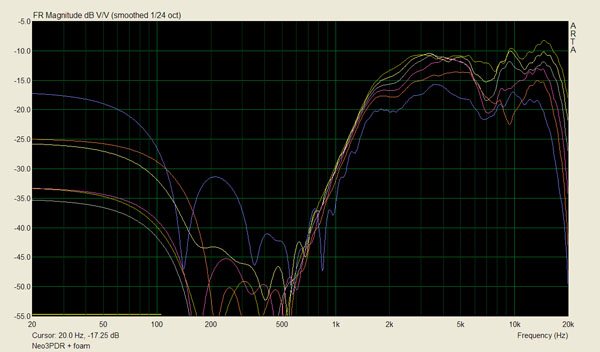

FWIW, I tried putting the wrong kind of foam around the Neo3 (it was a closed cell foam, basically weatherstripping). So it effectively worked as a wider baffle, I think. The on-axis response improved a bit, and the off-axis got worse.
attachment.php
attachment.php
I plan to play around some more with foam, maybe felt, maybe cut slits into round PVC pipes and put them on the edges. Right now, I don't think I can really hear that 7kHz null, so I'm unsure if fixing that by sacrificing the off-axis response is worth it.

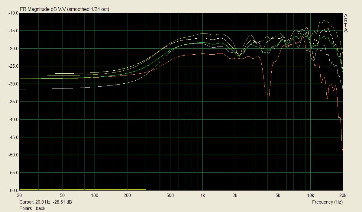

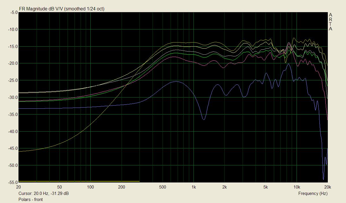

Here are some measurements from tonight. Gated polars, front and back. Green is ARTA's power average. Angles are approximately 15 degrees.
attachment.php
attachment.php
The back is going through that spine, and the tweeter has a .09ms delay to align it on the front, which of course makes it worse on the back (I suspect that's where the 2kHz notch comes from, since that's right around the XO frequency).

The green curve is the power average. The other curves are, top-down 0 degrees up to 90 degrees off-axis.
I missed this somehow. Yes, I mounted the Neo3 upside-down.
