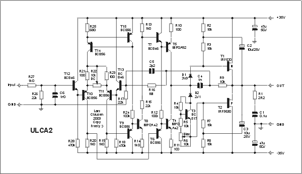

Still working to optimize my low cost design, actually now i am down to only 4$ in parts including the price for a small PCB.
The specs of this new design are:
50W in 8 Ohms
100W in 4 Ohms
DC - 100.000 Hz (new feature).
Higher efficiency.
15 - 40V supply range plus and minus.
Approximately 1 by 1 inch. Will post schematics soon ...
If there is any interest, i will make a PCB layout and post it here for everyone to use.
Which format should a layout like this be published in?

Hi Lars,
I would be interested in a PCB layout .. But how are you gonna get the pars for just 4$ .. just one IRF540 cost more than that, or is my supplier way toooo expensive? I'l take a look at digikey. The SMD parts is OK.. it alloys the PCB to be small, allthough my looking electronic shop doesn't carry any SMD parts. Maybe digikey does..

I think to keep the price down, it would be beneficial if somebody made a component kit. This way you can save the hazzle of going from store to store finduing the right parts, and also get a good quantum discount.
If no factory assembly work is required it can be put together for around 4 $.
An IRF540 is no longer used, but a IRF530N cost just around 50 c in quantities. The counterpart IRF 9530 (without the N) cost also 50 c.
I've checked digikey and the sell both the IRF540 and IRF530 (and both their Pchannel counter parts) .. the IRF530 in SMD package is only 0.55$ .. not bad... but this package can't dissipate alot of heat I'm afriad... so we have to stick to TO-220?
They are a little more expensive at digikey: about 1$....

1 x 1" Cool but is there any room for a descent driver? Power transistors?Lars Clausen said:Still working to optimize my low cost design, actually now i am down to only 4$ in parts including the price for a small PCB.
50W in 8 Ohms
100W in 4 Ohms
Higher efficiency.
Can you DIY mount SMD parts or is this a nono?
Pdf and Gerber is good.
SOT23 and 0805 is the limit for most people I think.
Still, I think you should consider what resistors, transistors cost compared to possible performance. These parts are cheap, no need to make it too simple (bad).
I'm interested in what you can come up with.
I think it's smart that you have these files at your/some website which you have control over. Upload here to a post isn't so flexible

Small is nice but I feel sometimes that things get to be too small. I prefer if the board is big enough for mounting holes and connection points that are not spaced 0.1 mm apart. If one could get a board that is a bit bigger than 1" by 1" say 1.5" by 2" then it would be a breeze to fasten say 8 pieces of that in a box and make a really nice and clean install without risking to ruin every board by cable force.
So here is the (not-yet-optimised) PCB for the ULCA.
Only 1206 size SMD's are used, for ease of assembly, so the PCB measures 44 by 44 mm (1.7 by 1.7 inch).
As you may be able to see i have modified a number of features in this amp, and added some more small signal transistors to improve performance. (As they are not so expensive anyway).
The price can still be kept as low as 4-5$ including the PCB.
Just to recap, it is not a product of me or my company, just a proposal for a fun DIY project. Anyone can make and sell these PCB's as they wish, and i will also post Gerber files after a little cosmetics work. And of course the new schematic.

Updated Schematic
You can download a better graphic version here:
http://www.lcaudio.dk/ulca2.gif
Copy freely, comment, modify, and most importantly: Have fun!

would the cost be lower if you simplify the schematics a little?

Hi lars!, are you not afraid of signal modulation of T15 through R24?
Also i think you are running the emitterfollowers a bit low in current. I think you will gain a little (phase margin) by raising the current through them. But thats my opinion.
