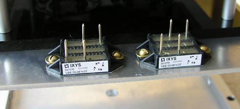

If there is big enough demand for those rectifiers boards, maybe it would be more cost (and space) efficient to go with those IXYS bridges? They are much easier to mount and don't require all that additional hardware (boards, heatsinks, lugs etc)? Just a suggestion
I believe I paid $15/pc in qty of 10.
fast bridges for D3

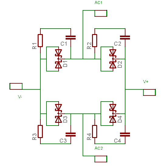

Hi, yes these boards are designed for devices in the TO-247 package, wich contain two diodes per package (the diodes have just been paralleled here). I was initialy thiniking of using BYW99W-200's but almost any other typ that will fit in shold work (even if the cathode and andodes were switched I think you should still be bale to get something out of it, but the markings on the board would be wrong then.
Here I go again. Doesn't the TO247 package have 2 legs in common? I plan to use the TO220 MUR1560. I'm thinking it should fit into two of the three holes for the TO247. Is this correct? Could you post the trace layout?bigparsnip said:
Hi, yes you could use two legged TO-220 diodes like the MUR1520's in the board, but you would need to match the legs up to the correct holes and possibly bend the leads back slightly if you wanted to connect to the onboard heatsinks.
I had never considered that this would be possible when I was designing the board, but when I go back to doing the PCB layout (again ) later today , I will try and figure out something to make this a bit easier to do (probably just mark on the silkscreen which way round the diodes go in the package or something).

By the way, the picture in post 25 is the track layout, it shows the top (red) and bottom (blue) copper layers for the board, as well as the silkscreen on the top part of the pic. If people want me to post the scematic as well, so that you can see what is going on I can easily do that too.

The basic Schematic is also shown below, not exactly great fun to look at, but it should give you some idea as to what is going on on the board:
