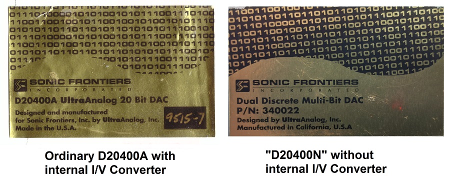

Not a good Idea for DIY, since you then need to design an external I/V-Deglitcher instead of an ordinary I/V.
The hybrid topology of the D20400A (adding different MSB/LSB DACs of different settling speed together) calls for a Deglitcher, otherwise it will sound very very ugly.
Please find enclosed pictures of the labels of the two versions.
The older one (Non A) uses slower and noisier Operational Amplifiers inside.
I would use it at 192 kHz NOS/ ASRC instead of 384 kHz, which gives it a little more margin to internally settle before the hold signal goes down.
If your sample rate converter allows to setup dithering, you should set it to 20bit. In this case you can listen to any hires material without any significant loss in resolution.

D20400 vs. D20400A
I need to correct a comment, I provided here. I stated the following:
- D20400 is inferior to D20400A and uses slower Operational Amplifiers, which seems to be ENTIRELY WRONG
This was based on measurements and listening tests with a stock Audio Synthesis DSM DAC using a D20400 (Non A), a DF1700P Filter and CS8412 receiver and obviously wrong information/translation regarding AD825 and AD844 OPAs retrieved from Russian websites.
Obviously in the DSM DAC the sound quality was entirely dominated by the missing 20bit dither of the filter and the fact that no highres material could be used without heavy loss in sound quality.
In meantime I was able to exchange the DF1700P by a SM5847, configured for 4xFs and 20 bit dither and the CS8412 by a CS8414. This turned the DSM DAC into a completely different beast, because it now supported 24/96 material.
I also recently acquired two unused STAX branded D20400 (numbered) modules from 1989 and put one of them into the DSM DAC.
This little DAC using Reference Recording's HRX disc material now more or less blasted away every other DAC (Including the two Lavrys, the SFD-2, the DAC-1, a PCM63-K to D20400 Adapter in the DSM, PCM1704 in the Naim DAC and indeed the "super duper"-ESS), except the AK4499 DAC, which is on par with little more resolution but little less detailed sound stage.
I then inserted the two STAX D20400 into my SFD-2 (Replacing two D20400A) and got a significant improvement in measurement performance (DNL related measurements) and little better sound quality as well.
Regarding DNL measurements, the Stax D20400 provided close to 20bit DNL, other (used) D20400 modules about 19bit and the D20400A modules I have at hand are around 18bit, which is still very good, if you consider that all my PCM63-K (Japan and Korea) chips only provided 15..16bit DNL and even the PCM1704-K only shows a rather mediocre 16bit, which is the very same as a TDA1541A-S1.
Related to these measurements and also listening tests, I can state the following:
New Old Stock D20400 DAC modules meet their specified perfromance (still after 30 years !!) and seem to be superior to D20400A, PCM63-K and PCM1704-K
This being said, D20400A seems to be a cheaper, stripped down, mass producible "Lite" OEM version of the D20400 and the STAX D20400 could be a hand picked, numbered version of the standard D20400, but who knows ...
Does anybody have an original (OEM) D20400A datasheet to compare it to the D20400 datasheet, which is available here ?
