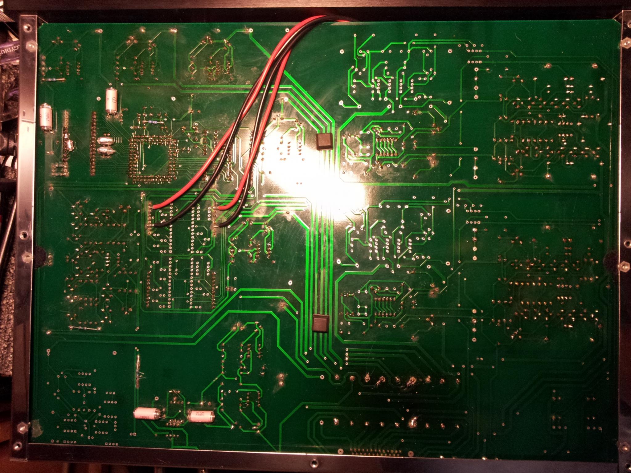

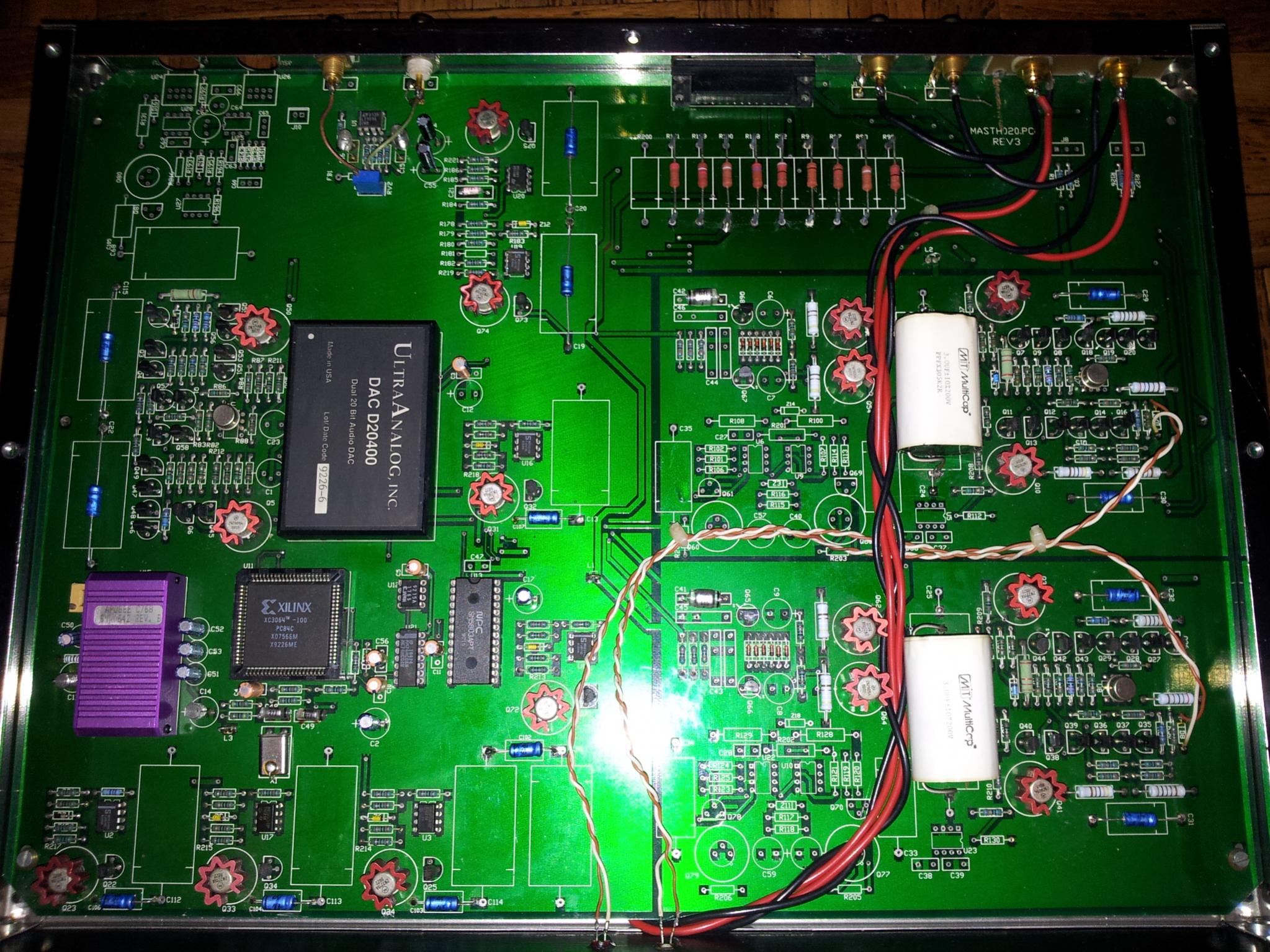

Hello at all
I have just a question :
i open my second hand Metaxas MASDAC III rev3 and i see that the UltraAnalog 20400 ( UA D20400) module is directly connected to 2 news RCA outputs.
(Original RCA outputs don't work.)
Sound very good and transparent...
but does I need at minimum any good capacitor in serie on each positive red wire to protect Preamp and amp ?
Please what do you think of that ?
Your advices ?
Thanks in advance for answer
Phil

It depends what your preamp has on it's inputs perhaps? Many pre-amps do have capacitors on inputs to block DC anyway so they are not necessary on the output of the DAC .
Maybe, as it is connected directly to the DAC, there is less chance of DC on the output through a fault than if it were connected to an output stage? I'm not qualified to give you proper info on that though, only come up with the idea
Then again, try putting some good caps on the outputs and try to tell the difference - some would say that you can't.
This dac has a build in op amp with full scale v-out
Of 5 volts but the current is so small only 1ma. This
would require a very hi input impedance of the preamp
side & it will also be very cable sensitive. Ideal is to add
a buffer which when done properly will add better
performance

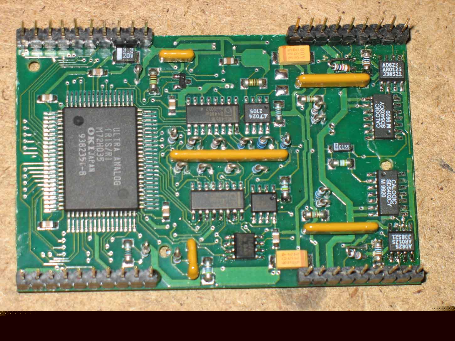

"This is the Ultra Analog DAC hybrid module, and I've looked at what the case actually contains.
The main part of the module is a MCU chip M72H035 manufactured by OKI (Japan), and an AD844 (2kV / us, 60MHz) operational amplifier works on the analogue output stages."
Where is to find a datasheet from the M72H035 ?

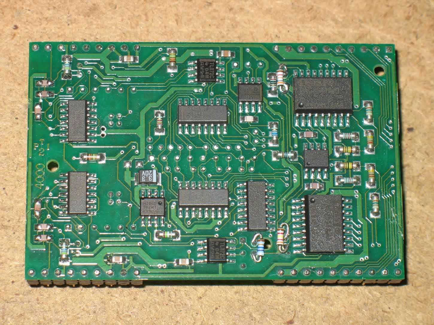

D20400 clone with genuine Parts
there seem to be real replicas of D20400, because according to the attached images there are no potting residues on both PCB sides.
Thus there are also actually be a circuit diagram present.
I think it is one that has had the potting removed - can see the odd scratch and some chipping to some edges. Depends how much the potting sticks I guess.
