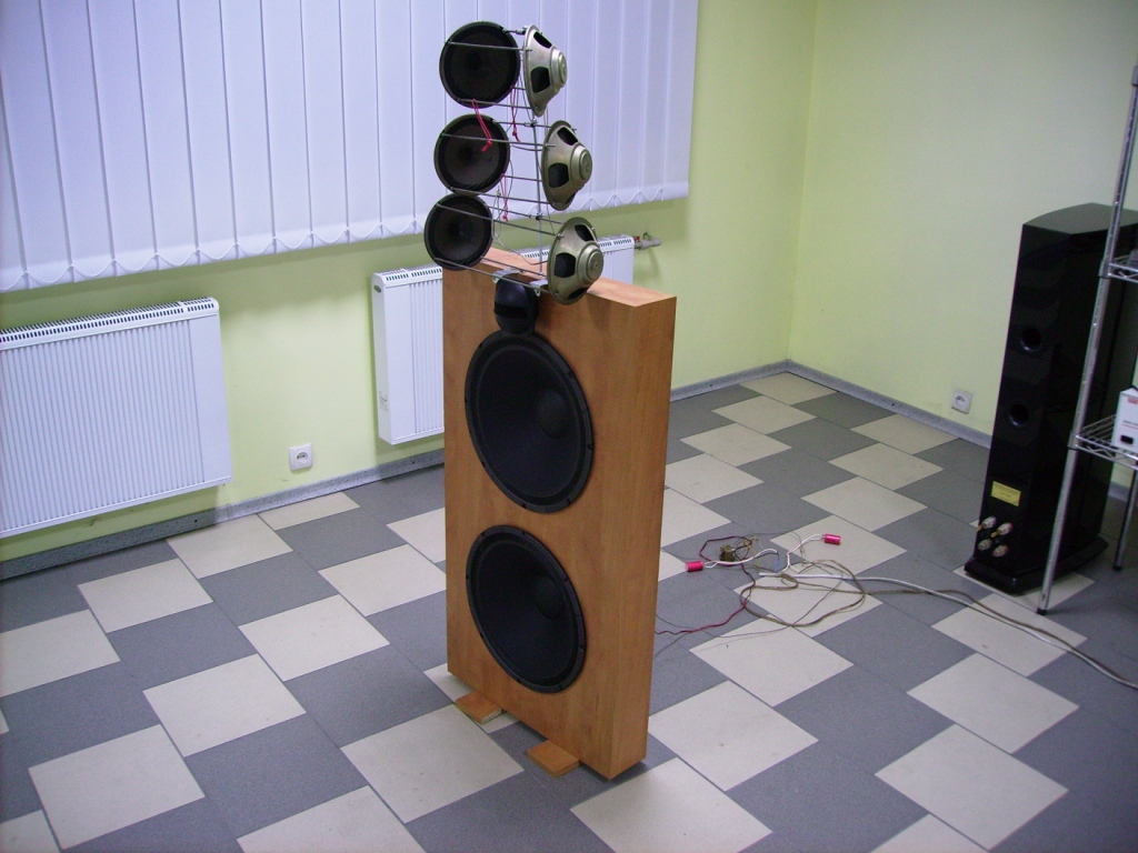

Some sundae work shopping- quick & dirty proto on the making.
Second woofer is faced downwards in the base of the baffle, not yet mounted on the pic.
Fourth driver in the baffle is -to say- back-firing.
4th order line level analogue@80hz for full ranges. Woofers double amped, monopole+dipole combo with some corrections, digital line level XO.

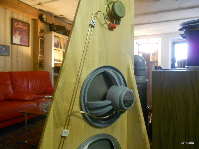

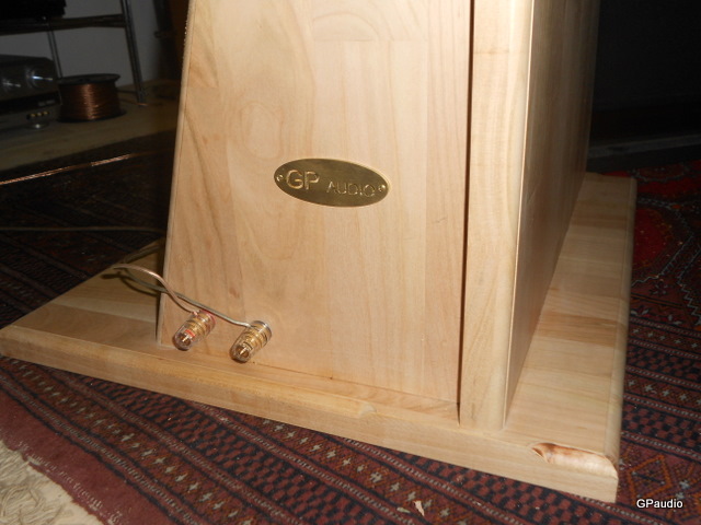

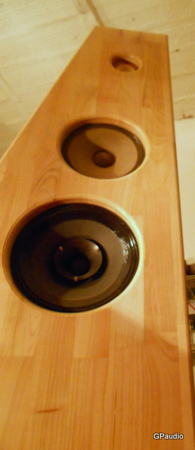

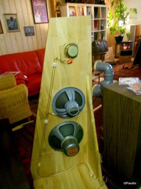

just finished these..
in cherry wood.
only a cap in the tweeter line to protect it, the bass and mid are wired parallel.
they're both 16 ohms.
This one uses a Goodmans Axiom 112, a Goodmans Axiom 300 and a Fostex 103 tweeter
the sound.. just amazing
