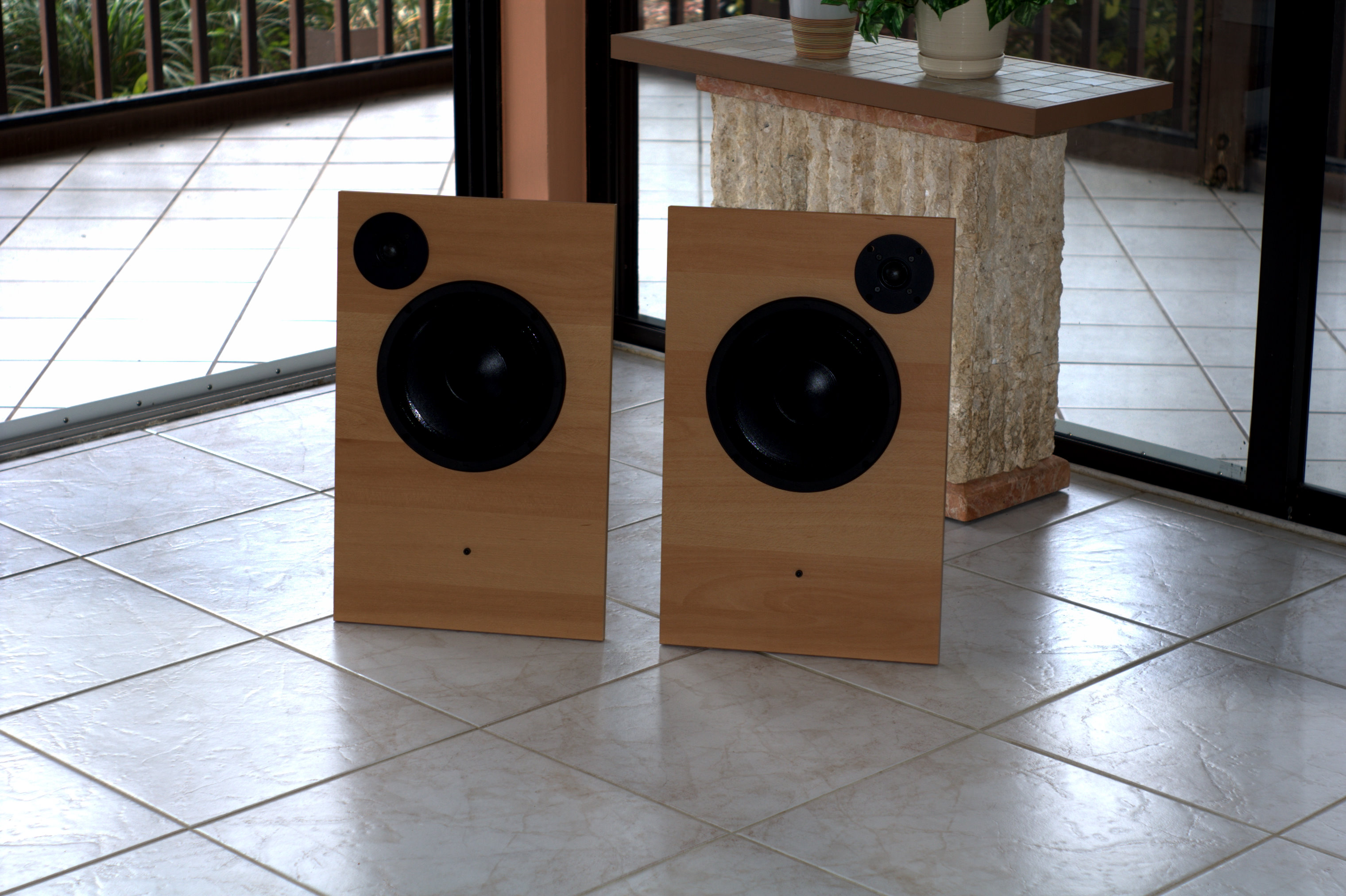

The Scamp: An Alternate Approach to Passive OB Compensation
The "Scamp" is an all passive two-way design featuring a 10" B&C 10NW64 Neo woofer and an offset Usher 9950-20 tweeter. Crossed at 2000 Hz and 1800 Hz respectively, LR-2, The slight overlap is an intended part of the design.
Unique to this design is a variable rheostat which is shunted at the woofer’s terminals and adds adjustable resistance to the crossover circuit as well as the load the amplifier sees. This affects the lowpass characteristics and effectively scoops-out the midrange in a manner that can be dialed-in by the listener. In the design, it is an effective way to compensate for dipole roll-off since there is an additional 8dB of SPL headroom produced by the LF driver compared to that of the tweeter. Keeping resistance at the 2 primary legs of the potentiometer between 8 and 30 ohms, will result in a total load of 4-6 ohms per side, which should be safe for many SS amps. Dialing in additional resistance settings will fine tune the LF crossover point somewhere between ~1000Hz @ 4 ohms and ~1800Hz at 30 ohms with an infinite range of points in between. In my environment, a final resistance setting of 18 ohms produced the flattest on-axis in-room measurements and yielded a total load of 5.6 ohms per side that the amplifier sees. Once determined, an additional 2dB reduction of the tweeter level was needed, also provided by a variable l-pad pot.
To tune the Scamp one simply alternates between dialing-in a crossover point, then tweeter attenuation, in that order for an infinite array of points within the intended range of this design. I suppose the rheostats can ultimately be replaced by two fixed l-pad combinations (series and parallel resistors) once a proper balance is determined, resulting in a fixed version of this design... but I enjoy the flexibility as well as the ability to demonstrate the design concept on-the-fly.
Baffle size is a mere 15" x 24" which most spaces can accommodate easily. The LF driver is centered 14" from the bottom and the tweeters are offset in mirror images, with each center falling 3" down and 3" in from their respective sides. There is an adjustable foot on the rear which allows tilting the baffle back to help align the drivers acoustic centers.
My Scamp is driven by a single NAD 30 watt integrated amplifier. The LF output is both satisfying and clear, and does not strain at higher volumes.

Absolutely dynamite, matevana. I remember being quite interested in the OBs in your avatar, but this one is right up my alley. You certainly think a few things through...
Care to post a parts list, or a total cost? More pics?

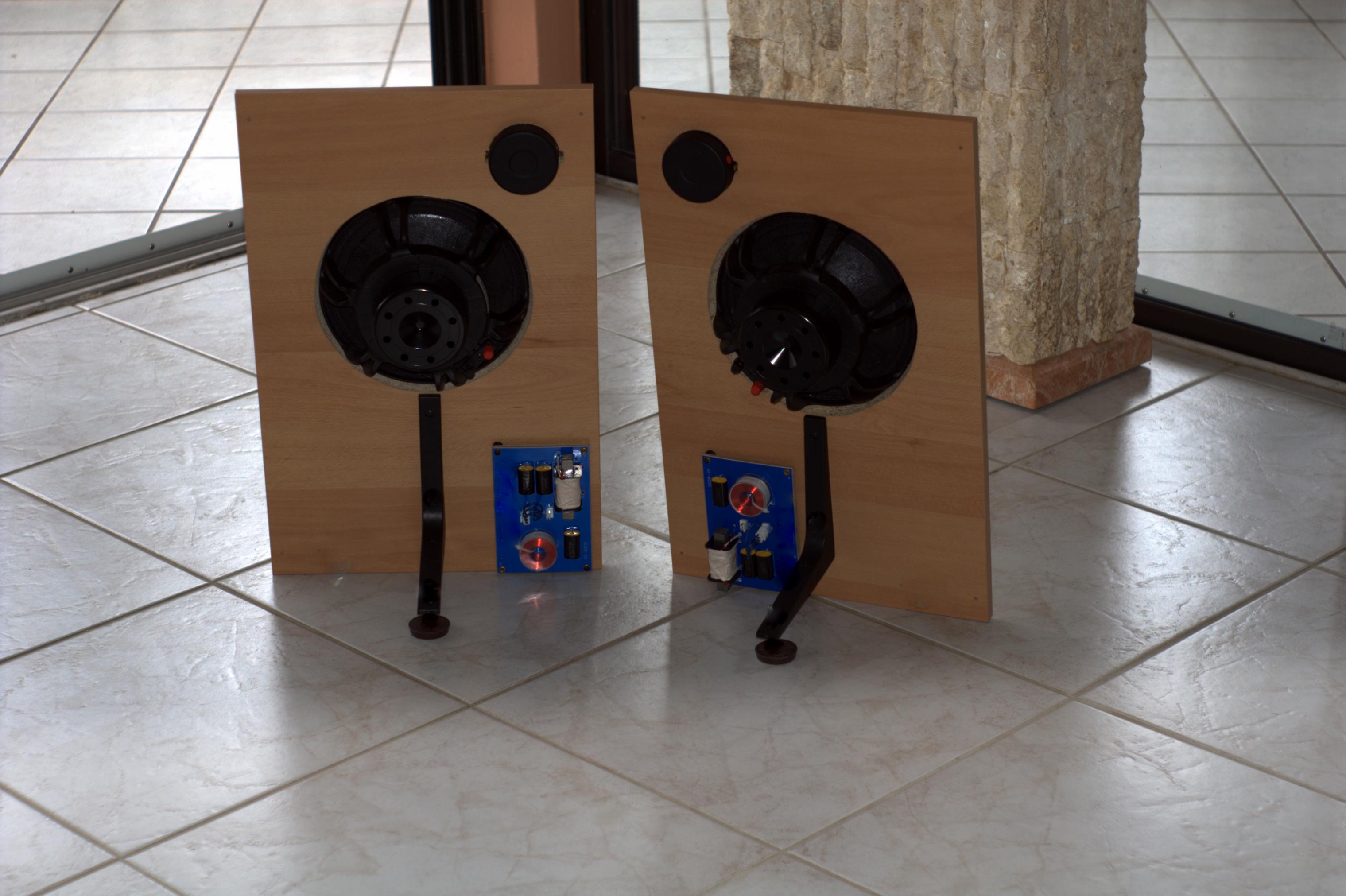

Thanks Fwater! Here's a pic of the backs showing the assembled crossovers. The woofers are slightly pricey, but you do get what you pay for. There's a guy on eBay who has good deals on new B&C drivers, so I was able to pick up a pair of the 10NW64's for just under 300 bucks with shipping. The Usher 9950 go on sale at Parts Express periodically for $39 ea. They are great drivers as well. There are also a few other B&C 10" woofers with slightly less excursion at a lower cost. They would probably work if you're not trying to hit concert levels.
The crossover components are all pretty standard, and no one item is all that expensive. The inductors are air core and the caps are metallized polypropylene, again pretty typical. If I have time, I'll draw the schematic and post it. Depending on how thrifty you are, you can build a pair with drivers, baffles and crossovers for around $450.
