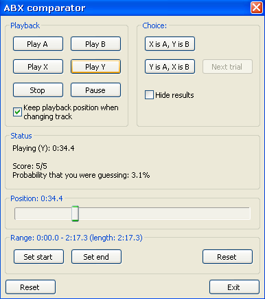

I am pretty sure he has not "figured it out". It is impossible for him/anyone to figure out what was tested.
Hahaha. After my previous post, you still doubt it? Good. Please listen when later I explain why you are wrong. 44967
