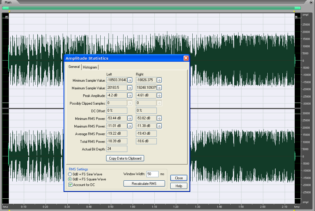

With 2 files recorded through the same chain, just 5 days between the 2 recordings, Diffmaker is able to make a great job (even though the files are not sampled simultaneously), resulting in no audible sound. So this is my 'repeatability'.

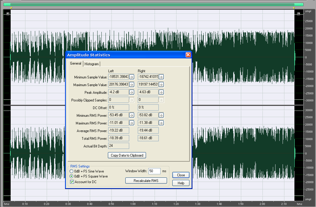

(Remark, this spectrum has nothing in common with the 'orange' and 'kiwi' sound files).
The DAC and ADC are on the same master clock, right? I think this is the key to repeatability and good diffs.

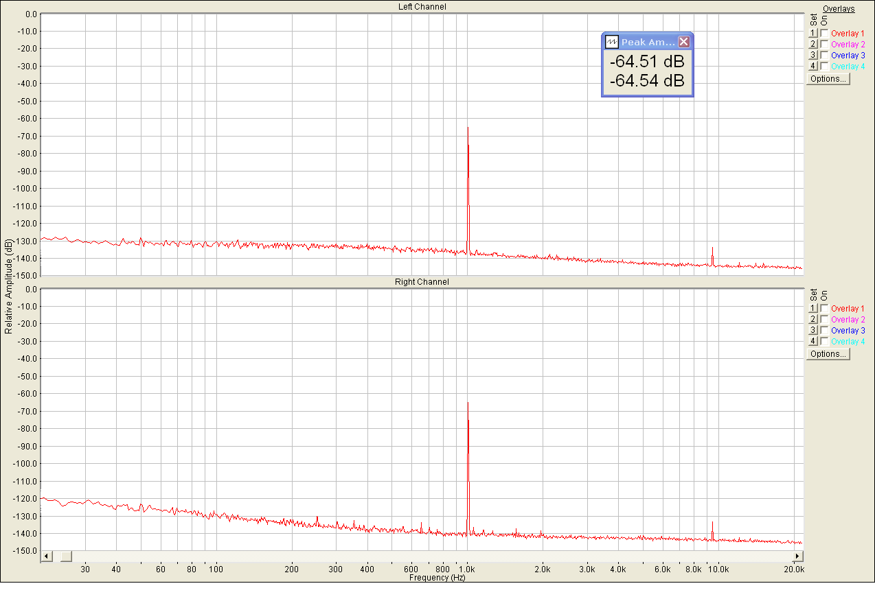

OK, enough. There is a -65dBFS signal at 1kHz in orange and kiwi files. Once recorded through 'blue' chain, second through 'green' chain. The channels in kiwi are swapped. In both 'orange' and 'kiwi' you must quite clearly hear the low level 1kHz tone, otherwise the system resolution is insufficient or total 20kHz band noise too high.

That is OK. Orange and kiwi are both D/A - A/D, so analog noise is added. But everyone must hear the 1kHz base tone.

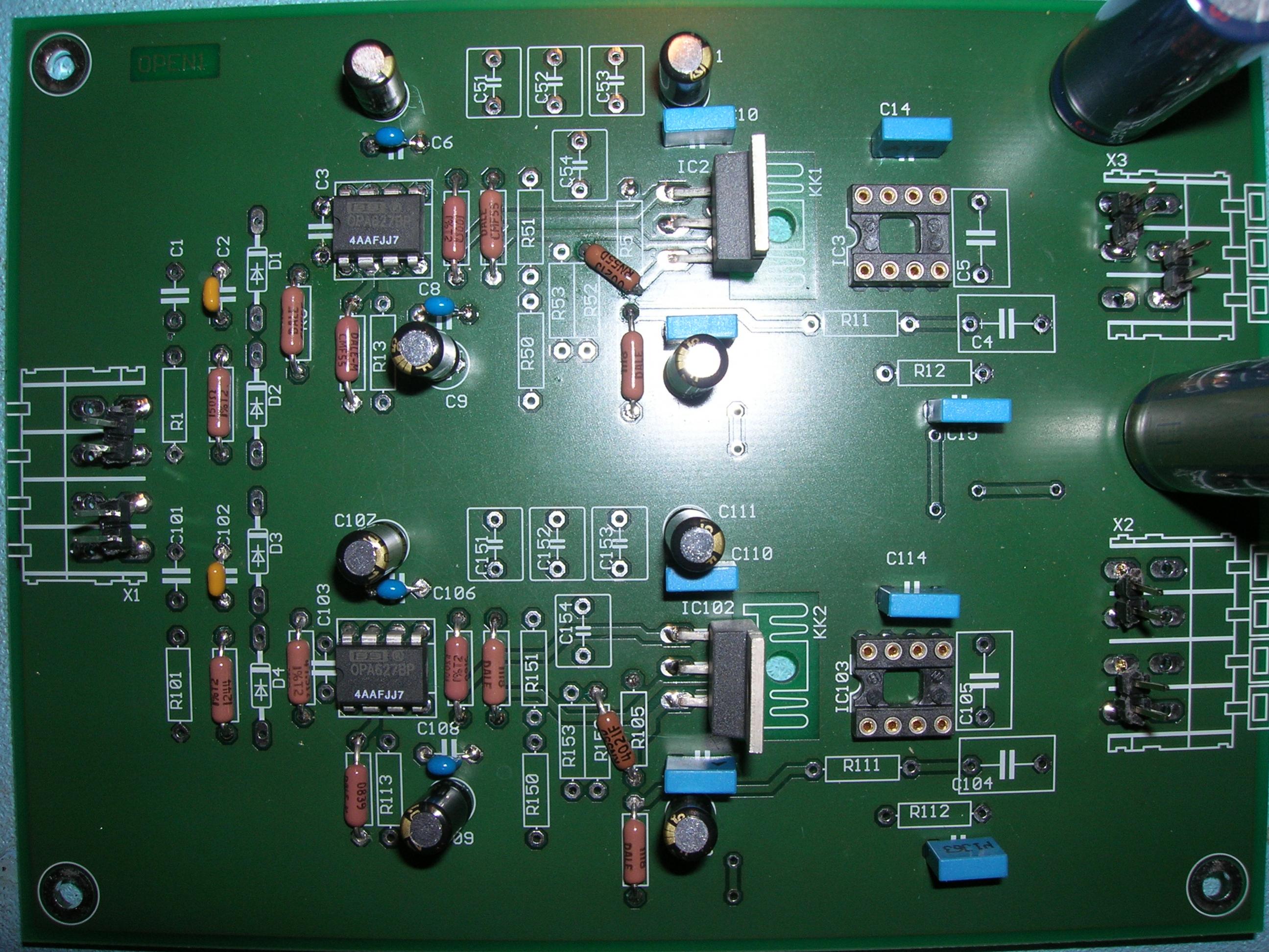

What I meant was you can alter other Pavel PCBs to be a greenpre:
His phono OPENAMP1 as a greenpre:

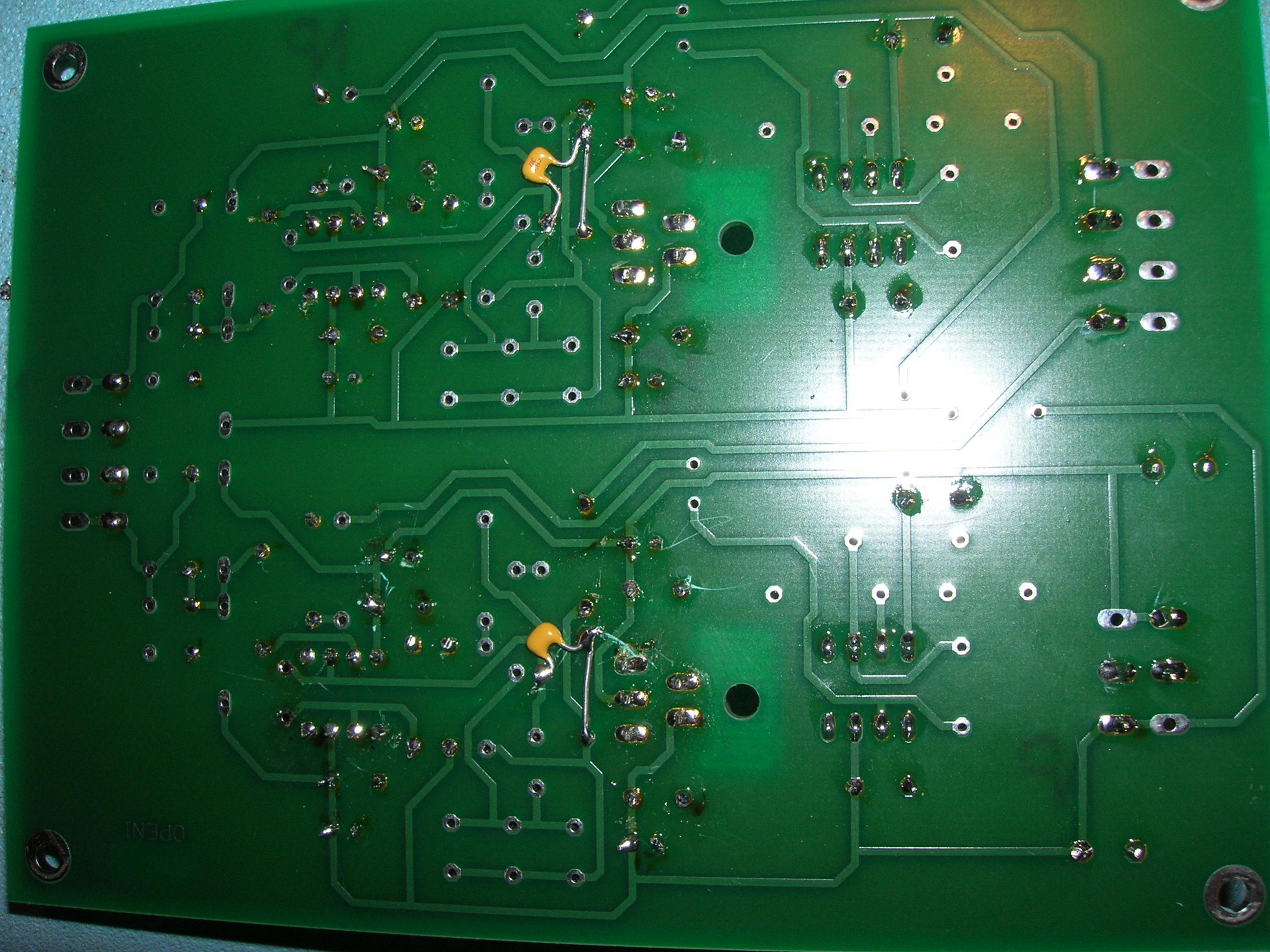

The fb res is the one on the angle, fb cap across it (bottom) and you have to bridge R5,
I just need low gain so I used 4k and 1.8k as feedback res.

Anyway, orange and kiwi have a little bit different noise background and the channels have been swapped. So, I have assumed that some golden ear might have indicated and described the difference ;)
No differences for me. Either my ears, or the gear is not up to it - I couldn't pick anything in it, even with my ears hard up to the speakers ...
I didn't mean to pay attention to the tone files but I think I heard differences that one file was louder or have lower tone (I think it was Orange1). I know it doesn't make sense. I just want to say what I think (should I check again? hehe).
