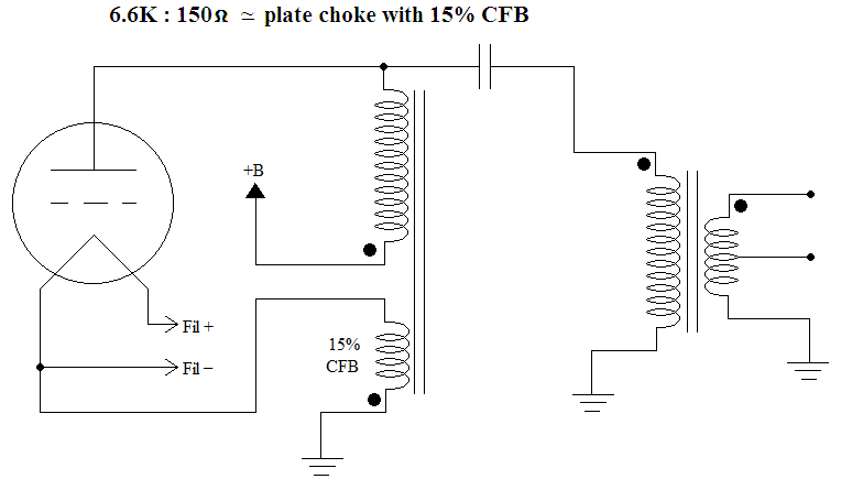

Anyone have tried to use CFB 8%-15% in SE triode amplifiers?

My recent thinking on the subject of UL and CFB is as follows. I'll start with my thoughts on UL...
1) For a conventional UL setup, the literature appears to confirm that for a broad family of tube types (say, KT-66 and 6L6-oids), there isn't going to be a big difference in the distortion profile for the commonly encountered tapping ratios of 33%, 40%, or 43%. These ratios should all give roughly comparable performance. Below about 25%, the full benefit of UL is clearly not realized, so this region is of little interest, while tappings from 50% to 100% appear to be of little or no practical value - one might as well go straight to full-triode if that is the desired set of characteristics.
2) Adding separate screen windings to provide UL screen drive from a lower bias voltage than the plate supply tends to compromise the OT's performance. Since it is critical to achieving the full benefit of UL operation that the screen taps have accurate voltage ratio and phase relative to the full primary voltage at all frequencies, a compromise in the OT quality is especially undesirable. A conventional tapped primary OT has a clear advantage in this respect, and the same rationale also argues against the addition of a separate winding for CFB (more on this later).
3) There appears to be significant freedom to tailor an output stage distortion profile through a combination of B+ voltage, quiescent current, and plate-to-plate load impedance choices. This freedom expands if one considers the use of a series voltage-dropping circuit to reduce the screen DC potential from the primary DC voltage by a fixed amount. A string of LEDs, for example, might do nicely, or perhaps a more elaborate solid-state shunt regulator type circuit, or even just a simple dropping resistor with bypass cap - there is no shortage of options. This further obviates the need for separate screen grid windings.
Conclusion: conventional off-the-shelf OTs actually already offer a good range of options with which to achieve most if not all of the benefit UL has to offer. There is still a bit of a guessing game as to which exact combination of primary Z and tapping ratio will extract the best performance, but within reason they should all behave well.
Now on to the matter of CFB...
From the perspective of electrode potentials inside the tube, there is actually no difference between CFB (furnished by subtracting part of the OT primary winding from between the UL taps and placing the same number of turns in series with the cathodes), and the use of plate-to-grid1 feedback (as illustrated in Fig.33(c) of O.H.Schade's "Beam Power Tubes").
There is also no difference in the drive impedance seen at the secondary - the feedback action is equal in both cases, and reduces the effective rp by the same amount. Actually, there is a small difference, which is that the CFB winding will bring some OT core distortion components into the feedback loop, whereas plate-to-g1 feedback would not.
However, if desired the so-called "E-Linear" circuit which takes FB from the UL tap to grid 1 would include similar OT core distortions in the feedback loop.
External to the tube however, I count three differences worthy of consideration -
First, plate-to-g1 feedback introduces additional resistance in the g1 drive circuit, which need not be present in the case of CFB. This resistance is unwanted if attempting to push into class AB2, or achieve extreme bandwidth, but could be dealt with by inserting a cathode follower (or FET source follower). In the absence of such a follower, class AB2 is likely not intended, in which case the series resistance may be helpful in mitigating grid current induced "blocking distortion".
Second, there are large voltage swings occurring at the output tube cathodes in the case of CFB, placing a heavy strain on the heater insulation. This reliability risk is avoided with grid1 FB.
Third, "Schade" FB is very easy and inexpensive to modify. With CFB, you are probably stuck with only one choice of feedback ratio. While this is not a technical difference, it could be a very significant practical one for the DIYer.
Considering all of this, I am now leaning firmly towards plain UL with feedback brought to grid 1 from either the plates or UL taps. Very conventional and boring! I suppose the standard circuits really aren't all that bad after all ... who knew? But, this has been a very fascinating and enlightening study exercise.

I haven't read through the whole thread, but I see a lot of agonizing over UL, "Schade" and OT limitations.
First some general comments. On the cheaper Edcor and Hammond UL OTs that I have measured, the central B+ to UL winding section(s) is generally well coupled to the secondary for UL purposes. I often see (measuring leakage inductances of the individual primary sections to the secondary, correcting for turns) one of the outer plate to UL sections poorly coupled. A poorly coupled section is best driven by a high impedance pentode plate since the leakage L is automatically compensated for by a current source.
The UL taps are a good place to take voltage feedback from, due to their close coupling to the secondary. +1 for UL mode, but the screens have a non-linear impedance due to the large variation in screen current. -1 for UL.
The usual plate to grid1 "Schade" resistive approach makes for a difficult to drive grid for the driver stage. Going back to the driver grids instead requires cross-coupled neg. feedbacks. This means the feedback(s) has to go thru the OT in class B mode, phase issues. In any case, the assymmetric leakage L's at the plate winding taps make for a poor feedback source, they should come off the UL taps instead.
If you take the feedback resistors back to the driver cathodes, then no more cross-coupling or hard to drive grids. (well the driver grids require more signal, but this is low level already)
The RCA handbook amplifier uses this (plus some Schade). Then taking the resistive feedbacks from the UL taps makes for more accurate coupling to the secondary, and helps attenuate the signal some as well.
On the downside, feedbacks to the driver stage cathodes seem to get poor "sound" reviews. Probably because they work too well to remove the distortion. With pentode drivers, the local loop gain can be phenomenal (no signal thru the OT, ie, no cross coupling in feedbacks, minimal phase issue). Maybe why RCA lightened up on it with partial "Schade", or to soften the saturation/clipping.
So far a standard UL OT will work fine. If you are going to wind your own OT, then I would add a winding with the same number of turns as the UL to UL taps, insulated for ground voltage, and put on as an afterthought (ie, kept out of the way of the closely coupled windings.) Then put caps between its ends and the UL taps. Voila.... closely coupled now. Can use it for a separate UL winding or a CFB winding OR:
Going further yet, The UL sections are the best coupled sections, but we normally use only one of them at a time in class aB. Why not use both at once all the time, a 2X better OT then, since the leakage L is halved. So we go Circlotron/Mac like by connecting the plates to the usual plate taps, and the cathodes to the extra winding ends (opposite UL tap end). Center point of the extra winding is grounded. (no need for two floating B+ like the Circlotron this way) Each tube effectively uses both UL sections and one plate section now. The plate section is operated by a high Z plate, so leakage does not matter there.
For 40% UL taps, this effectively puts 1.4 X turns on each tube from the usual, so the primary Z is doubled. So the entire OT can have its turns dropped by 30% (0.707) to get back to the same primary Z. This all works out to the same number of primary turns as the usual OT (including the extra winding here now). You now have a 1/2 Primary Z OT xformer to wind (as far as the tightly coupled windings are concerned) so expect another 2X bandwidth performance. Total is 4X better now, for no extra total primary turns. Ie, Mac performance with an easy to wind OT. Note that the tubes now have one UL to B+ section (in the added winding actually) acting as CFB, giving 28% CFB (40/(100+40). You can still do the above driver scheme too, or others.
ALL OTs should be wound this way by default. So flexible, can do most anything well.

Well, I don't know about agonizing... personally, this is more of a pleasant cogitation. Having designed around the commonly-accepted wisdom in the past without delving too much into the details, I am now making an endeavour to dive deeper and really think about the whys and wherefores. In some respects, this is more of an intellectual journey than a practical one, though the end goal is of course to build a better amplifier.
Some thought provoking responses here...
Johan -
your comment about the fussiness of pentodes is well taken. I have not really worked with them much before, but reading Schade's paper sparked an interest, and I'm quite appetized by what I have read elsewhere, too! The RDH4 treatment of pentodes is very good, and has sold me on the concept of giving them a try as driver and/or input tube.
That KT88 graph is indeed a good "summary" plot. There's a similar graph (I forget where, probably one of the Langford-Smith / Chesterman articles) which also shows the IMD curve - quite interesting, and reinforces that the ~40% turns range is about optimal, if minimizing IMD is the goal (and it is certainly one of my goals for this next amp design).
Ian -
Thanks, three good references I have not seen before. The AWV Radiotronics archive looks like a treasure trove of information. The RMS Acoustics page looks pretty good too - I'll have to spend some time going through these. I see Rob has a nice looking auto-bias circuit for his amp... That's another side-topic I've been exploring lately, but also a discussion for another thread.
smoking-amp -
Lots of food for thought here...
My conceptual notion of screen current is that it's AC components are essentially the worst of the distortion components (most of the high order junk) subtracted from the cathode current as it transits the tube. Re-uniting these electrons with their long-lost plate brethren should thus mostly cancel the high order distortions, leaving the more benign low-order distortion currents inherent in the g1-k interaction. Frank Blohbaum puts this to good use with his (also partition-noise-cancelling) BestPentode circuit idea. I've yet to really test this hypothesis myself, however Frank's data in Linear Audio vol.0 is compelling, and it seems to mesh with my read of Schade. If correct, then although the screen currents are indeed very distorted, the primary winding portion between B+ and UL tap should be carrying the (presumed linear) summed plate + screen currents, while the portion of the primary winding from UL tap to plate should be carrying the most distorted current in the OT. If you buy that argument, then UL scores a +2! (?) ... and it argues even more strongly for taking FB from the UL tap and not the plate.
More good points you raise about asymmetric leakage L's involved with FB from the plates, and about the cross-connected FB being more exposed to the class-B discontinuities. Hadn't thought too much about that so far. Taking FB to the driver cathodes is certainly a thought, though at first blush seems difficult with high-gm types (low-impedance FB network). In any case, my instinct is to apply the bulk of the driver tube's gain into it's own FB loop, keeping the amount of FB in the output tube loop relatively modest. One could certainly play with that ratio and search for a nice balance.
Having settled on a conventional OT for the current project, I'll have to return to the custom OT concepts one day when I am ready to invest the time. But I like your thinking on the OT compromises and solutions. I would perhaps pick a ~17% CFB ratio, or ~20% UL tap with equal tertiary, and keeping the same total # of turns. That would give a more conventional ~40% UL ratio seen internally by the tube, and reign in the grid drive voltage swing needed. The caps to improve tertiary coupling are a nice touch, similar to the old trick of bypassing a 1:1 IT with caps to improve BW and phase at the high frequencies ... Fisher 50A and the like. An elegant solution, filed for future reference.
