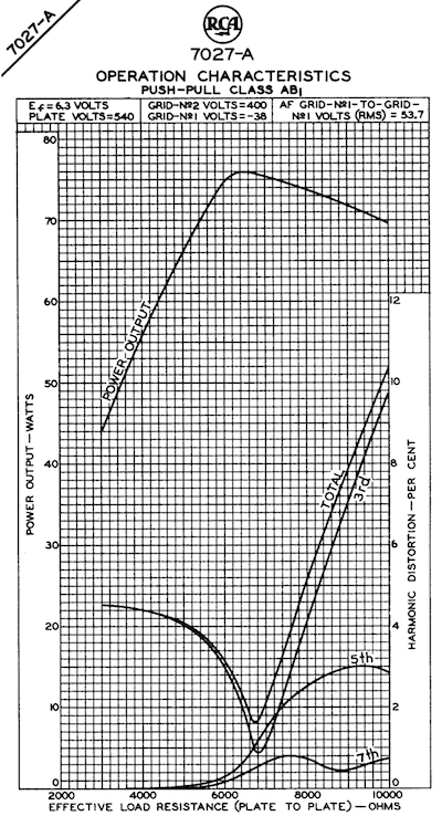

... so I have a bunch of these nice "super" 6BG6-GA (7027A in disguise) gathering dust, just burning for me to build a nice amplifier around them.
For this design, I want to try zero global feedback, which means extracting the maximum performance from the output configuration & local feedback. Distortion trumps power, but I'd still like to get reasonable efficiency. Triode class AB2 is one option, but I'm thinking I would rather run ultra-linear, with a separate screen winding to allow a higher B+ on the plates, and another separate winding for cathode feedback. Having not tried the latter before, and wanting to 'get it right' (or close to right) with a set of custom-wound OPTs, all sorts of questions about distributed load winding ratios come to mind…
For a start, the optimal Pentode loading appears to be 6.6k, which SY also suggests is a good loading for Triode strapped operation. One might then assume then that this would also be a good load for UL operation - would that be a correct statement?

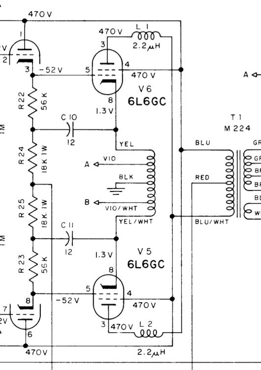

Anyone have any insights into the little plate chokes?
See attached schematic of the McIntosh MC40 output stage, which shows 2.2uF chokes. Strictly for stability, or is there more to it?

Chad: first the chokes, I'm pretty sure that their reason for existence, being so small in value, is to control spurious oscillations and/or HF ringing, and not fundamentally part of the architecture of the Mac.

As far as the McIntosh amplifier, those small chokes are for parasitic suppression. The output valves are biased almost off, so will try to excite primary resonances regularly during the duty cycle. The other polarity valve's cathode winding is bifilarly coupled, so helps to damp this, but no coupling is perfect, especially anode to anode.

Take a look at Miles Prower's Vixen where he uses similar chokes, and describes how to wind them, and why he uses them, on 807s (forerunner to 6L6 family, including 7027a)

The drive requirements do indeed get a bit silly with excessive CFB. Interesting comment about perveance - makes sense. What, in your estimation, counts as a "high perveance" tube (it's not a commonly listed spec)? Pretty much all the usual 6L6-oid power pentodes? Just looking at transconductance as a stand-in, I see the 6550 and EL34 look to be roughly double the gm (and appear to have larger cathode areas) of the 7027A.

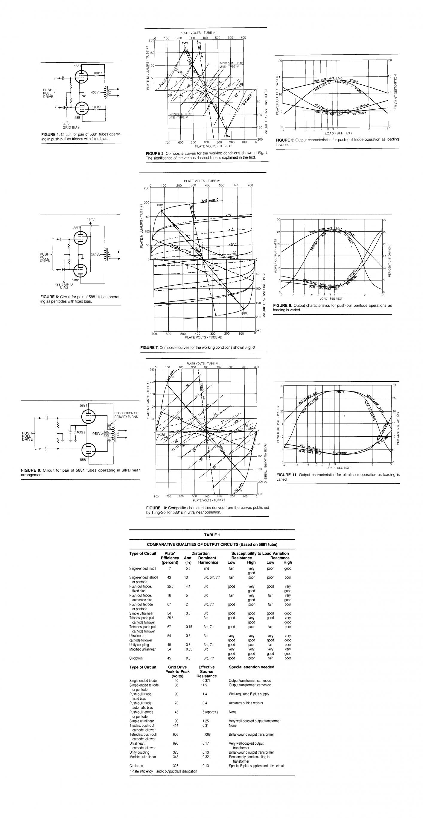

I don't remember where I found this little comparison of output stage circuits - it's been in my audio archive for almost 10 years - but it's interesting, if slightly tangential to this thread. Looks to somewhat duplicate some of the information in Crowhurst's book "Understanding Hi-Fi Circuits". I'll post it here in case someone finds it useful.
[Edit] - It is missing the circuit diagrams for some of the more interesting variations. I'll try and post the pertinent schematics this weekend. "Unity Coupling" is the McIntosh circuit. "Modified Ultralinear" is what the Quad II output could be considered, for a UL ratio of 10% with 10% CFB.

Thanks everyone for the replies. I'm now immersed in even more reading... I still see conflicting reports on whether an optimal UL feedback percentage exists or not.
It doesn't. For example see the attachment. They soon found that 43% doesn't work really well for the 6V6.....
Ideally you should experiment all solutions to know the best (compromise). I have found by chance that 50% UL works really well for tubes like EL84, ECL/PCL 82 and this makes the transformer windings much more practical. The transformer "ideality" should also taken into account.
