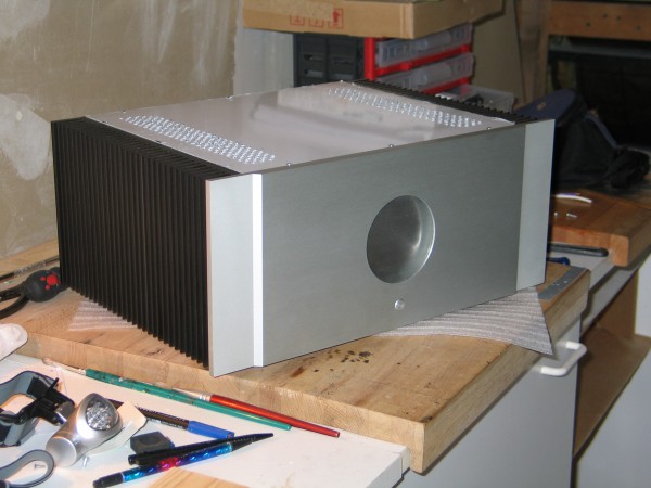

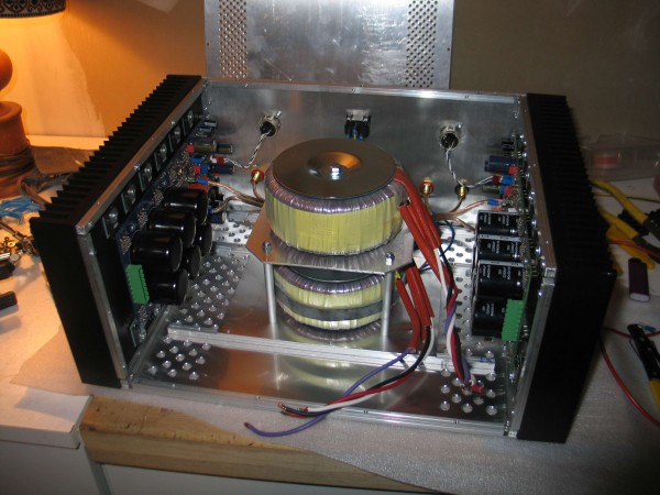

I have been looking into the bias thing, to find the advantages of raising the bias. Here are a few arguments for doing it: Generally lower distortion, lower IMD , lower output impedance, better ratio of low order harmonics VS higher order's. Still needing a reason; more heat (good in the winter ) Probably a few more .... I was convinced I didn't make any of that up and dont take my word for any of it, just read Papa's writings
I have re-adjusted the amp's for a voltage drop across the source R's to 187mV. The source R's are .45r. This means 415mA bias current through each fet, resulting in 25 clean Class A watt's. Amazingly the offsets didn't wander one bit, while setting the bias to almost the double amount. 25 watts should be enough for "normal" listening levels, without hitting Class B. At this setting, the heatsinks do get handwarm, approx 40 deg C.
Having been listening all day, the amp seems to have gotten a little more analytical and better sounding at the same time. The sound changed to more "calm" and relaxed with an easy pinpointing of details. Cymbals are a little better defined and extended upwards, keeping the silky-like sound. Midrange and voices are very pleasant and with the bottomend deep and clearcut, I will definitely keep this setting.
Allthough the amp was allready very good, and the improvements are rather subtle, the increased bias makes the U.P.'s go from "best amp so far" to "best amp by far".
The U.P.'s rock, and are truly impressive amp's......
