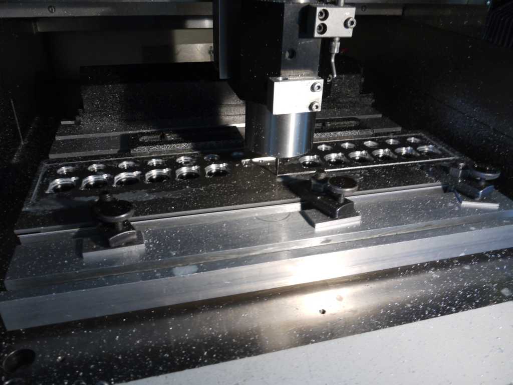

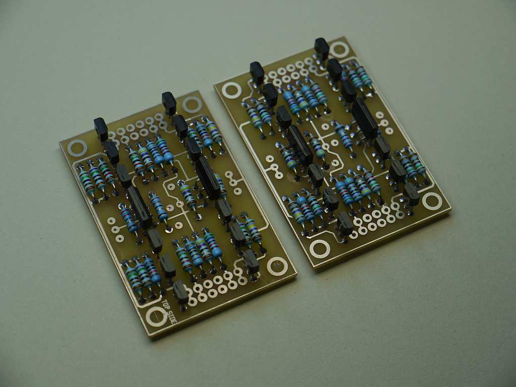

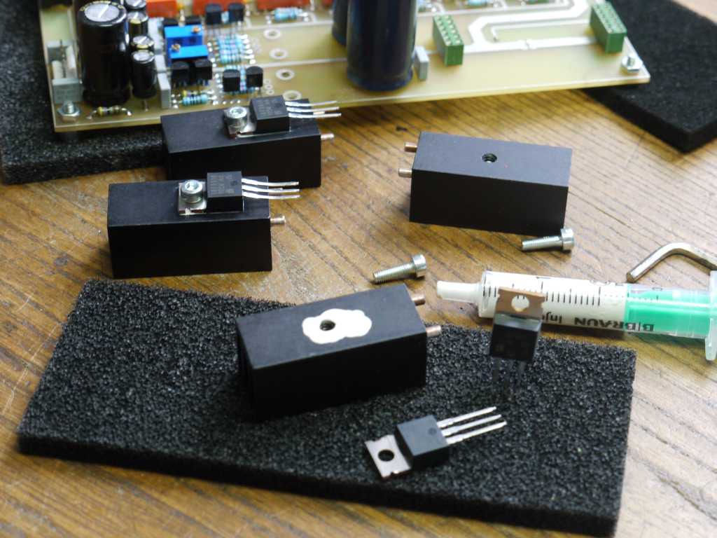

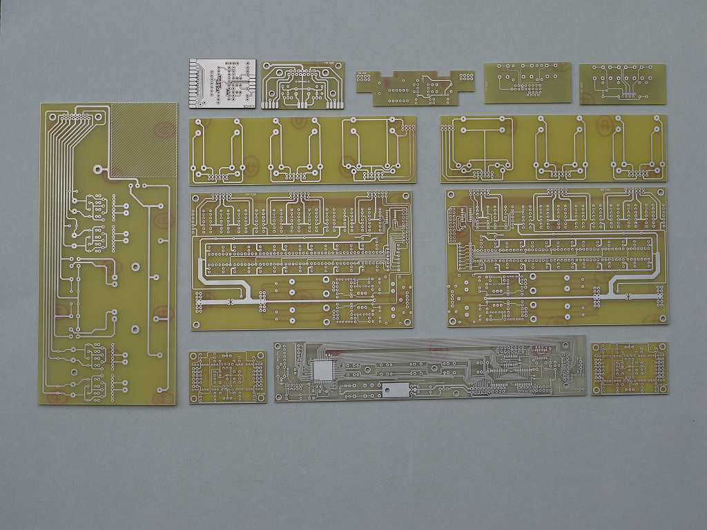

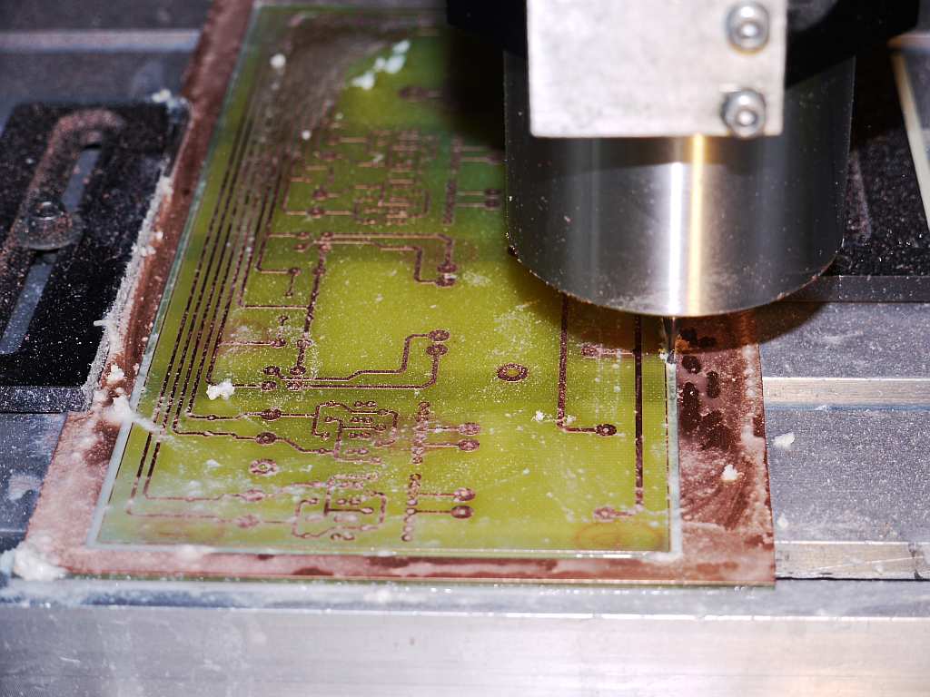

Good to read that some more fanatics have choosen this project. The UGS preamp is a very nicely and absolutely professionally developed and planned project, - thanks Francois! And thanks Manu for your support and encouragement! I have made my own boards, some were milled the rest was etched. Most stuffing and soldering is done already. Now I do the case and have started with the backplate. Here are a few pictures of my build.
Greetings to all, Martin
