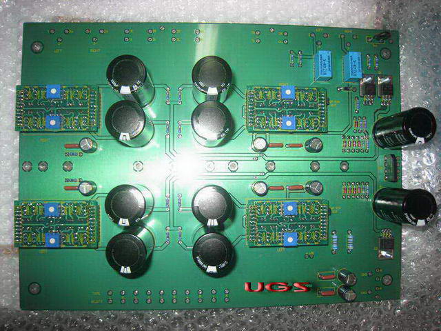

I've been reading through most of this thread once again, and I was also offered a set of PCBs as requested, so I might give this one a go, beautiful as it is! Hats off for Cheff!
And I most ecertainly need a new set of amps.
I found the zip for the PCB, which I may or may not need ( I will need the silk overlays though), but is there a zip somewhere with the corresponding schematics and comp. numbers for all the additional boards except the UGS module itself?

Usually LeCheff's boards are designated with the component values. I for one pretty much like that! Usually you will have to compare the schematic's to the board's Go figure; you actually have to do a little work yourself.
Dont hesitate building LeCheff's UGS, everything else is somewhat pale and "bloodless" in direct comparison.......
UGS circuit of extreme simplicity, is the output current smaller, more select class after.
I use Nelson Pass F4 power circuit when the buffer output ,current small problem disappeared ....

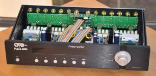

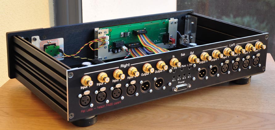

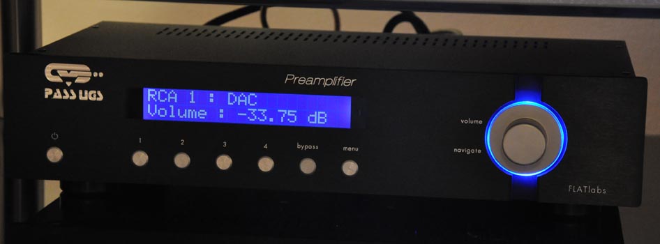

Finished !!!
Couple of days ago i finally finished my UGS.
It has been playing for many moons now but i had to learn how to use my CNC properly to finish the case.
It's more or less accomplished, this was my first DIY for many years, next one will be better.
Great many thanks to François and of course NP for this sweet thing , their generosity is amazing.
( ...many thanks too for ZMs patience because i put the Shanling project on hold to finish this one first...i'll now make it the CD player it can be. )

Thanks François but you did all the important work.
one thing i think i should share: the 4R7 supply resistor on channel MB changes value with time , mine were reading in the order of 60 ohms.
i would suppose this is because they should be of higher wattage , eg: 0.6 W ?
