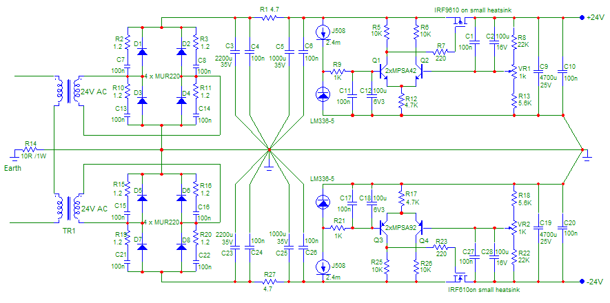

4) What are you using for PS? Why no local capacitors on the preamp boards? How about a LP filter on the input supplies?
The PS is inspired from the Pearl's supply (see attached file)
There's no local caps, but the supply's output caps are close to the module :
The supply's on the right of the module (old ones ;) ). And I didn't
feel the need for additional caps, nor of an additionnal ps filter.
