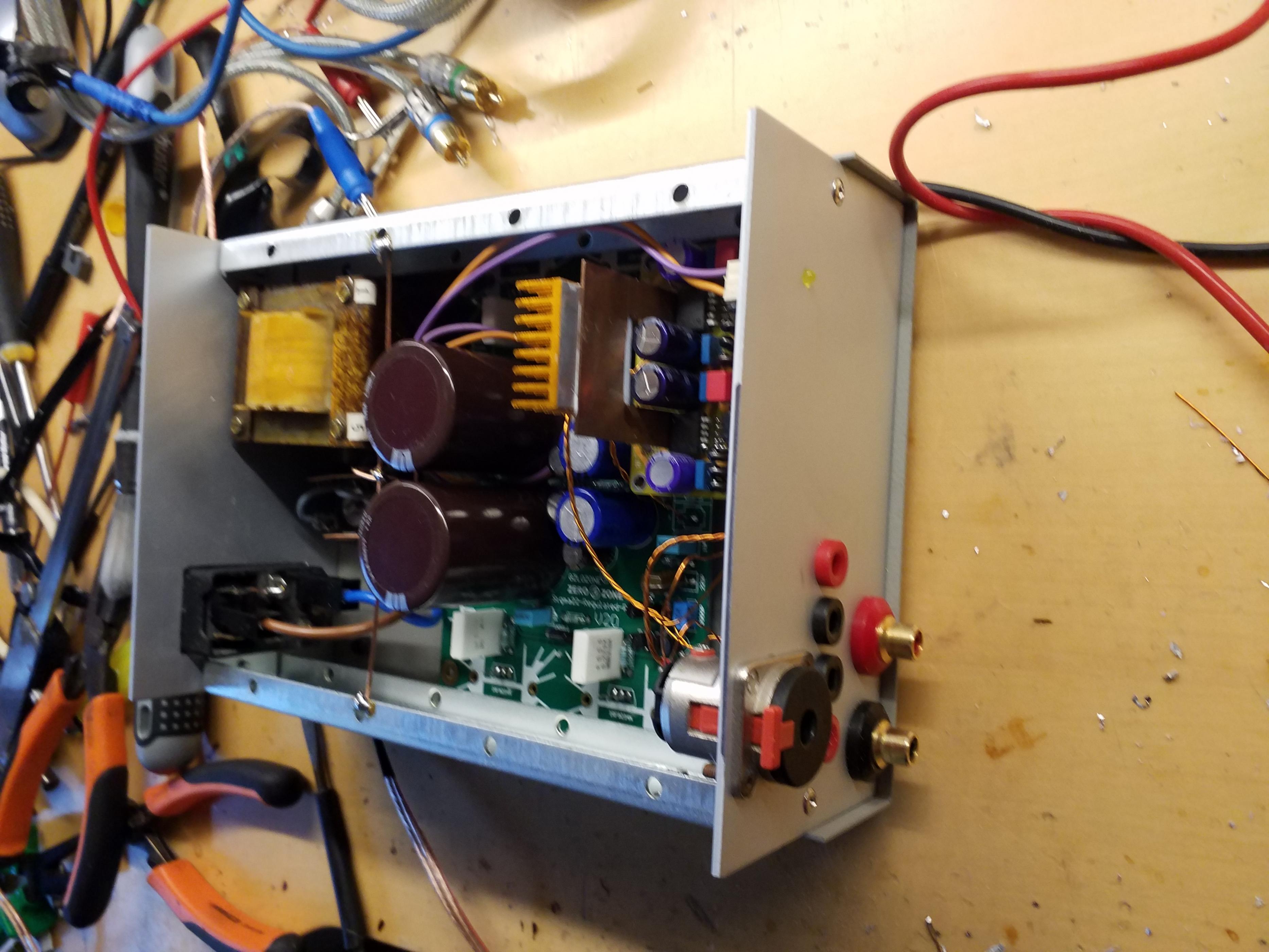

Mx50se, LJM P9 preamp in a box.
Sounds good, could have been a bit more tidy.
LOL that is epic! :D

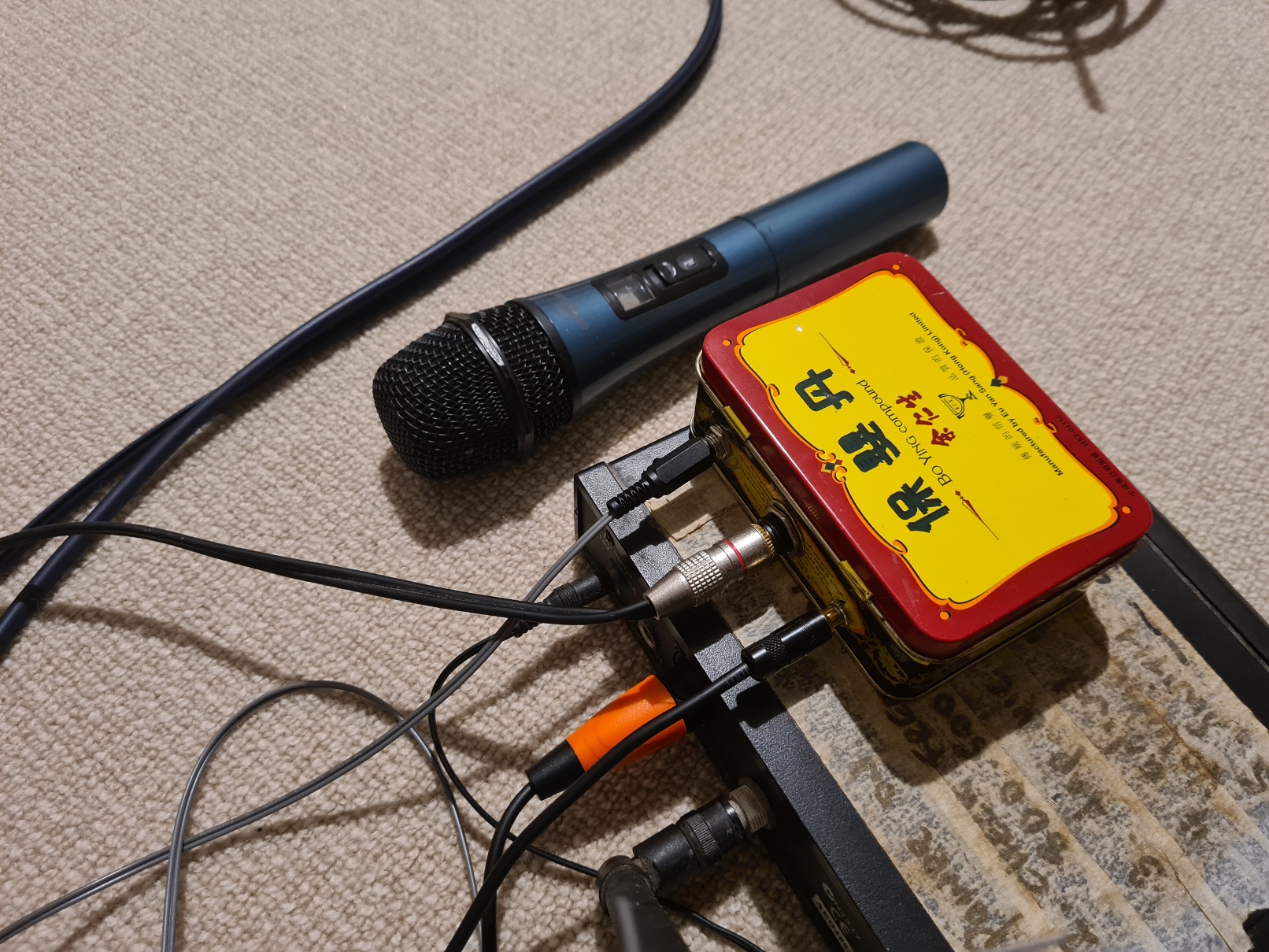

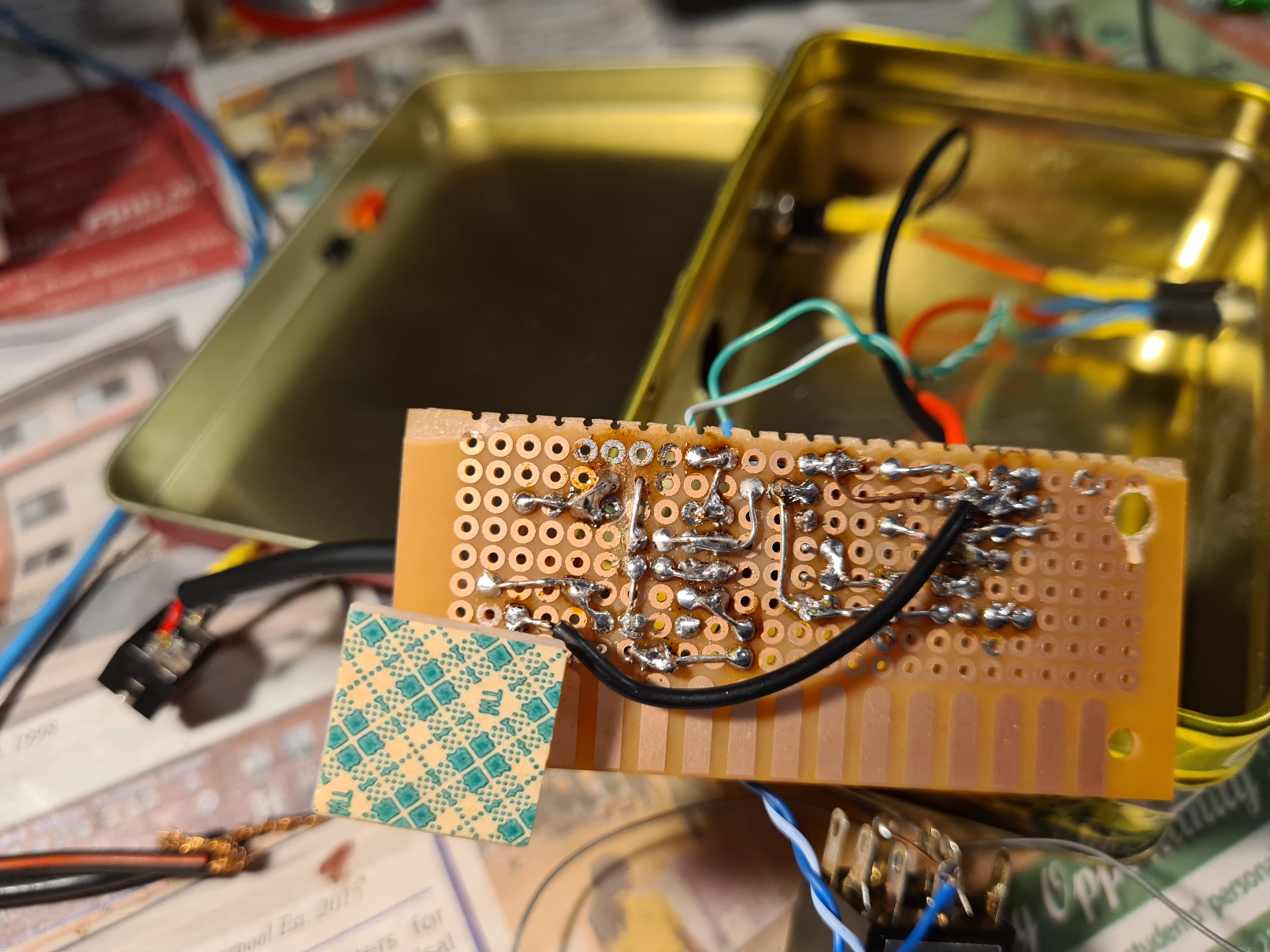

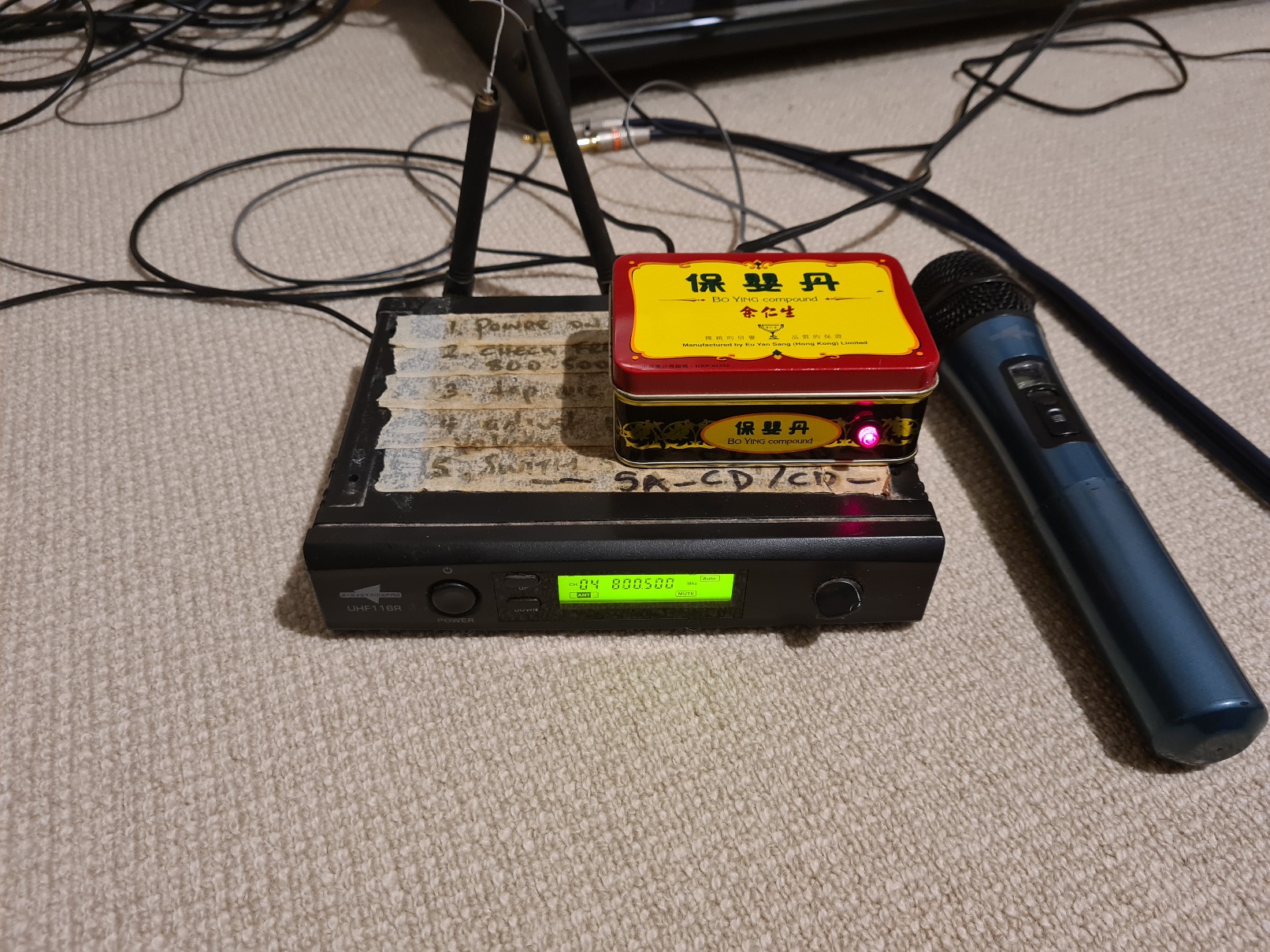

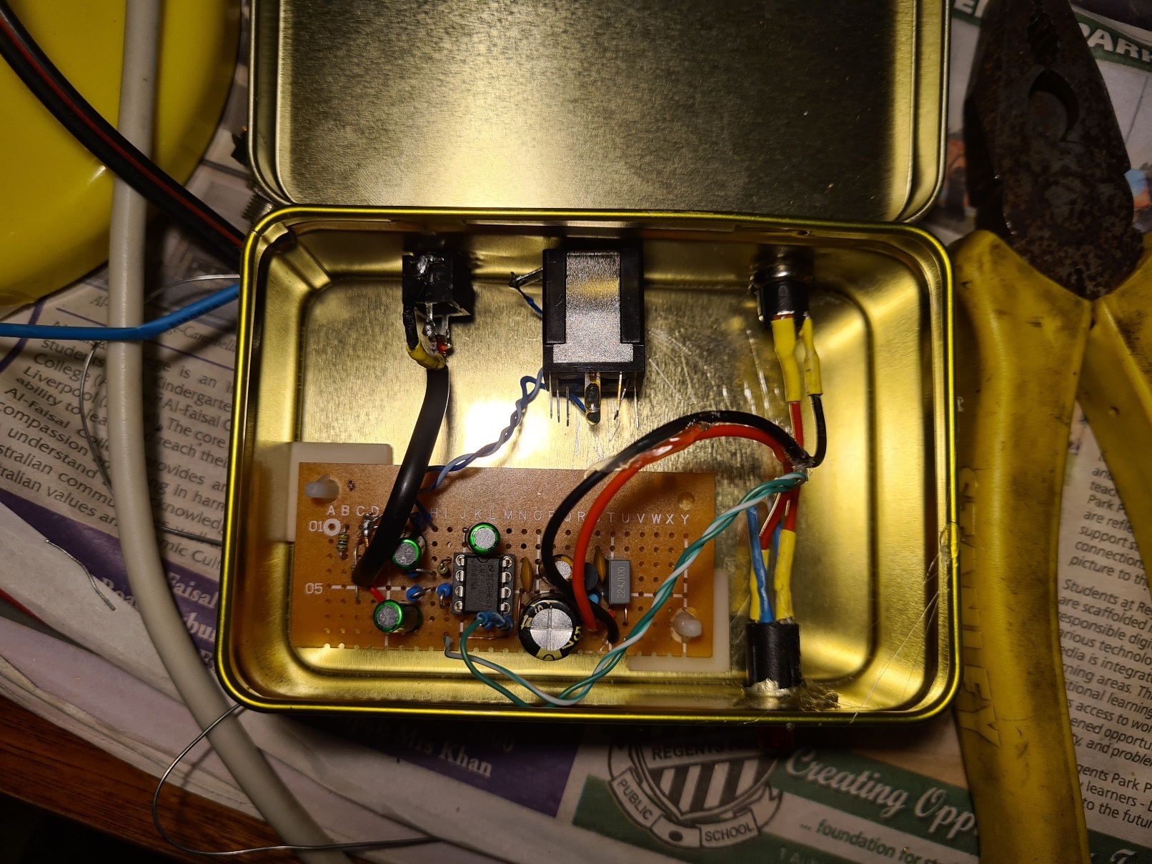

I finished a pre today too. Not particularly aesthetic, but not quite in the league of other posts in this thread ;)
11 X gain to get a decent level out of a wireless mic when connected to a standard amplifier. The base had rca out but it just did not have anywhere near enough gain.

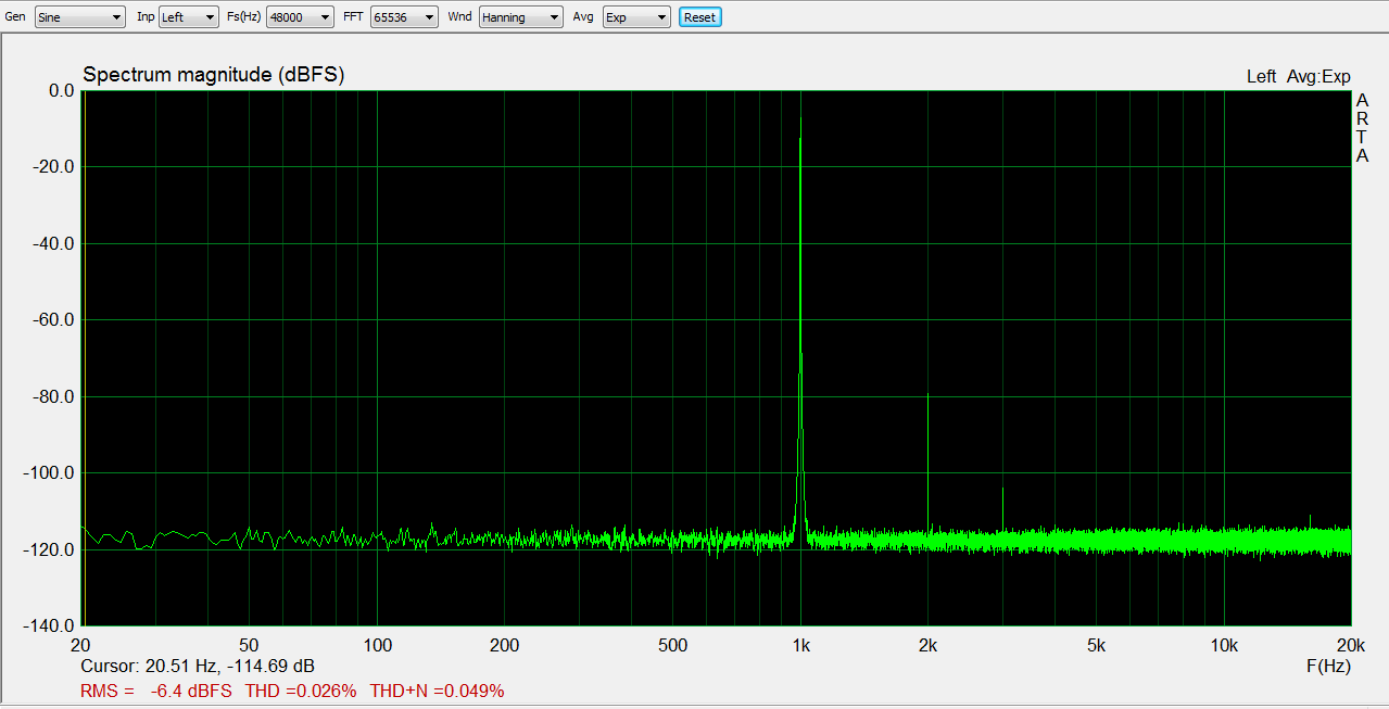

edit: oh and the measurement to show it is good working ;) input was -27db.
