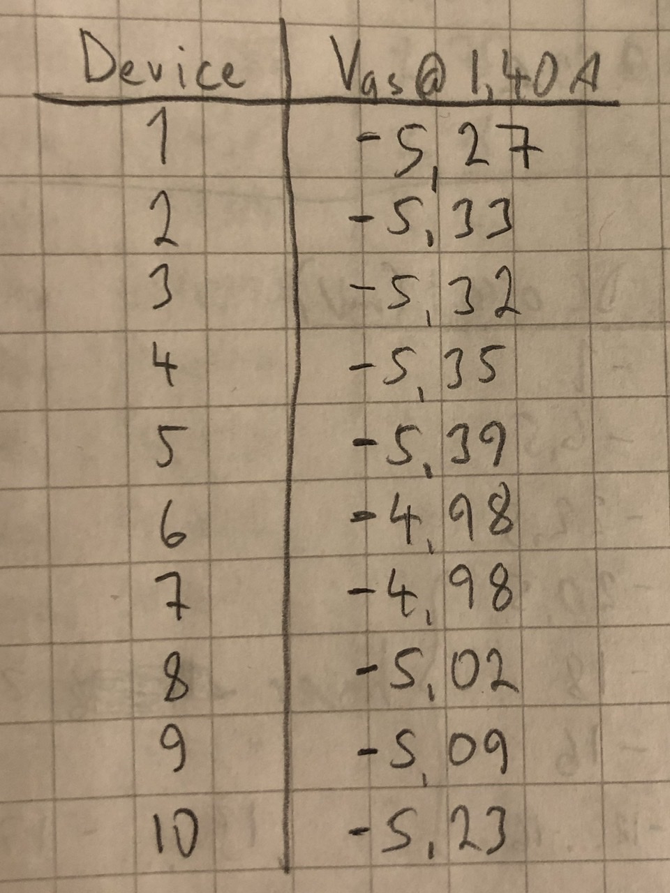

I managed to get both channels up and running with the new matched FQA mosfets. Rail voltages were +-21,7V with the First Watt type of CRC supply and 300VA/2x18V transformer. Bias was stable over one hour 1,35A for left and 1,36A for right. DC offsets were easily settable to few mV without servo.

I already have a matched quad of 2SK170BL's for Q2,Q3 but need to read up on measuring JFETs like J113 for Q1 (to find one that has a minimum Idss of 8.5mA and since it dictates what value Bourns 3296 pot needs to be purchased for the Rdg component), as well as MOSFET matching and testing, for Q4, Q5 which require matching Vgs at bias between channels.
Ti Kan has a nice web page describing how matching of different semis can be done:
The β22 stereo amplifier
How many J113's should be purchased to find one that has at least an Idss of 8.5mA?
Morde, you recommend ~ 20 FQA9P25's perhaps to find at least 1 QUAD to match?
