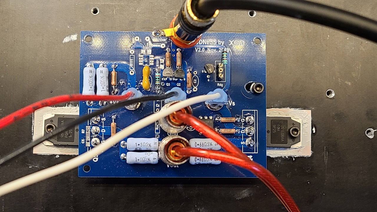

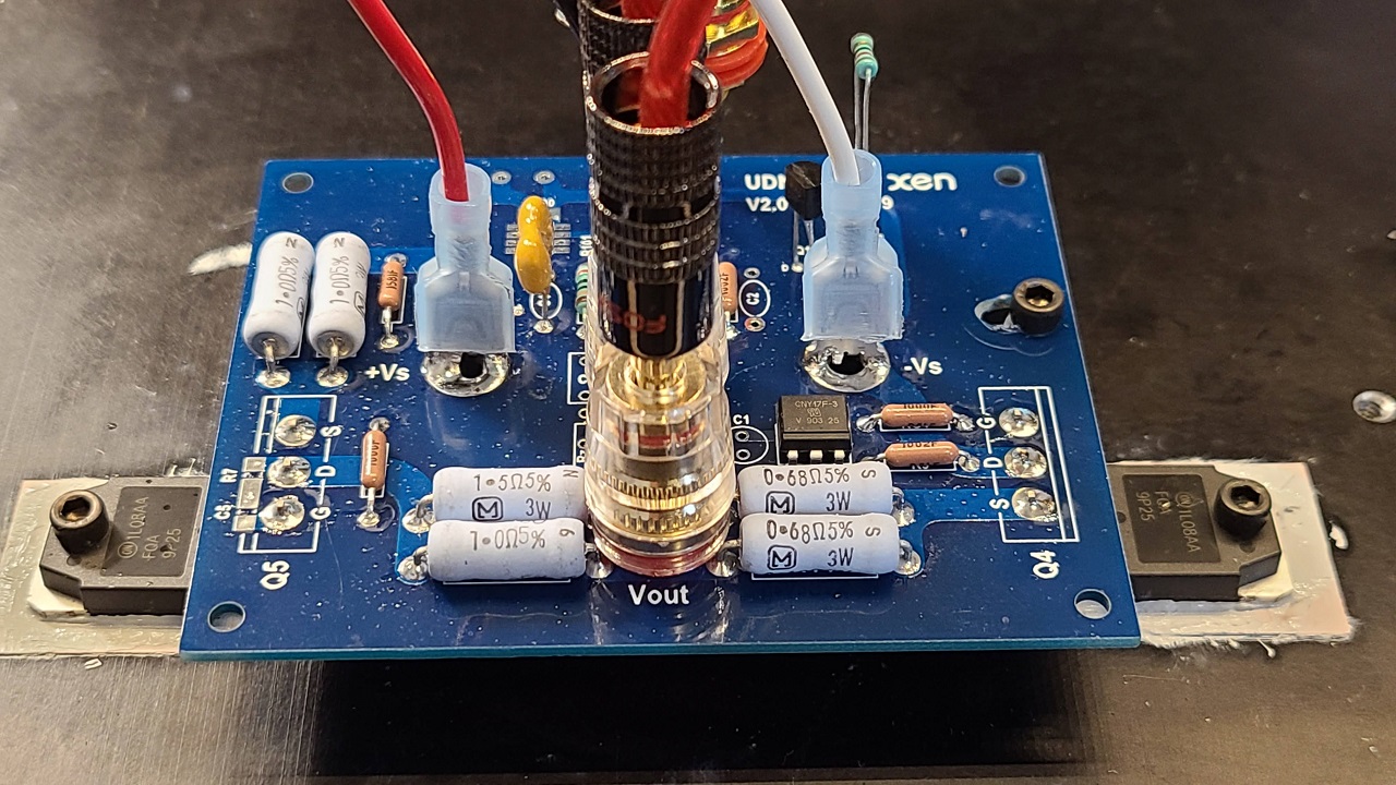

First channel adjusted (partially) and settled nicely but not quite sharing equally.

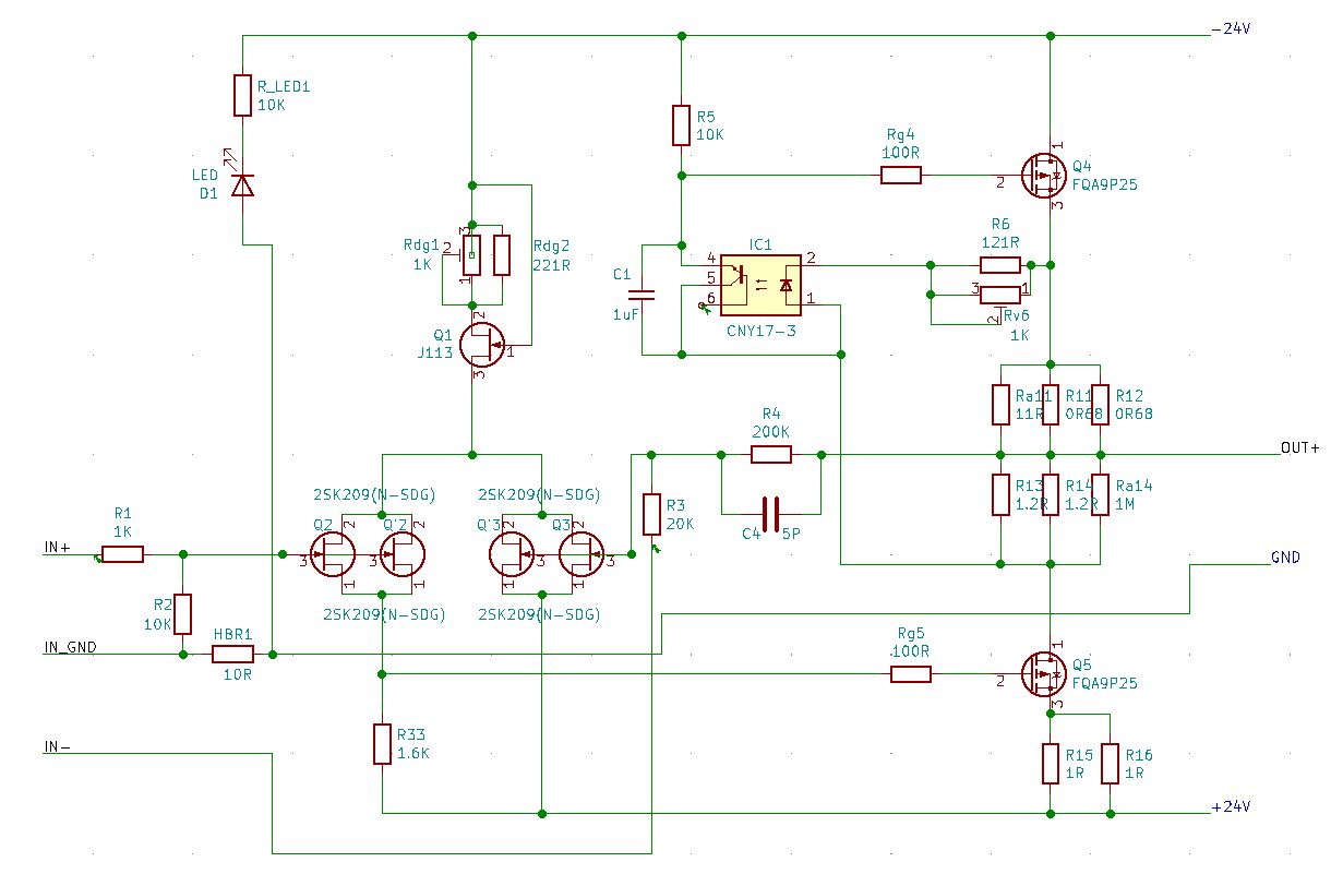

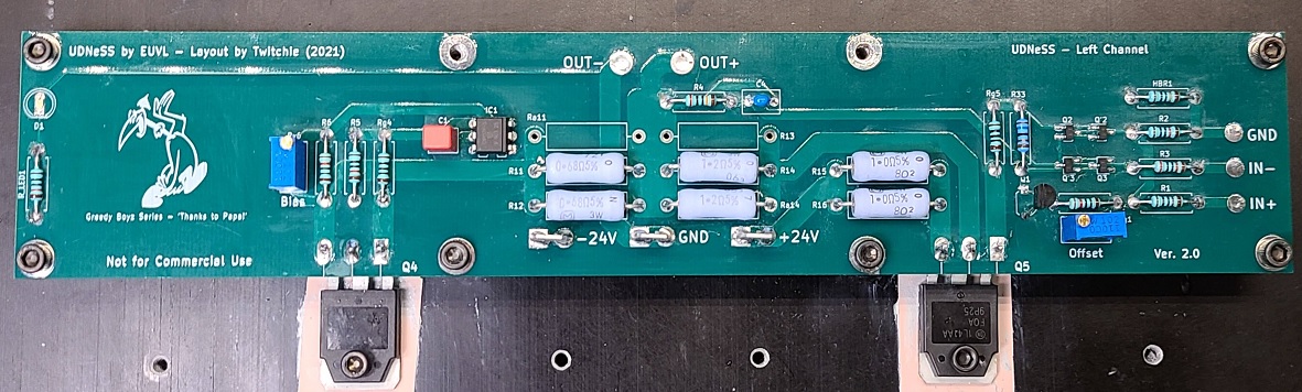

I used the Revision 2.0 revised schematics and was not quite clear on all the 'extra' resistor footprints (plus I omitted the servo) but now it makes more sense.
R11a (R112a on the board), R14a are used to 'tune' the current sharing between the 2 mosfets but you won't know what adjustment to make until you've got it running and measuring AC across R15/R16. I don't have either of these populated currently and I used the values straight from the schematic for Rev2.0.
R6 on the back of the board sets bias and there are 2 slots so you can parallel resistors (SMD). I just used the really small Panasonic 1/2W resistors here as I have a bunch of different values from back in the Peter Daniel (Aleph30) days.
I don't have the 2SK209 pcb so I just resorted to using 2SK170BL instead.
What I used
Fairchild FQA9P25 mosfets (thanks Dennis!)
J113 for Q1
2SK170BL for Q2/Q3 (Idss below 7.0mA)
100R for R6 (single)
For Rdg, I started with a 1K pot. When I first powered it up, there was no current going through R15 and I had 22V DC offset on the outputs. I thought maybe it was broken or I had incorrectly installed something but twiddling with Rdg brought offset down quite quickly and at the same time, current started flowing through R15.

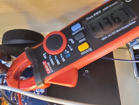

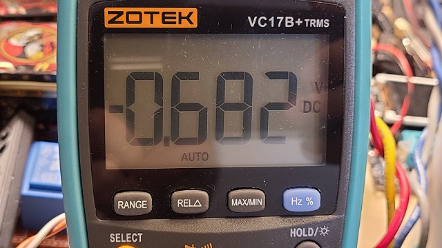

I ended up with about 86R on Rdg and eventually swapped it for 100R pot instead of the 1K and let it warm up. It settled around 48C on the heatsink and Rdg measured 83R so I swapped in a fixed resistor at 82R. Now when it's warm, it hovers around 10mV of offset. Note that the offset cycles up and down through about 30mV. Current through R15/R16 was 682mV or 1.364A. Clamp meter agreed with this more or less (1.367A) although sometimes they differed by as much as 30-80mA. If I were to do this over, I would put 200R for R6 in parallel with a 500R pot. Based on the comments from Bullittstang, I suspect I'll probably need somewhere around 65-80R to get this channel down to 1.3A.

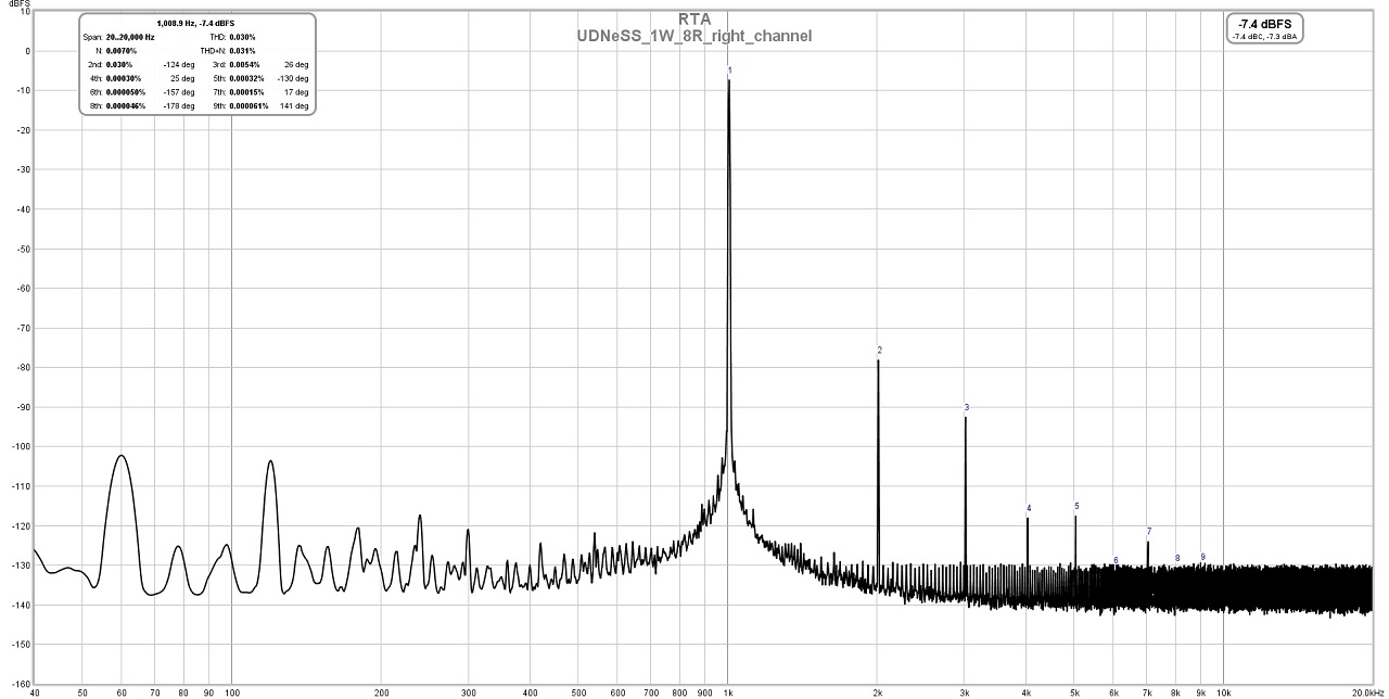

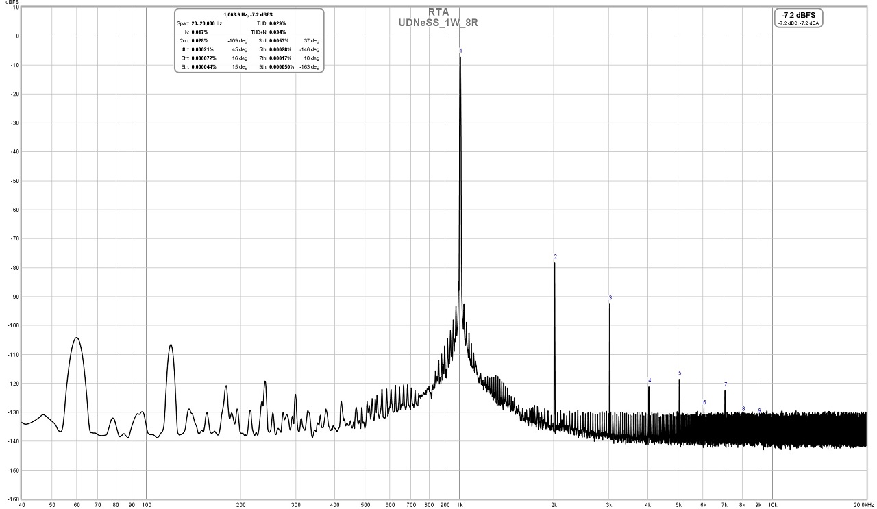

I don't know about the 2SK209 version but with the 2SK170BL, this thing has quite a bit of gain. Input voltage to get it to 1W (8Vp-p) with 1KHz sine wave was only 380mV. Heatsink is probably a bit smaller than the 3U/400mm and stabilizes at 48C, although it feels hotter than that (or my hands have become more sensitive).
It's definitely H2 (positive) and sounds really good in initial testing. Very lively in my limited testing.
I'll get the second channel running next and as long as it matches the first channel I don't think I will bother adjusting R11-14. Right now at 1W into 8R dummy load (single ended input, Vin- shorted to GND), I measure 137mV AC across R15. Seems like a lot of work to try and squeeze a 0.1R resistor between Q4 and V-. There is about 1-2C temperature differential between the 2 mosfets but this is just an exercise build for now (which explains the hack mounting - apologies if anyone is offended :) )

Gain is a bit less than 11x determined by (R4+R3/R3).
So it agrees with your measurements.
100mV offset is nothing for a power amp.
So as Morde has published, no need to servo.

Incidentally, I always recommend replacing trimpots with fixed resistors.
Even if you want to keep a trimmer for fine adjustment, you can still pass most of the current via a fixed metal film.
For example, you need 86R.
You can use a 100R fixed resistor in parallel with a 1k trimmer.
The trimmer would then be at 614R, somewhere near the mid-point.
(A 105R fixed would be even better.)
Patrick

I have a question regarding C1 (cap across the CNY17) - in the J2 and F8-like sim, it's 10u polar but in the UDNeSS it's 1u non polar and even there is it actually necessary? I read in the revision that if you increased that to 100uF, it would increase gain but at the cost of H2. I saw C1 missing in some photos (not installed) and don't have it installed on mine but want to also ask if it needs to be a 'better' cap or will any cap suffice (MKP, MKT, MKC, MKS, etc). On the board it looks like a 5mm/2mm electrolytic footprint but on revision schematic it's 1uF.
We recommend you stick to the V2 schematics and use WIMA MKS02 1µF for C1.
This is the result of numerous experiments and measurements.
Changing the value will change the distortion spectrum.
Leaving it out altogether will lose stability under capacitive load.
So we do not recommend leaving it out.
J2 / F8 have different devices.
So component values are also different.
But you can experiment to see how it changes.
Patrick

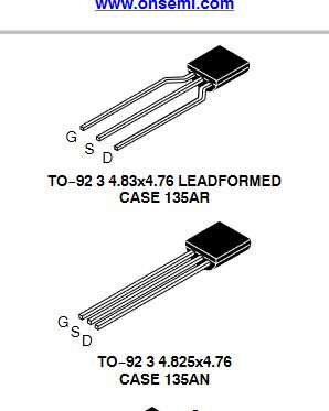

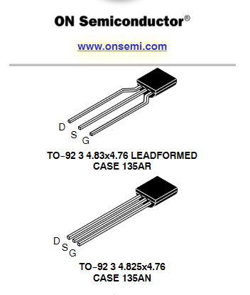

You should have tested the J113 on a breadboard first to work out what source reeistor you would need, roughly.
Then you would have found that out before soldering.
And this is the trick :
Say the breadboard tells you you need 1k source resistor (just an example).
I would then use a 10k trimmer and set it to midpoint (5k).
And then parallel that with a 1.25k fixed resistor.
That way, 80% of the current goes through the fixed resistor.
Only 20% through the trimmer.
You have less range to trim, but you have a much better source resistor.
When done, I normally remove the trimmer altogether and replace also with fixed resistors.
Patrick

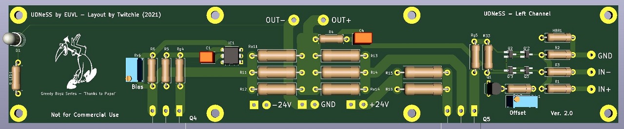

Lift between IN GND and PSU GND (hum breaker) or between PSU GND and Earth (with input/output and power GND all connected but lifted)?
I created my own layout with 10R between IN GND and PSU GND and on the PSU board I have a thermistor ground lift.
I plan on running this SE only so I will wire the input to IN- and use GND lifters as you advise. Thanks Patrick! :cheers:
Never used that before.
Was what I meant.
Nice layout.
I have asked Morde to share how he did it with differential inputs.
Maybe wait for his input as well.
Or just try and see which gives you least 50Hz pickup.
