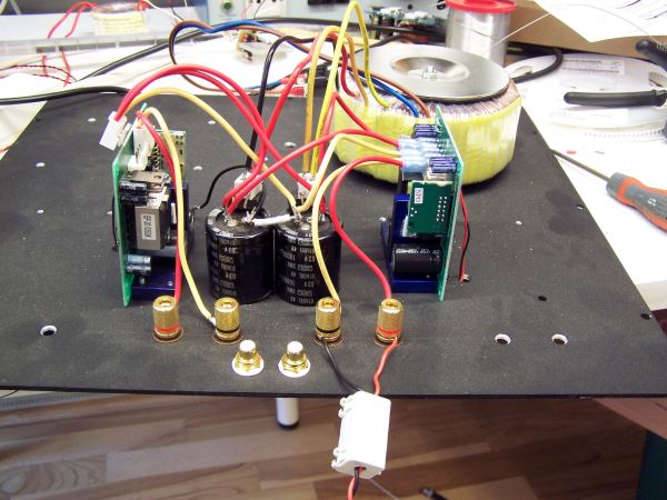

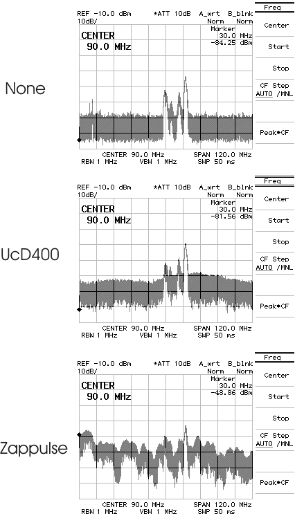

UCD400 and UCD400AD RFI emissions
Jan and Bruno sent me their newest modules, to make a comparing EMI measurement on my spectrum analyzer. Thanks Jan and Bruno!
I made all measurements (also the ones for ZAPpulse) with a Ferrite click on tube. (To stop airborne induced noise jumping into the speaker wires).
RFI for UcD400 (first version serial no. 0001 )
UDC400
RFI for UcD400AD (Newest version)
UDC400AD
The RFI is greatly reduced on the newer version compared to the first versions of UcD400.

The same setup was used for all measurements.
See the setup here:
UDC400
UDC400AD
See the setup here:
Re: UCD400 and UCD400AD RFI emissions
Yeah the original 400 was a minor disaster due to the inductor.
Looking forward to getting your 2.3 modules in return so we can duplicate the test.
Do you also have a pic of the setup that you used to test the zap module?

OK i went ahead and did them (seems to be more interesting than starting the weekend )
20 V RMS out in a simulated load with RCL (like a speaker). 50 Watts RMS
It looks like it's a tie .....
UCD400 with 20 V RMS
ZAPpulse with 20 V RMS

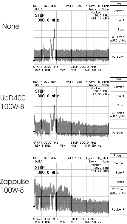

Hello,
I was one week on vacation, sorry for the alte reply. Lars we have also received the Zappulse 2.3, thank you.
Hereby my measurement results on the two amplifiers. We have an Advantest R3131A spectrum analyzer and a current clamp.
Actually I measure much more EMI.......
Jan-Peter
Jan-Peter

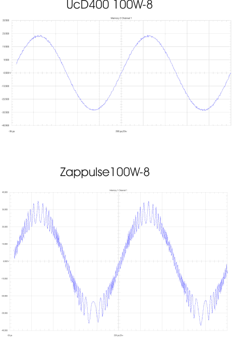

Peranders, the first measurement was in standby mode and a load of 8 connected to the amplifier. Spectrum Analyzer from 30MHz to 150MHz.
Hereby a measurement of the outputsignal by the Scope (Fluke- PM3391A), againe with 8 ohm and 100W of output power.
Jan-Peter
Jan-Peter
