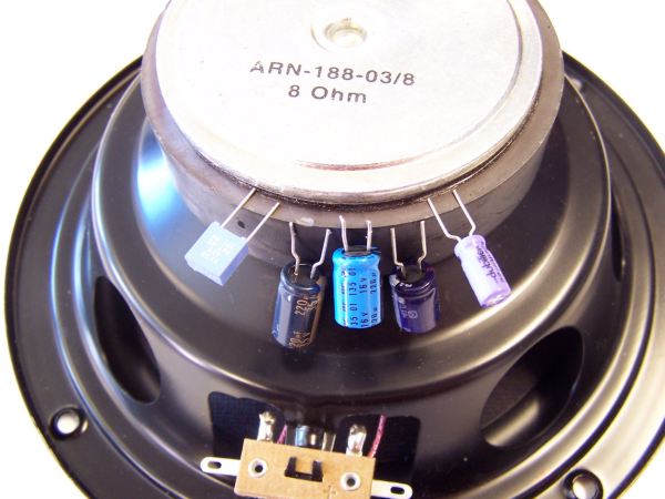

I do not recommend speaker x-over network caps for this, they are simply not made for this kind of job, and will perform terribly compared to the better (and much cheaper) solutions.
Even BG-NX HiQ is not very good for signal path use.
Using a WIMA MKS2 cap of 2.2 or 4.7 uF is a much better solution. Before you jump to other similar brands, check if the leads are iron or copper. Those with copper leads sound much better than those with iron leads (most brands).
Even better yet is the Vishay SAL 123 RPM series. They just sound GREAT as a DC blocking cap or analog decoupling cap.
