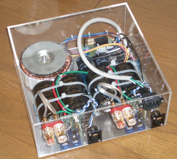

Acryl UcD case
Hello all,
Someone on this board suggest to built the UcD180 modules in an acryl case. Although that was not my original plan, I just did that. I had a test setup on a 25x25cm aluminum plate. Then the other day I found an Acryl box in a DIY store that had exactly the same dimensions and a height of 10cm (after I had it sawn to that size ). I just put that on top of the aluminum plate with the connectors mounted in the acryl box (kind of tricky). And than just taped the acryl box to the aluminum plate using cellotape.
In the final version I plan to use an aluminum case but at least this is a good temporary solution that is safe for the kids. I need to built one more since this amp will be used in an active system. So I need two of these.
See attached picture
Best regards
Gertjan
