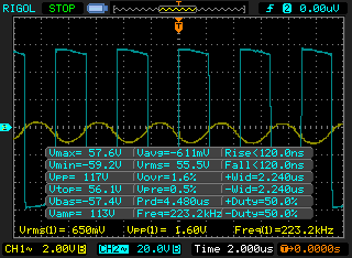

RM10 with airgap for amp. There are from old power supply.
I have to make more tests, for now it looks good.
24vdc
5ohms load
24W output
Oscillating at 150KHz
YouTube - firtst test audio amp d
I hope get about 200W with this board.
24vdc
5ohms load
24W output
150k is too low for full range audio
Yes.It´s slow , I´m working on.
It has gone up to 230KHz with other version and inductor cores.
I have the t106-2 core at 11uH , other core at30uH , other inductor 22uH .
The capacitor is at 1uF , other version it has 1.5uF
The smd version has 30uH inductor,1uF capacitor.

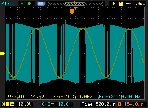

Now i got 45Watts at clippling limit at 20vdc with 5ohms load.
Vrms=14.8
R=5ohms
P= (V*V) / R
Vrms=14.8
R=5ohms
P= (V*V) / R
