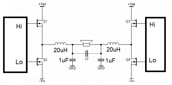

I have one question!?
In full bridge desing, in this situation, which will be value for Cf capacitor?!
And is my amp good if it has 250KHz swich freq.
It depends on whether you use AD or BD modulation. If you bridge these two modules then you don't need additional Cf. If you redesing it to full-bridge, wuth AD modulation, then you can add Cf. For more details, see this link http://focus.ti.com/lit/an/sloa119a/sloa119a.pdf
Thank you lacy!

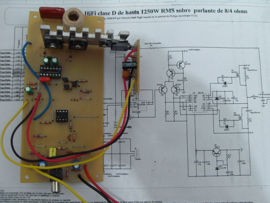

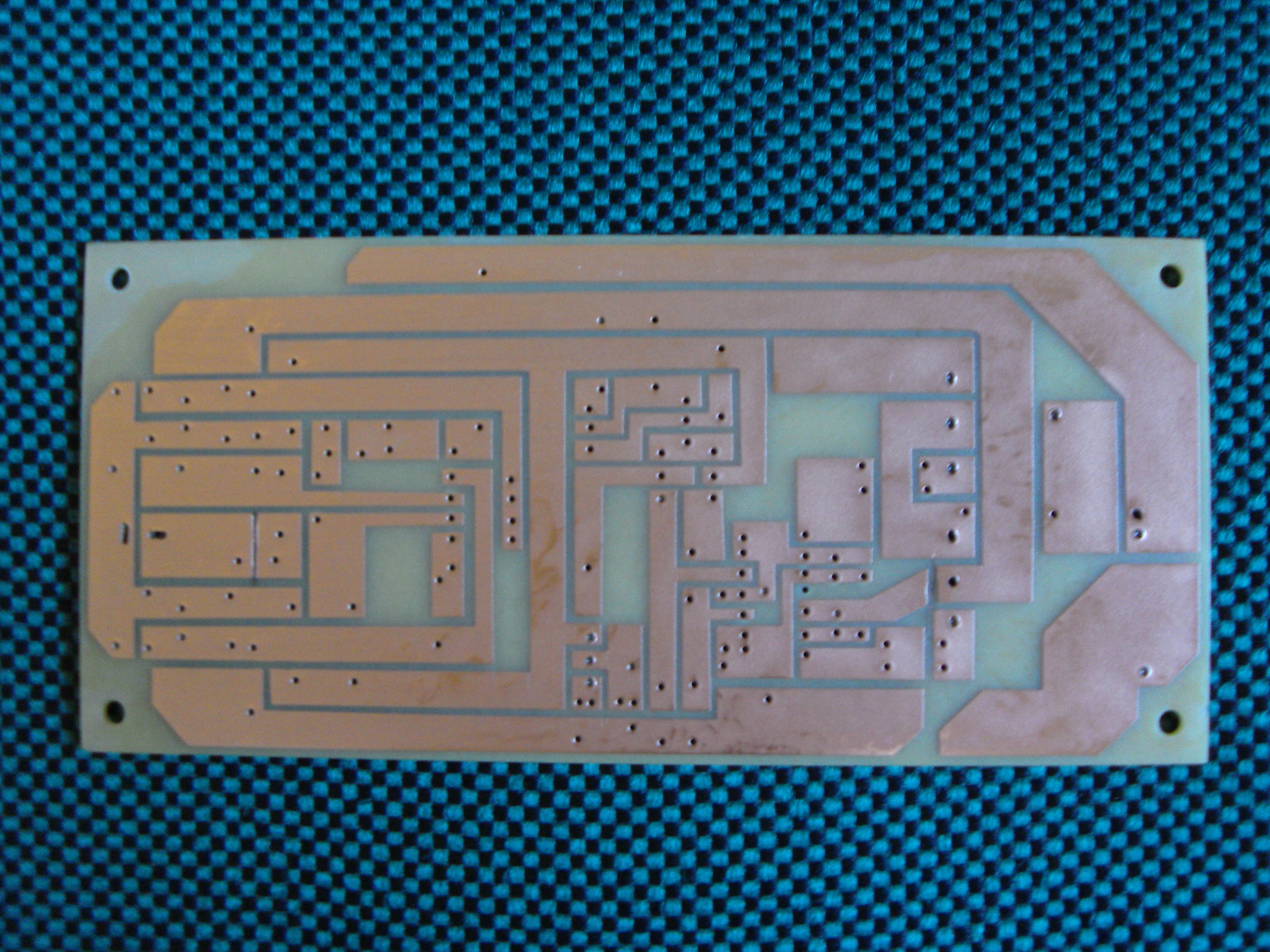

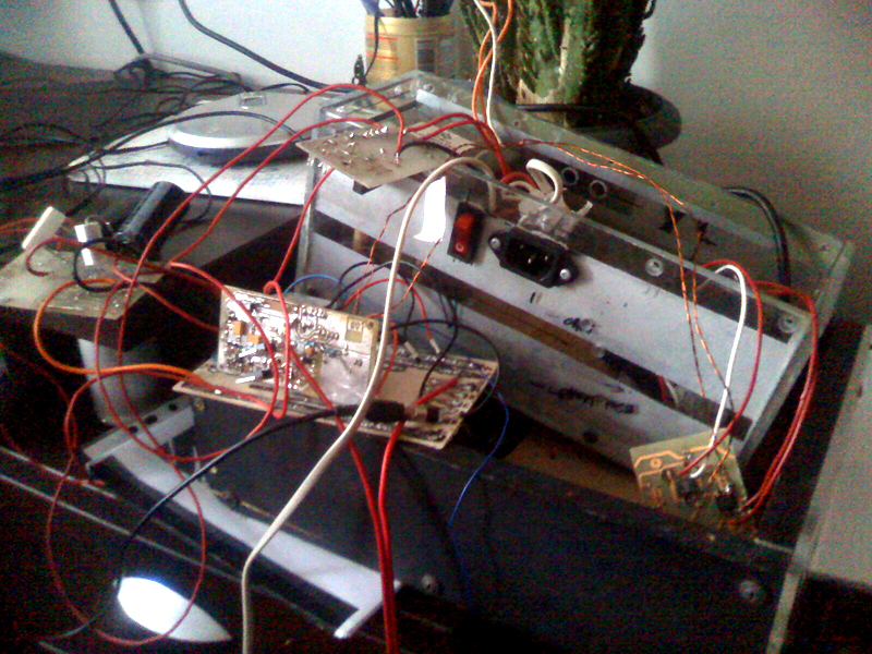

UCD don't work
Dears DZONY988, LORYLACI, NMOS
My plans are link/archive in the page 2 this forum.
When the UCD is no IR2110 and FETs (only /LM311N and 2N5401) I connect to RCA input a audio signal from my CD player and there is PWM signal from LM311N, perfect!
Also, in the COLECTORs of 2N5401, no problem.
The "crash" happen when it's IR2110 (no fake) and FETs in the place.. terrible!!
Now, I do another test with FQA11N90 but when I switch on the AMP only the 2N5401 (Q1) blowed.
I don 't connect the power supply directly to 120ACV, I use a interconnection series-lamp (40W) but the devices are burned too.
There is not any mistake, I look all many times.
I build very very SMPS and I know so much the IR2110 mosfet driver but the only thing that in my mind is maybe the DEAD TIME is so short and damage this devices..
I post here some pictures for you.
Thank by comments.
Sandro

You are mistaken... :eek:
This is an UcD amp, so if you take IR2110 out there should not be oscillation, so there is no PWM at LM311 output. That's not a PWM you are talking about, thats only the compared signal, it has nothing to do with PWM. Check it with an oscilloscope, it wont be at arond n*100kHz.
Connect the two main supply lines to the board with 20-100 Ohm 5W resistor (i use 47 Ohm 5W for this), it willl protect the fets in case of cross-conduction.
What is you supply voltage?
I'd also improve the PCB design, yours is far from optimal, even the original PCB design is better.
And why are you using 5W resistors for gate drive? 0,25W should be enough, and they seems to be wire-wound resistors (with high parasitic inductances), change them to cheap carbon film or metal film at once!

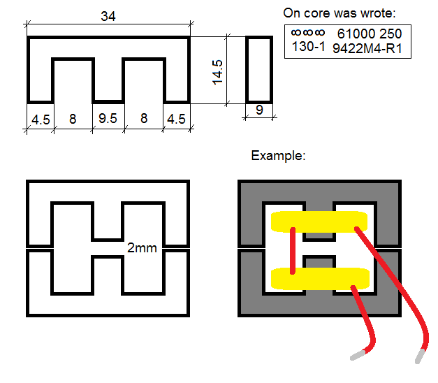

@Laci
Laci I need your help! :)
I need for tomorow evening amplifier urgently(+-70V). I found ferrite core (on the picture) with this dimensions, I dont know what is it and material number but very carefully with grinder I maked 2x1mm gap, and now I have 2mm gap and on exaple picture I drew how i want to put the wire.
I dont know how meny turns that i need for 20-22uH. Pleas help.
Thank you
