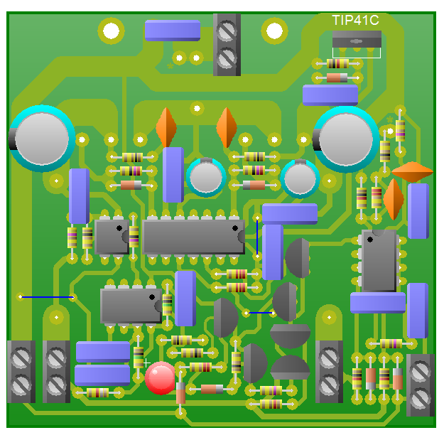

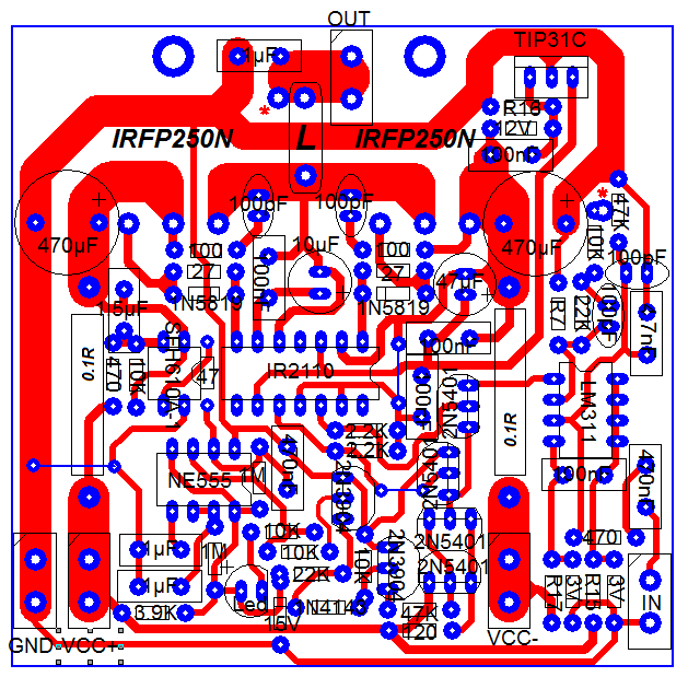

I make PCB from NMOS schematic. Its small (7,2 x 7.5cm). On board i dont have input limiter and DC protection becase I have it. Output filter will have a little long "legs" (1.5cm) for conection with the board.

About short curcuit protection and over load protection with NE555 and optocoupler, for other supplay voltage is important voltage drop on 0.1 ohm resistor on main positiv supplay rail.
In original schematic, autor say: +-80V 4 ohms load, around 800W of output power and we need power supplay of 20A (2x10A on positiv and negativ reil).
- On example, 10A shall be our limit.
With 10A curent, resistor of 0.1ohm will have 1V voltage drop. and this is now inportant.
-So, to have the same voltage drop on +-60V (limt is +-57V) we need higher resistance of 0,1 ohm.
So autor say +-57V 14.3A on 4 ohms load.
14.3A / 2 = 7.15A
R= 1V / 7,15A = 0.139 ohms. It means 2 resistor of 0.27 ohms in parallel.
Is this corect?
Thank you

Attachment latest UCD PCB 157 * 80 mm, looks small and nice now....
and have remove 1uf cab from coil to negative rail
...dont like firework after first test PCB

NMOS: I have some doubths about this protection. Of course it can work, but:
- The shunt is before caps. The energy stored in caps can be enough, if theres a quick short on output, to kill them, before overcurrent trips.
- 0,1 Ohm shunts are pretty high. Its against the conpect of class-D. The disspiation in this shunt will be higher, than in the IRFP250Ns.
- It still only senses one side.
- Why an NE555? The optocouiple could set SD pin of IR2110 to high, turning it off.
Look at Dzony's PCB design. On first look it looks much better. Your PCB still looks like Class-B stuff. You need a concept change.
I don't like limiters. In my opinion, they do more harm than good.
ok which value would you recommend for +/- 85V DC Rail, have +/- 85V DC SMPS from defectice PA Amp
In like improvement, but its first time for me with Class D
can you provide schematic how to turning off SD pin in overcurrent situation ?
do you have working circuit for overcurrent situation to adapt ?
have found circuit for UCD Bridge Amp with LM311 Protection and only Shunt senses one side too, is this better protection compare to NE555 with opto coupler

Guys, I'd really recommend to redo the layout with double sided PCB with proper grounding.
Also the basic current loops on the PCB are far from optimum.
There's a good reason for IR2110 to have 2 "ground" connections, take advantage of that.
Why waste so much effort you've had here with sub optimum layout anyway?

please give us sample for optimum Class D ayout, have only experience with Class AB
NMOS:
I would not reccomend this protection. An opto needs ~1,5V to turn on. So resistor value is: R=1,5V/Itrip (the overcurrent treshold), losses are P=1,5/Itrip*I^2. The way it is put can be more simple (the transitor of the opto connects SD to IR2110 supply, with a pull-down resistor to Vn), and more effective (put it after the caps, both lines), just think a bit. A change from an opto to a transitor (0,7V turn on), halfs the losses. Using comparators (treshold voltages can be much less), cuts the losses to minimal.
Why would you choose class d with minimal losses, when the losses of every other part in the schematics (TIP31, making +-3V from +-85V, shunt...) is much greater than the losses from the main FETs.
There are lot of samples, just read AN-1135 "PCB Layout with IR Class D Audio Gate Drivers", AN-1138... Mine needs lot of improvements too (I still have a lot to learn), but the problem with your design, NMOS, is that you still design it as a Class-B amp. Dzony did much better with even a one-sided board. A said lots of times, that if you have double sided PCB, use up ALL the empty space for planes (see AN-1135), and easy heatsinking of the FETS (putting them right to the side of the board) should not be the first priority. With good fets and good design, a simple few-inch Al profile does the job.
I forgot 470 ohm resistor beetwen pin 1 and pin 4 of LM311N
In .zip file you have changed layout with this resistor and pcb.
Conect two stars with short wire like "big" jumepr (this is your feedback)
Check board one more time before, if you find any error, tell me how I can fix it.

A good PCB comes from understanding some basic principles.
A short remainder:
1. Current always flows in loops (kirhchoff's law)
2. Inductance of the loop is mainly dependant of the geometric area. You may understand a loop as a single turn solenoid, a big loop has pretty some inductance and open flux, I mean it becomes an antenna
3. If return current flows through a bottom layer plane, it flows directly under the signal on the top layer trace because of proximity effect. Therefore current loops related to bottom layer plane have minimum areas and all the inductances are reduced to absolute minimum.
4. Why we want to reduce inductance is because it creates resonant circuits with capacitances. When you get a resonance the way to kill it is by resistance (manipulating Q factor)
5. 10mm of a trace on FR4 board over a return plane has around 10nH.
6. TO220 mosfets have internal inductances of around 5 to 8nH, TO247 are much worse.
7. Control loops (gate driving) must be traced separate from power loops, whch exhibit high di/dt.
8. SMD parts have much lower inductances, this is ecpecially important for capacitors.

Hello, have redesign PCB, please check it, on TOP Layer have big GND
is it ok now ?
