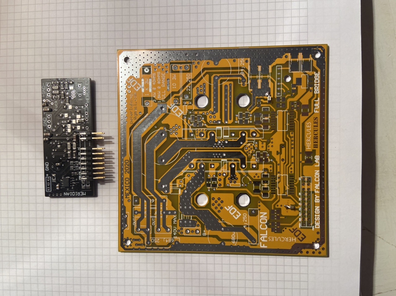

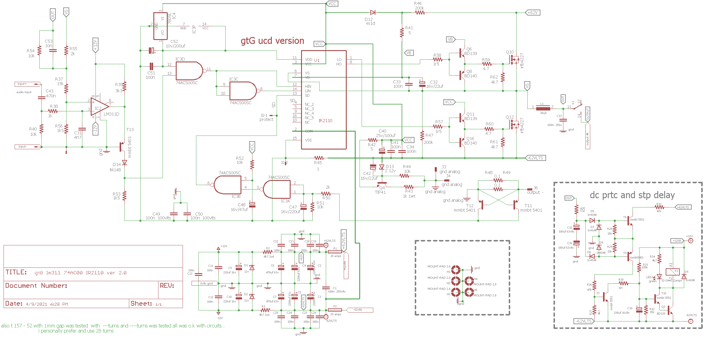

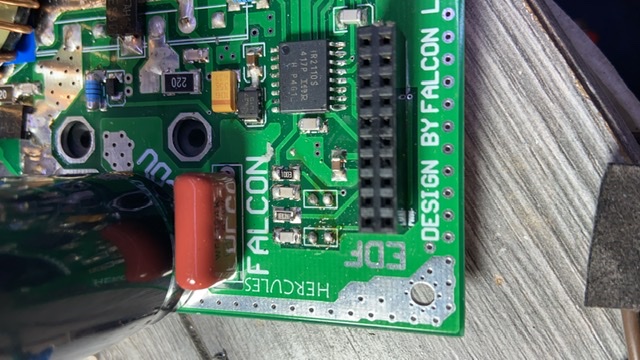

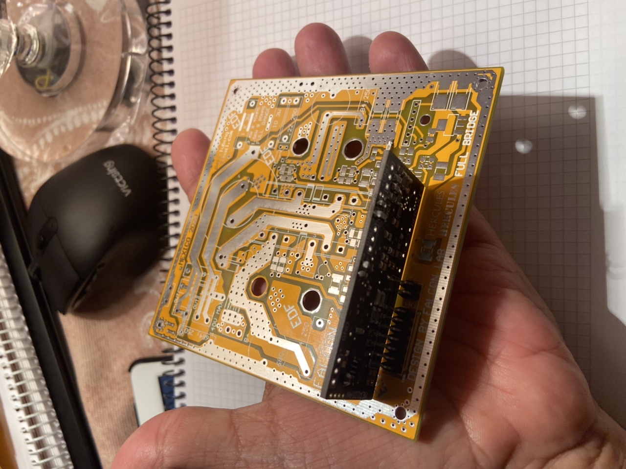

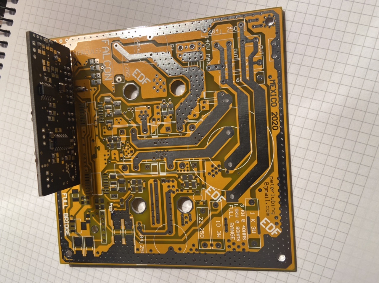

UCD 25 watts to 1200 watts using 2 mosfets
the project advances, already corrected some faults in the PCB, ready to do a few more, the small card is a modulator / demodulator with balanced input and output for LO and HI for the 4 mosfets, but the main card can be UCD, DELTA SIGMA auto oscillating, or double feedback, post filter and pre-filter feedback, basically universal, I will soon post the PCB and schematics only of the main board and the UCD and delta sigma versions.

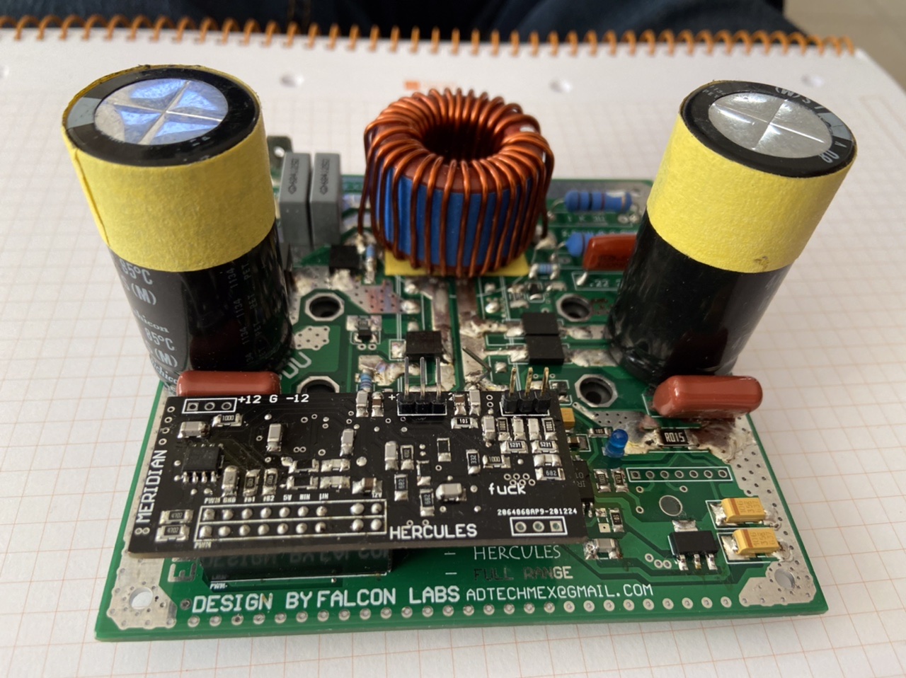

The evolution
Advances in the project ........ 1,800 RMS .008 DHT + noise etc you would need to hear it, it is wonderful, only unipolar source from 40 VDC to 140 vdc

the lm311 post and pre feedback project is coming up......
any opinions and comments are appreciated.
