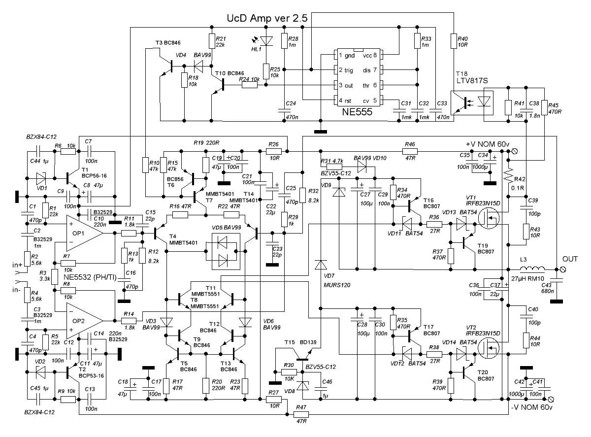

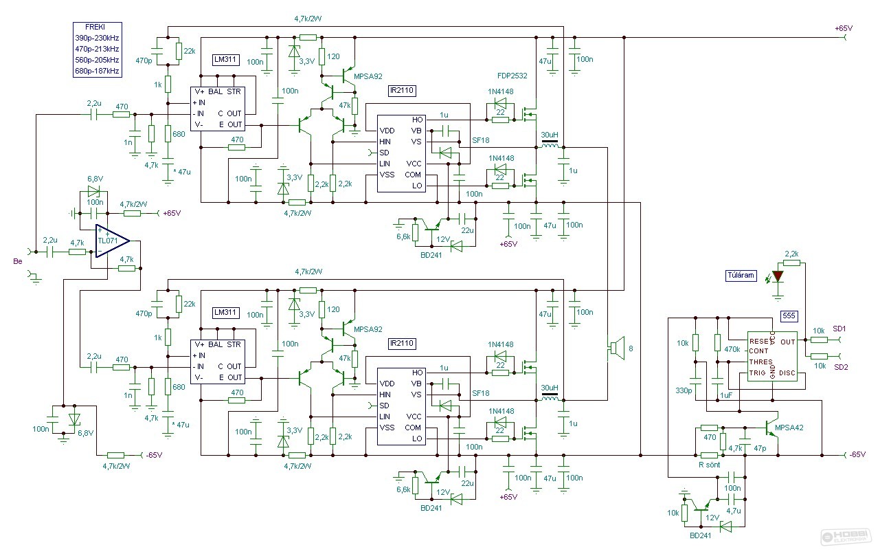

when one channel is working alone all is well .but at times when using multiple class d channels whether in same enclosure or different casings with different power supplies;( by the way in all my amplifiers i was using smps)
and load is normal 4ohms or 8ohms also the signal was too low and no much power was being required from the amps . there will be a faint hissing sound , then bang :confused::headbash::irked::bomb: one channel has just failed but some times same setup and same amps. then the amps performs flawless and no issues very cold and load and circumstances are same as other times failed. .all cases were ucd or sigma voltages +/-55 and above. ir2110 versions and discreet versions

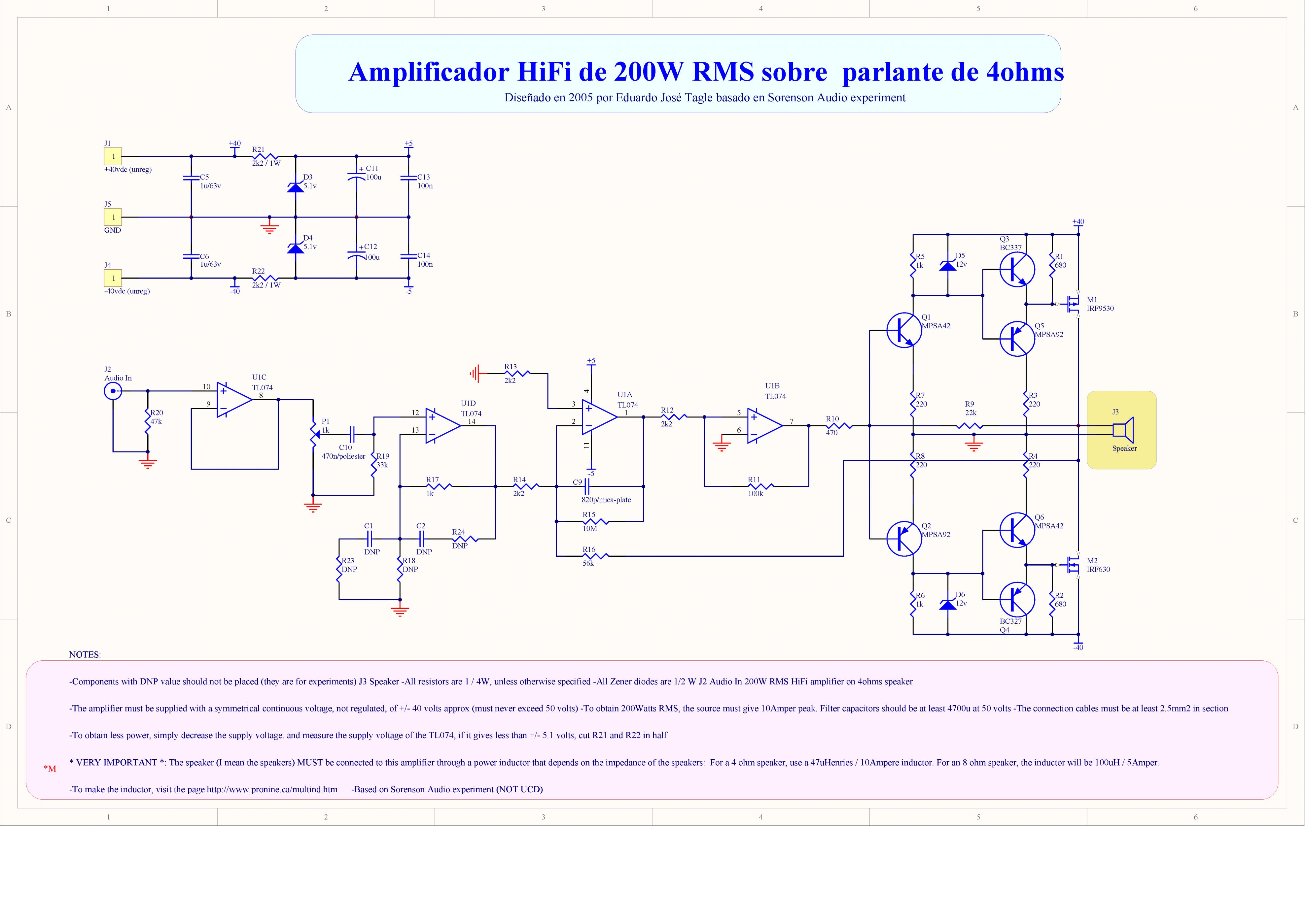

the only multi channel class d which stood the test of time without issues was sigma delta hifi tlo74 classd 200watts . i did it with single power supply smps supplying 5 channels and dual power supply smps supplying 5 channels and it did not misbehave or fail for no reason like the above high voltage class d . maxx voltage i have ever used successfully on class d 200wt was +/-49volts.

I think for help you should provide schematics from failed amps

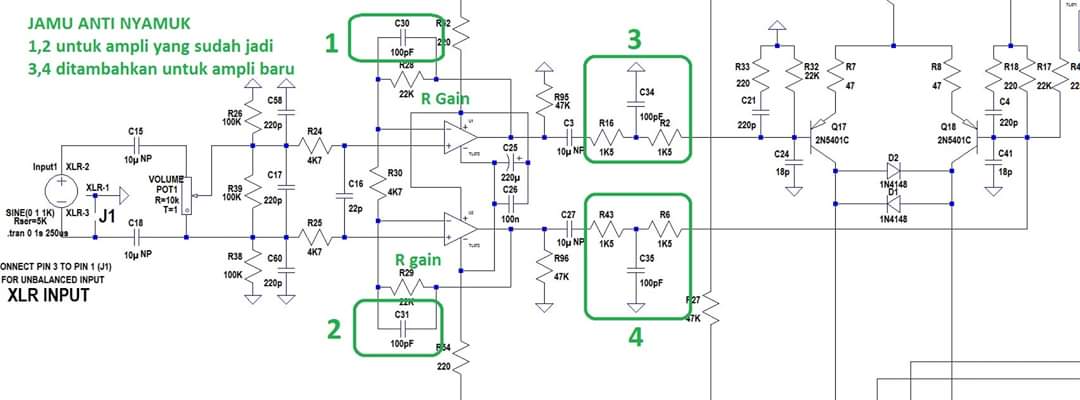

For hiss noise you can add input buffer like mine. Add cap bypass as marked as below picture. If buffer already there just add the caps.

The hissing sounds is not from interference each other channel but this is specific case for UcD. It is leaked PWM from backside and captured by op amp buffer circuit accumulated from leaked very high speed PWM become sound frequency area.
So by bypassing this leaked frequency will kill the hissing sound.
