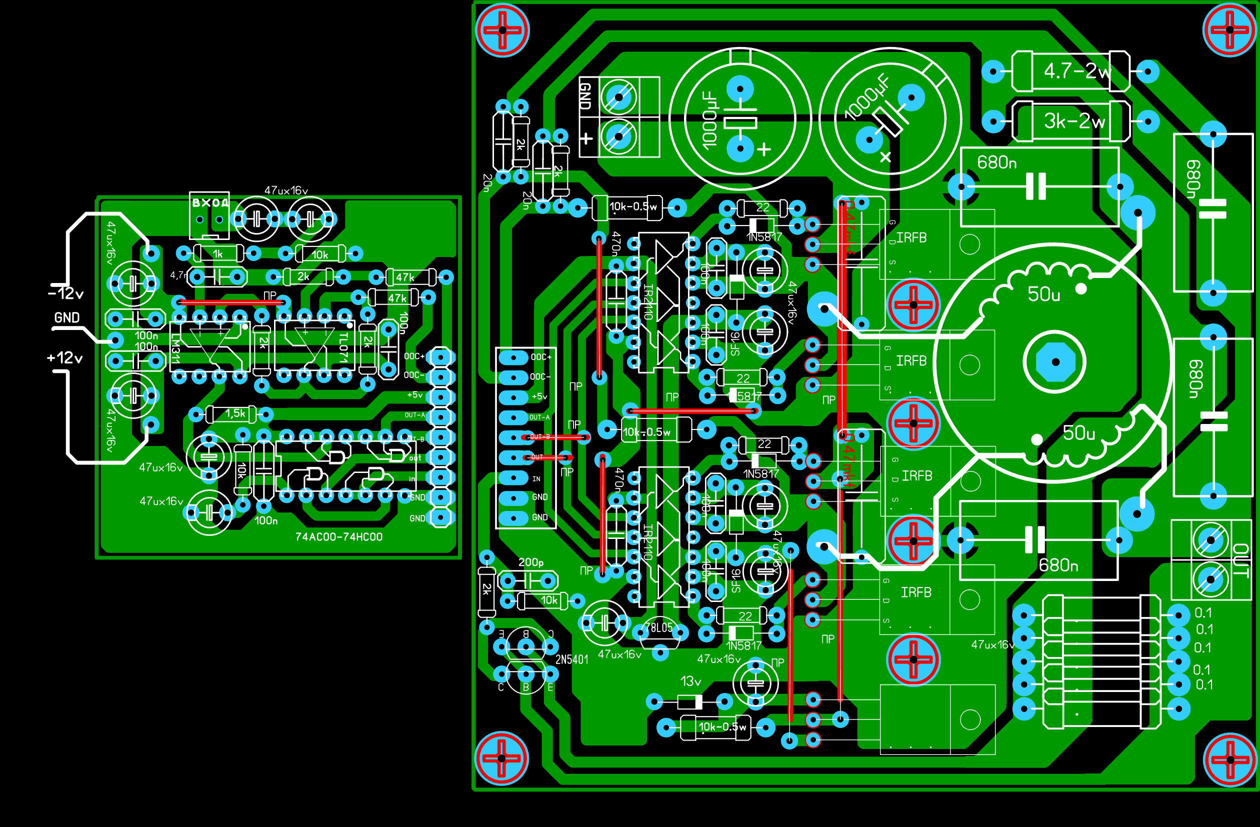

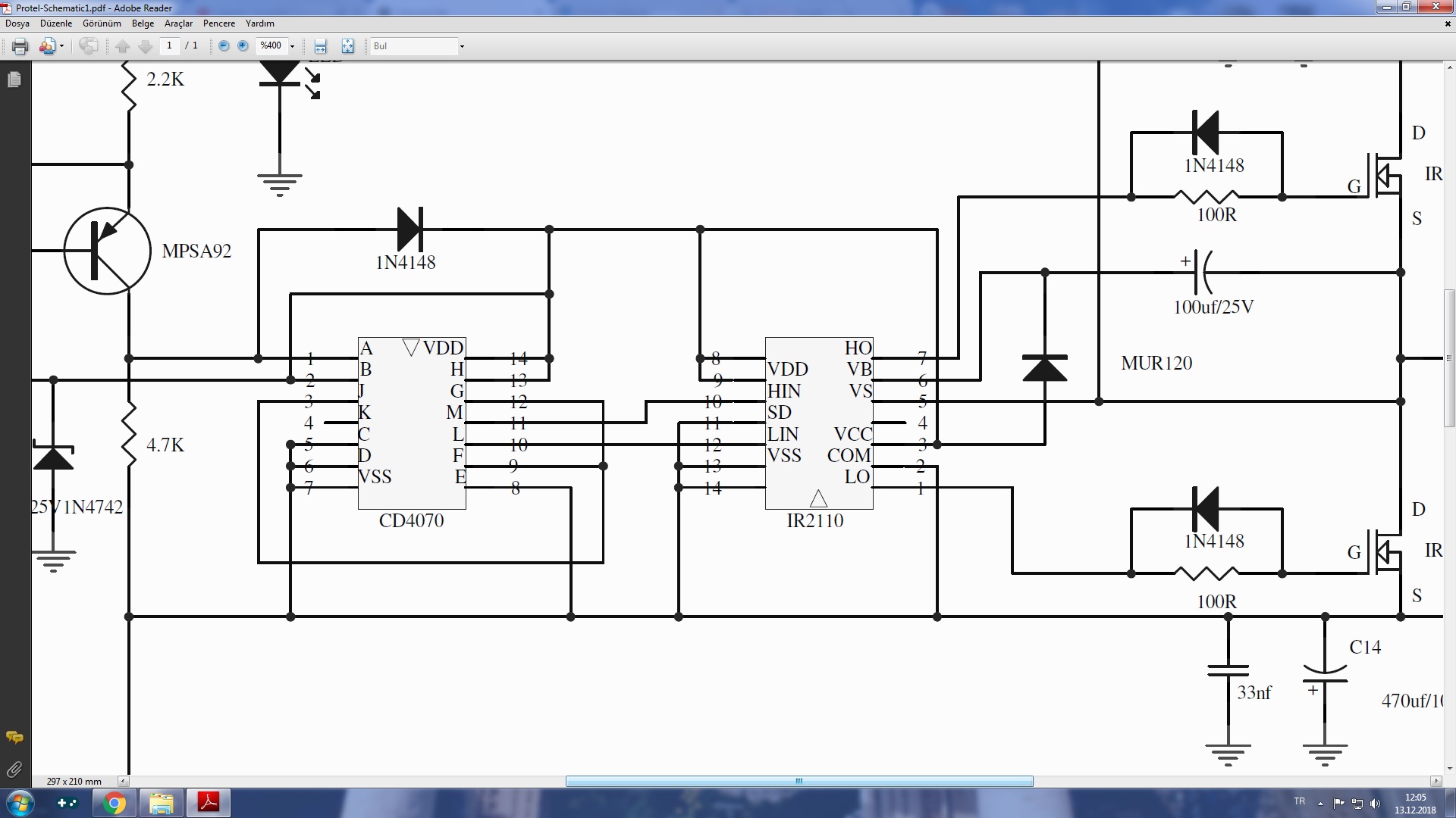

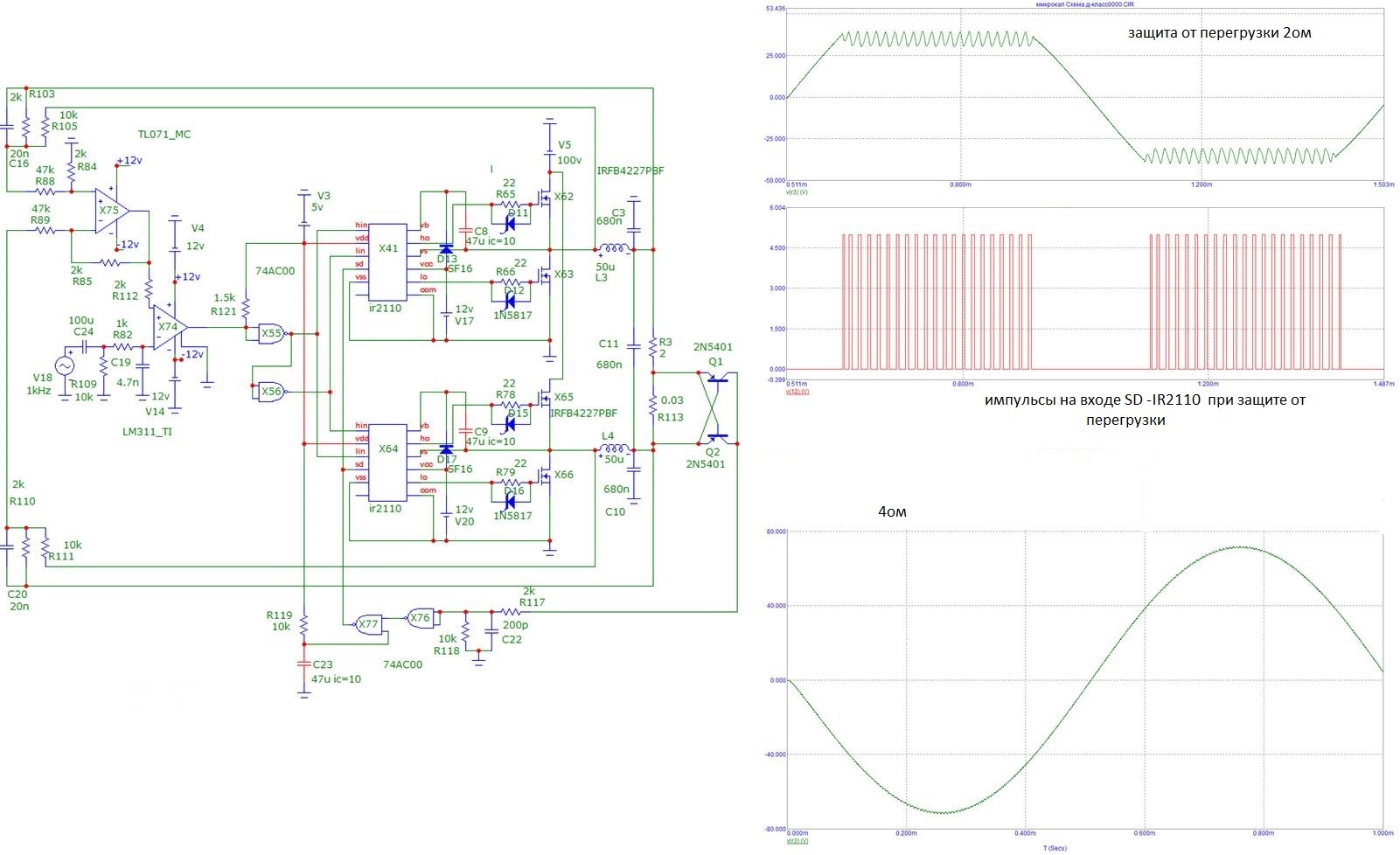

hello to friends .. This circuit came to me. The top logic integrated has been deleted. I suspect that cd4070 or 74hc00 .. I could not simulate the scheme. But the scheme is strong. Can you simulate and try? I didn't work at the PCB. The ir2112 will be ir2110-ir2113 instead. The Mosfets 30n40-irfp260. 163 degrees to the coil. It came to me very high value but it does not work like .. 27k resistance 2 w. 1k + 1k resistance. 2 w. 5,6k resistors 3w. D5 mur160

The final circuit is 163 degrees at last. I guess it's worth the load too .. 22UH-33UH NOT be worth being? Door resistors 100 ohms. This value is not high either? And in the above pdf file, I fixed my connection to the hi-low outputs. I also fixed the R7 bracket in the wrong place and corrected it.

I could not run the enclosed circuit. Who can help for this circuit? Really good work
schematic please, if no have noboday can and want help
If no have please redesign schematic, software easy to find,....often freeware
with schematic we can try and help
Please note: sometimes PCB have design mistakes and not corrected
schematic too
