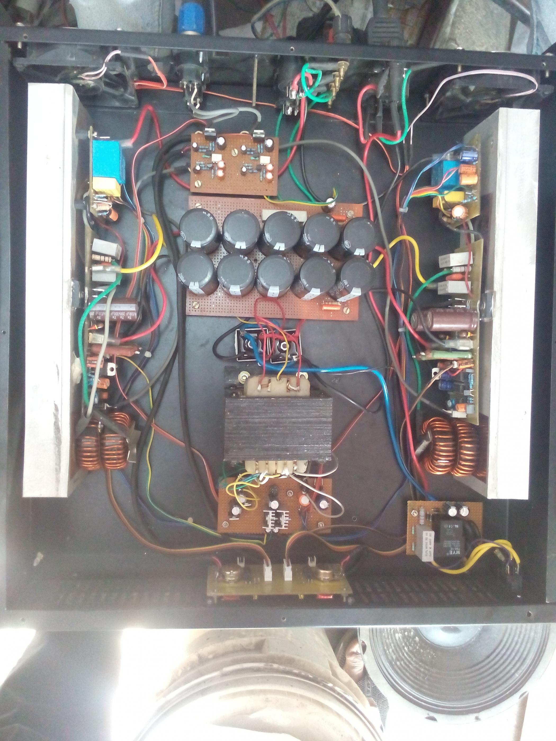

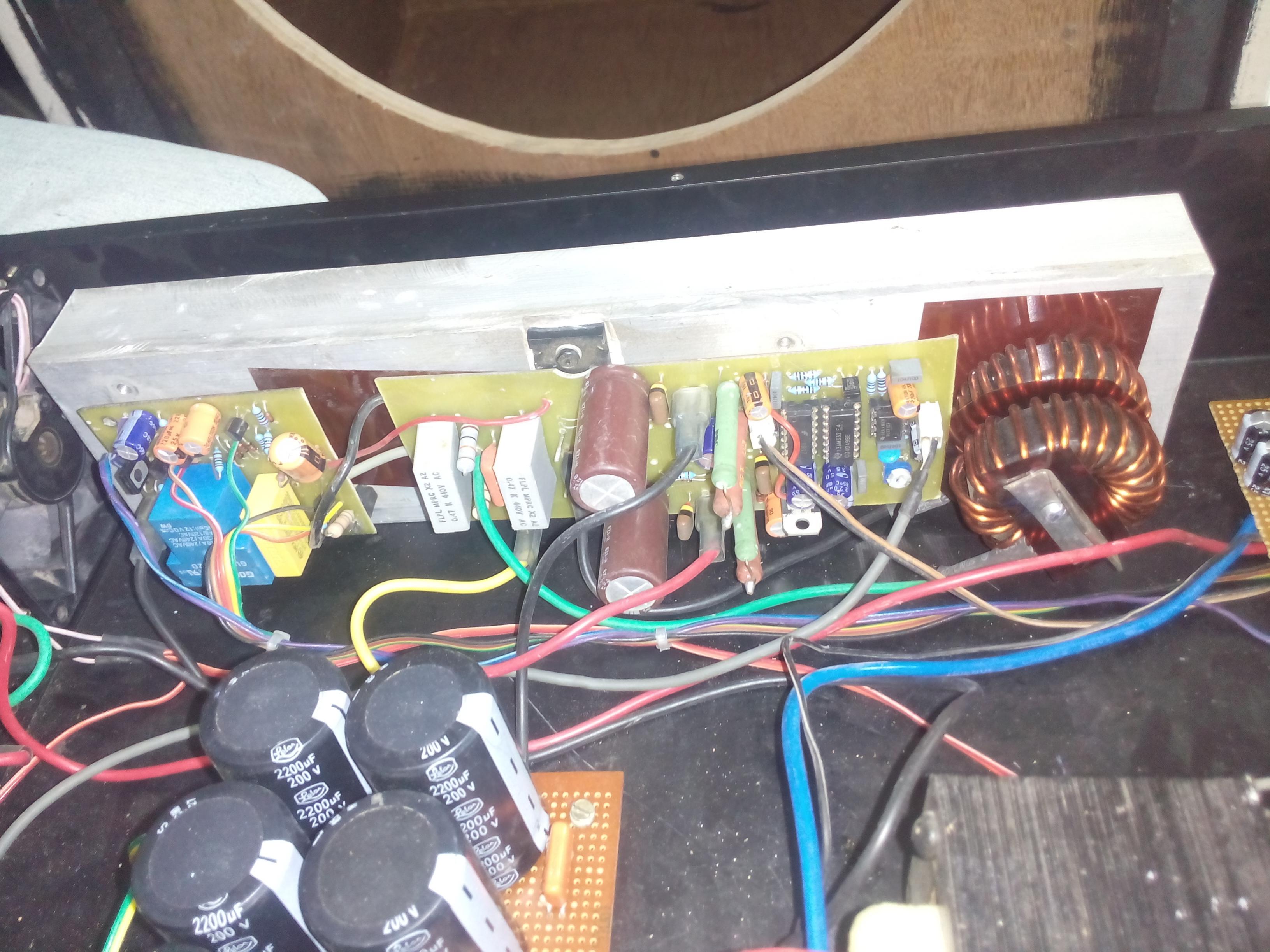

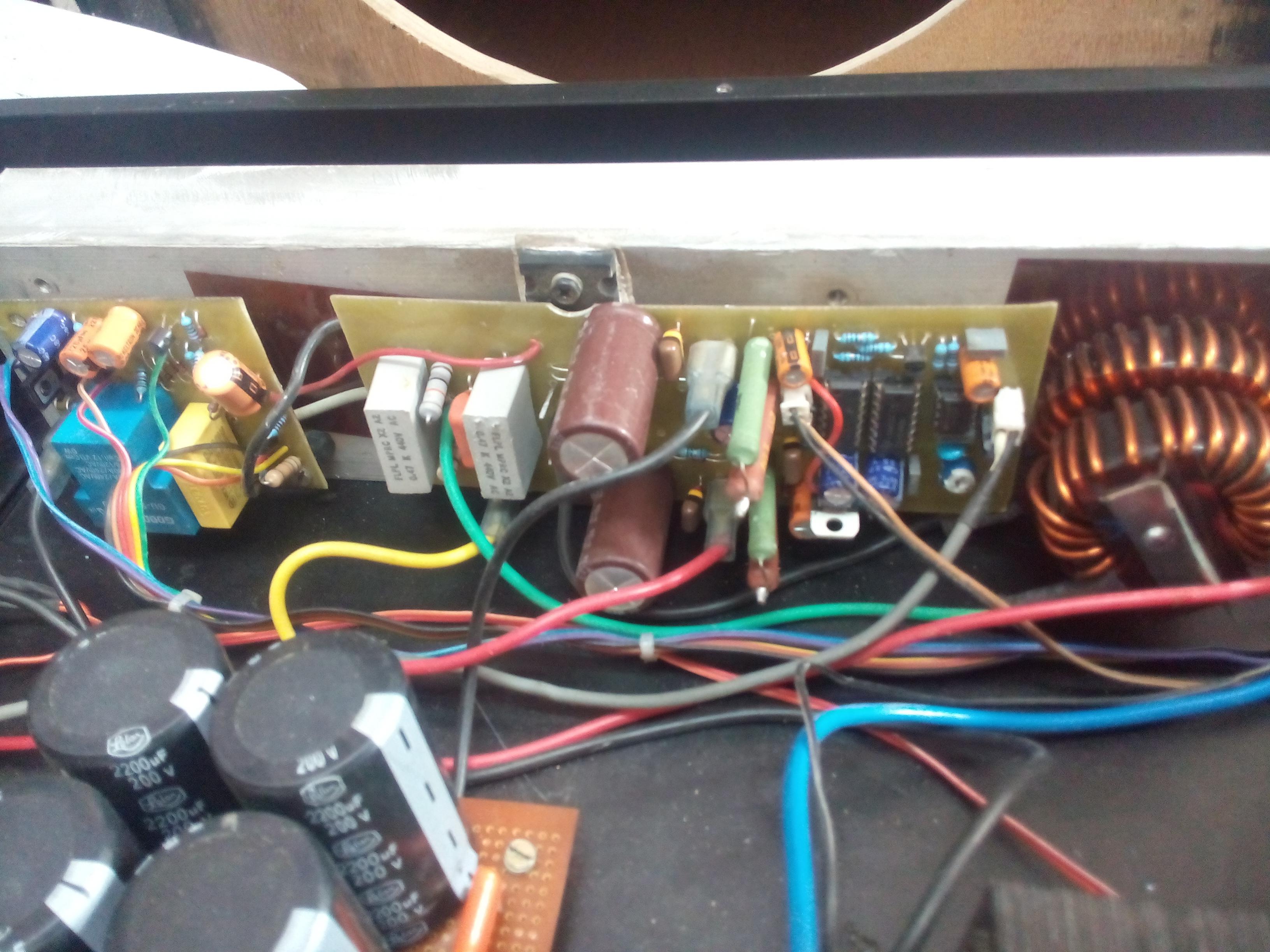

My class D DC8000

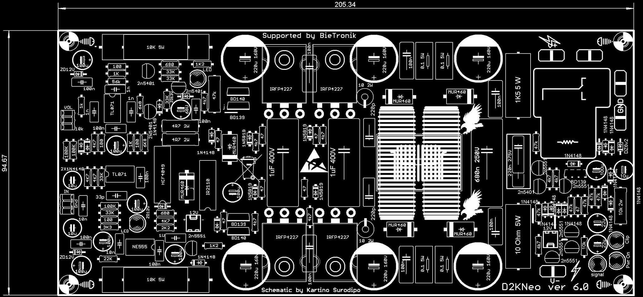

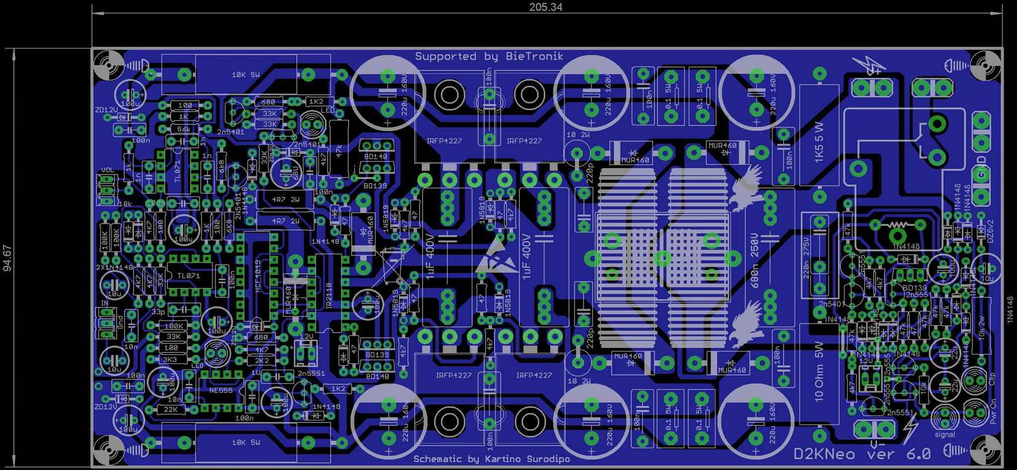

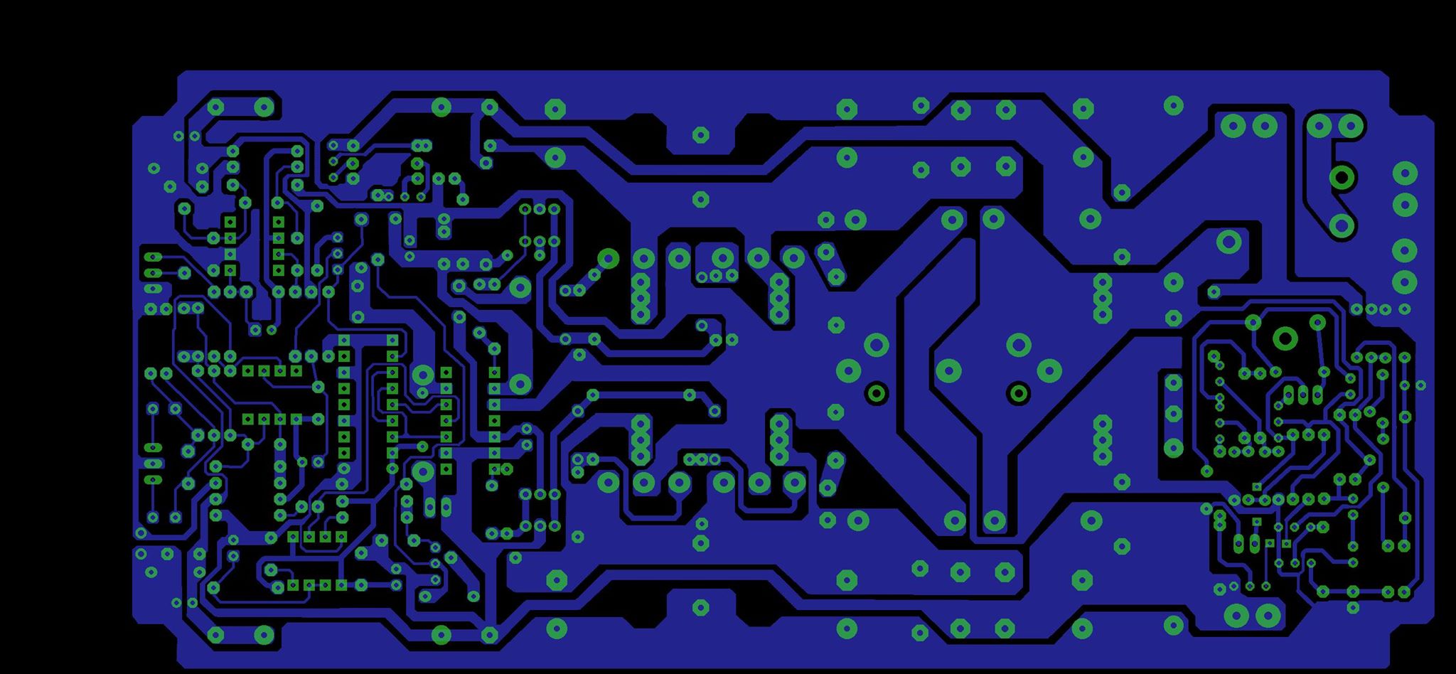

This is my Schematics D2KNeo and PCB picture. Just to give you idea, of maybe redraw from this picture. 2 sets mosfet Class D. I cannot give PDF of layout. You cannot just simply move this picture as some tracks are optimized to get very less capacitance hence as small as possible for small signal. Just give you idea.
