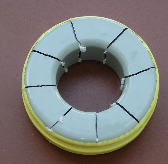

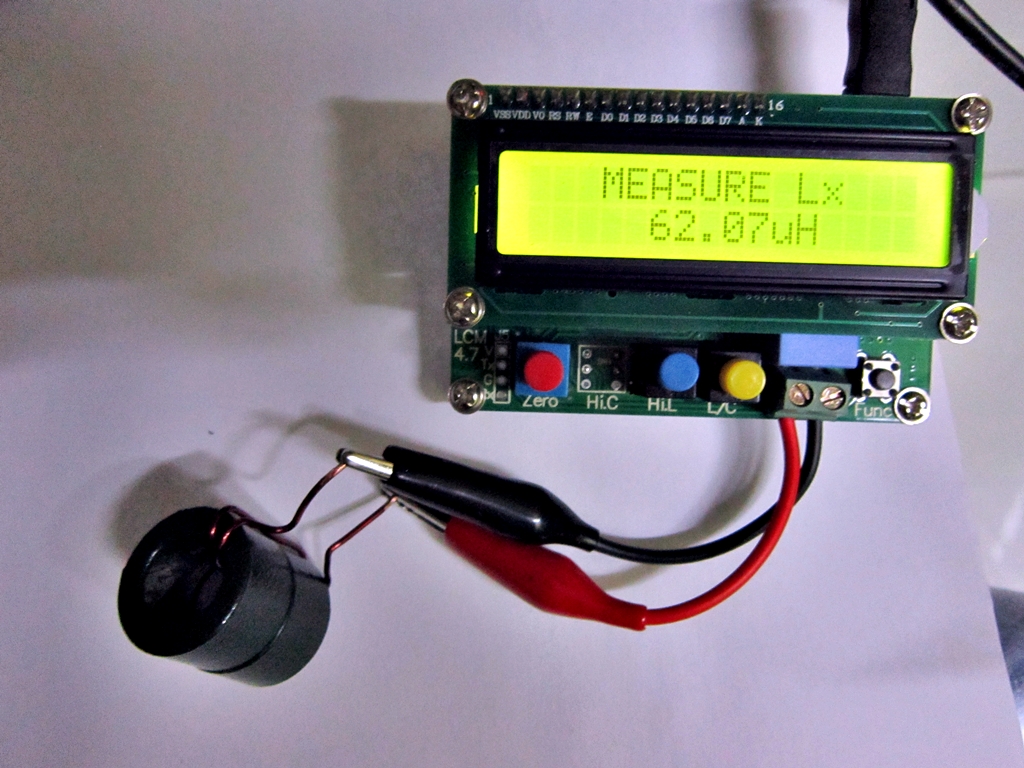

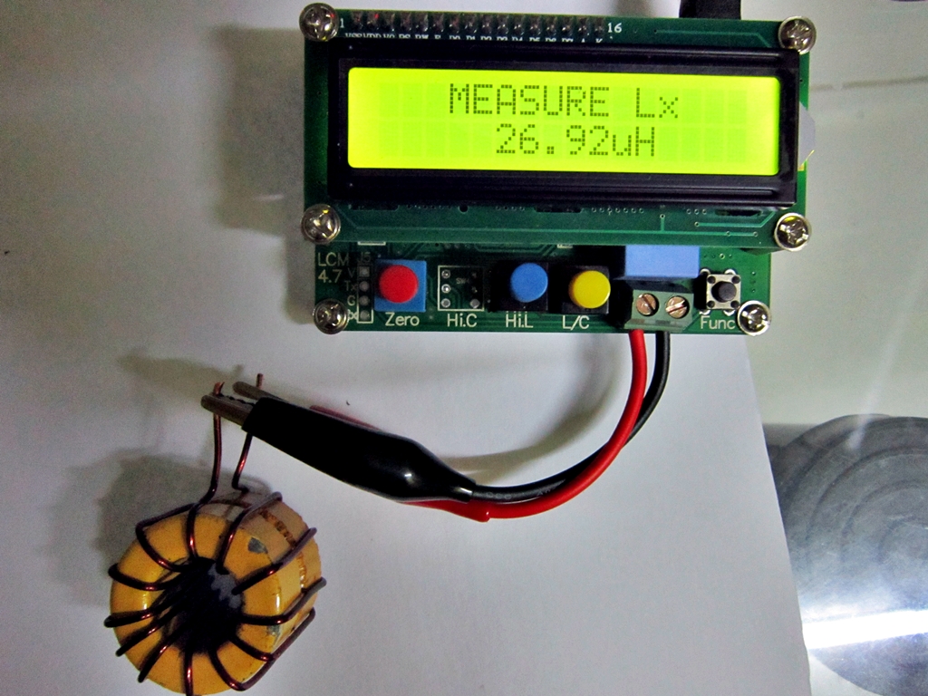

I have this green toroid, but has unusually high value of inductance, in the picture it only takes one turn to make a 64uH value, 4 turns in this toroid has a value of 500uH!
Can I use this with any class D amp?
I have another yellow toroid from computer smps, I'll just make a gap to make it usable.
On the picture I see 2 turns and 2 cores together. Al=64000nH/2/4=8000 nH/turns^2 It's ferrite. If you can break it into 4 symmetrical quarters, and insert 4*0.4 mm air gap, it can be a good core for output inductor.
Yellow toroid is very bad, gapping makes it somewhat better, but not good.
