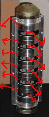

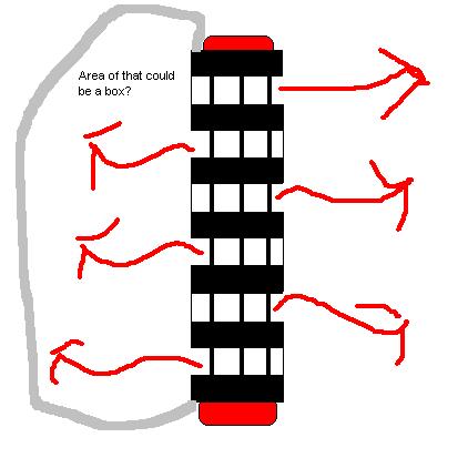

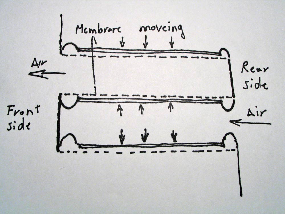

If this LAT is fudged as mentioned earlier in the thread by gluing speakers back to back is it not then, with six speakers, a stacked or three cylinder if you like ripole with the open back of the ripole working into a sealed, or possibly reflex cabinet. The only difference I can see between the fudged version and the real LAT is the greater number of motors. The cost of the connecting mechanism and the frame and seals could well cost more that the extra motors. I have always seen the two speaker ripole as more or less a large single pleat Heil anway. The way the air is moved, by squeezing, seems to be the same principle that Heil once advertised.

The design of the LAT looks to me to be the most straightforward one although I am curious as to how the sealing around the push rods works.

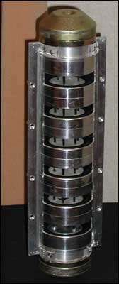

couldnt finish it i was missing screws for the front.
and didn't have the time to finish the box,well painting it that is.
but should be working in 2 days.
the concept relies only on 2 magnets,the reason why it hasn't hit the market it's because they didnt' have any ready yet.
what i'm holding is a prototype made of aluminium,the others will be made of "plastic".
I feel confident that there should be good.:)
so anyone tried it yet ?
really interested to know how this toy performs..
