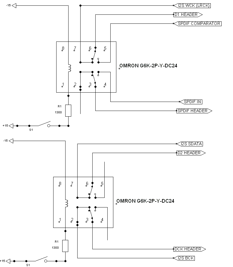

Question about I2S and SPDIF
Hi guys:
I have both I2S and SPDIF sources and want to design the cleanest input switching scheme. I think I can make use of the onboard comparator with some switching. I will use the cute little Thumpbuster relays, or may purchase an Otto.
If I understand correctly, the SPDIF input header is connected to a comparator and the little SPST switch connects the output of the comparator to the D1 input.
Is that correct?
In my idea, one switch will select the SPDIF input and connect it to the SPDIF header input.
Another switch will connect to the D1 header input and select either the I2S source or the output of the SPDIF comparator.
Other switches will disconnect the remaining I2S inputs when SPDIF is selected. I assume this is necessary.
Should I2S inputs be grounded if not used?
If this will work, which end of the SPST switch do I want?
The end closest to the input header?
Is there an easier spot to pickup the output of the comparator? I am concerned about tacking a wire onto the solder pads of that SPST.
I think the attached schematic will work. With both relays OFF, I2S is selected. Both relays ON, the SPDIF input is selected and the I2S inputs are open.
