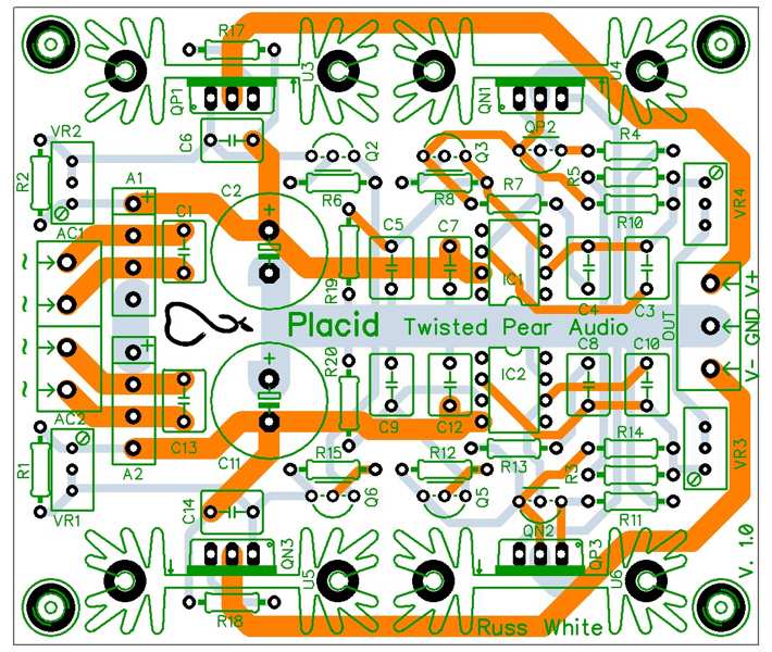

They look bigger than the LCBPS. What are the dimensions? And will you offer a LCDPS equivalent as well?
[EDIT] Two sets of trimpots? Beyond my skill to work out what is going on there

Yes they are a bit bigger than LCBPS. I needed to have space for the big heatsinks and I also wanted to lay it out in a way that makes it possible to mount directly to a metal case allowing the case itself to be the heatsink.
3" x 3.5"

The two pots will be pretty easy to understand with the manual.
One sets the current through the CCS (this will effect maximum output current).
One sets the output voltage.
The practical range for this PS is ~ +/-3.3V to 20V or so. I am not sure on the top end yet.

Russ White said:Hey folks,
New placid adjustable shunt regulating power supply boards have been ordered for testing. I should have them in a couple of weeks.
I will let you know how it goes.
Cheers!
Russ

Beefy said:... And will you offer a LCDPS equivalent as well? ...
If the two GNDs were not common, and a 4 instead of a 3-output connector were used, the board would be more universal. By not joining the two GNDs at the board level, you may also gain more freedom to avoid ground loops. And you would only need a single board in your inventory. Preferably, this could of course also be an LCDPS. By appropriate connection of the output voltages, you could use the board to supply either bipolar or dual supply needs.
Is there a possibility to further expand the output connector with Kelvin sense pins? Maybe in a next revision?
Kurt
Kurt
Hi Kurt, I took a different approach here. This is a truly complimentary circuit. Not just two regulators in series as I had said was (and is) possible.
There will be a smaller single supply that can be used where you would use LCDPS. I just decided to do the bipolar version first.
Kelvin sense is possible, but I have found it not especially effective especially if the wiring is short.

Russ White said:
... Kelvin sense is possible, but I have found it not especially effective especially if the wiring is short ....
Russ, I fully agree as long as the wiring is indeed short. Also, it is my understanding that to do the Kelvin sensing right, you will actually need two sense wires. My thoughts were that the sensing might allow you to put everything related to power supply stuff on one side of the chassis and all the analog stuff on the other side, which could result in somewhat long wiring.
Anyway, I'm looking forward to your new supply board, and thanks for all the work you are constantly doing for the DIY-community.
Kurt
