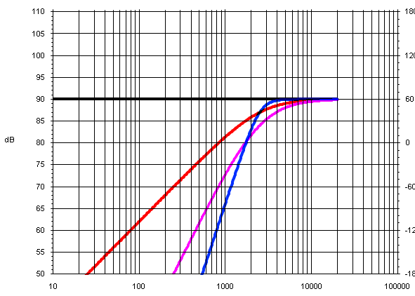

Third order high pass is often used on tweeters to keep them out of trouble. But you should probably just go with L-R at this point. You may even move the crossover point up a bit, if you think the woofer can go that high.
Also, if you are building your own, don't be afraid to spread the frequencies some. ~20% is a good start. For Example: 2300Hz low pass, 2700Hz HP. Because of the physical separation of the drivers, this often sums better.
The chart below will give you an idea of three different filter types at your 2500Hz high pass point.
Red = 1st order Butterworth Pink = 2nd order L-R, Blue = 3rd order Butterworth.
You may see from this how the L-R filter may actually protect you tweeter the best. And also see why you could still hear 700Hz with the first order.

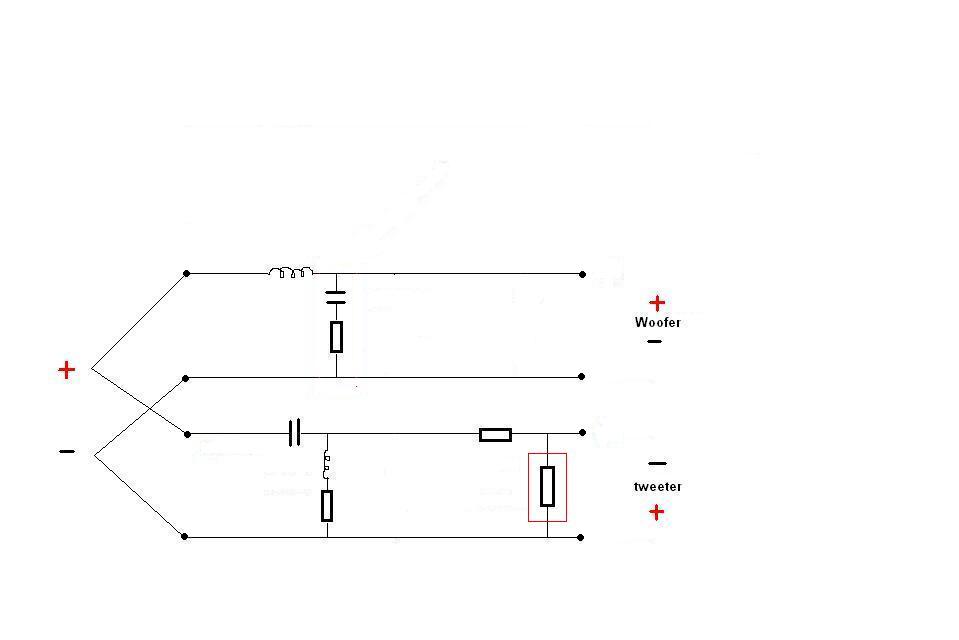

Can some double check my crossover plans please?
So after my previous thread and diagosing the problem with my tweeter as a fault with the crossover I am going to build a new one, a 2nd order linkwitz-riley. I am using THIS woofer and THIS tweeter I am going to filter the woofer at 2500Hz and the tweeter at 2000Hz. Right because of the impendence of the woofer at 2.5KHz which is 20ohm I assume this is the resistance I use in the crossover calculator and then the tweeter is just at 8ohm at 2KHz so that's easy!
I assumed this from the stuff from my toher thread I just want to check it before I order the components.

From the plot you linked to, I'd say that you should use about 1.8mH + 4uF for your low pass. That gets you pretty close to a Linkwitz-Riley end order @ 2300Hz. Only 2 parts, cap and coil.
1.5mH and 3.5uF will get you close to 3KHz, but that's pushing the driver pretty far.

Long story condensed into a too-short answer, I'd say you need a Zobel network across the woofer. This "network" would be a capacitor in series with an 8-ohm resistor - the cap would have a reactance less than 8 ohms at the crossover frequency. This makes the woofer look like an 8 ohm impedance to the crossover, at and above the crossover frequency.

maybe try to calculate woofer series inductor to set in at around 1200-1500hz
and just the zobel with cap anywhere between 4.7uf to 12uf, and the resistor 4R7 to 12R0, maybe
adjustment needed
tweeter series cap usually from 4.7uf to 6.8uf
paralel inductor usually close to 0.3mH, +/-
you may try a small series resistor on that one
all depending
and you need attenuation resistor on tweeter
I think you should try series resistor only, and adjust it

Designing great passive crossover takes a lot of experience and time. But I don't know that "great" is called for here. We can certainly come up with something better than Boscoe now has and should work just fine. He might even learn something in the process.
