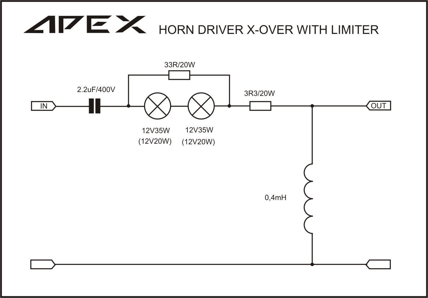

"I hv designed protection circuit with 12V 35W/35W bulb.
Calculating when PTC is tripped.
Here the bulb will become 24V 70W.
DC resistance of bulb will be 8.23 ohm.
Current at full 24 volt will be 2.91A.
Assuming the tweeter to be 50W.
Hence at 20V current will be 2.5A.
Voltage drop across bulb when 2.5A pass :
V = RI i.e. 8.23 x 2.5 = 20.57V. "
What makes you think a lightbulb is a linear resistance? There is about a 20:1 ratio.
A 70W 24V (composite) bulb will probably not protect a 2.84" Nomex former driver.
Your network will not work as the bulb resistance is so low the PTC will probably not trip.

Suggested current levels:
For 1" coils (tweeters), about 1A. The 561 or 211-2 automotive lamp has worked well in this application.
For 1-3/4" coils (1" compression drivers), about 2A. The 1156 type automotive lamp has worked well in this application.
For 3" (kapton) to 4" (nomex) coils (2" throat 16 ohm compression drivers), about 2A. I have found a 1.5A AGC (or 3AG) type fast-blow fuse will pass 400W of program material in normal use, and blow almost instantly if bad feedback is encountered. A pair of 1156 automotive lamps wired in series with each other, and then wired in parallel with the fuse will allow the show to go on when the fuse blows, and still offer some protection. If the fuse blows in the course of normal use, you need additional HF drivers, horns, and amplifiers.
For JBL 2402H, a 20W rms rating "bullet" tweeter, I assume a 561 or 211-2 lamp will be perfect protection. A parallel fuse, under 1.58A, say 1.25 or 1.0 goes in parallel. Hmmm, should i stay with 1 and not consider 1.25?
Repeating the same calculation for a JBL 2446J 16R driver, the bulbs as DJK suggest for (2" 16R) horn driver.
Now say there is is mic "feedback" and a fuse blows, can this be identified, by ear, or does the blown fuse require visual inspection?
I been trying to protect expensive tweeter and horn driver for years now. I've heard about using bulbs but never tried them, now is the time. Thanks ahead of time for any suggestions. I see the 211-2 bulbs case is similar to a fuse making mounting easy. Do I need special solder to wire 561 bulb, I read this someone in thread but now unsure?
A 211-2 is a 561 with end caps that are easy to solder, the 561 rigid loop is steel wire and difficult to solder (acid flux is usually needed).
For the 8Ω 20W JBL 2402/05 I would probably use the #1141, and if you want a parallel fuse, try a 1A or 1.25A fast blow type.
The bulbs I most often use:
#211-2 12.8V .97A
#1141 12.8V 1.44A
#1156 12.8V 2.1A
"Now say there is is mic "feedback" and a fuse blows, can this be identified, by ear, or does the blown fuse require visual inspection?"
If you are driving it to the max and blow a fuse, the bulb will give a visual indication by lighting up on the extreme peaks in the program material. If you just blow on a feedback squeal the bulb will probably not light up on normal program material.

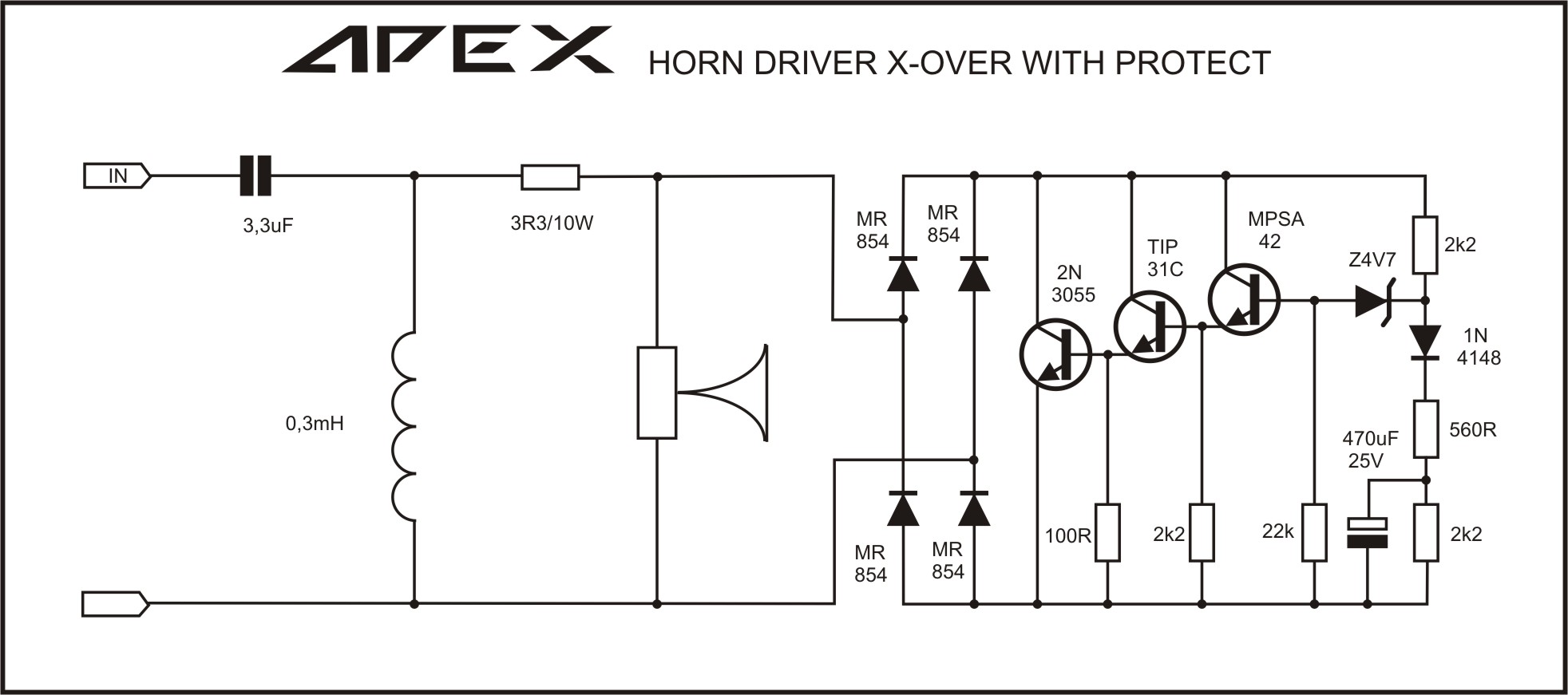

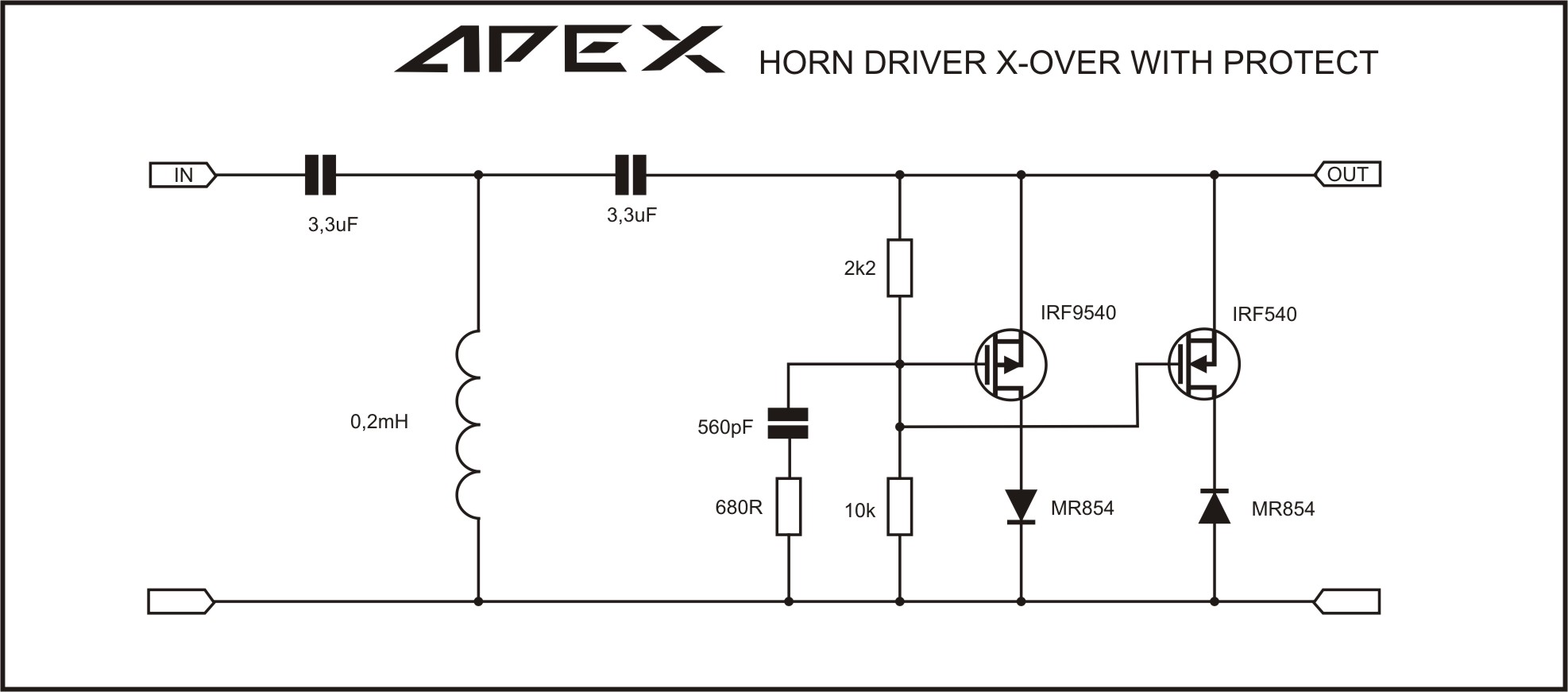

Use this circuit for protect, and level can be set with change 2k2 resistor.
