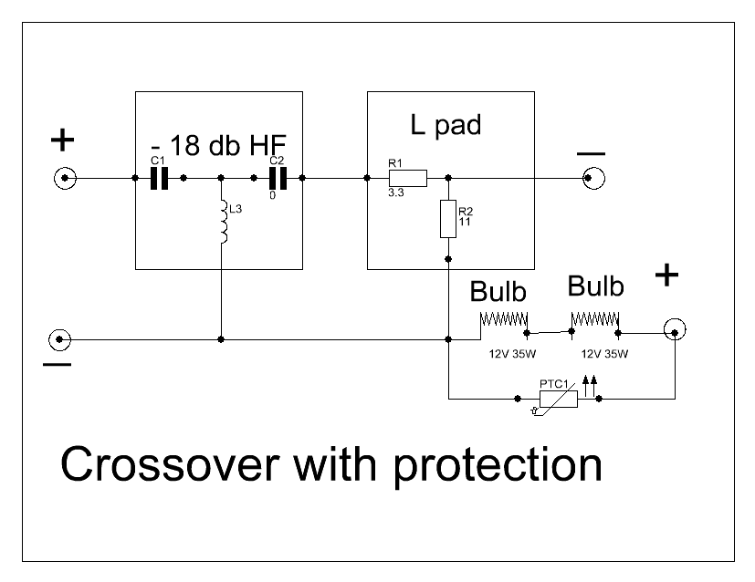

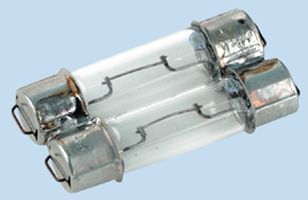

The 50W halogen bulb will offer little or no protection.
The property we are interested in in a lightbulb or protection purposes is the large increase in resistance that occurs at the nominal operating point. When cold (small signal levels) the resistance is very low, and has no real effect. Under sustained high signal levels the resistance increases and forms a voltage divider with the driver and thus offers protection. The change in resistance is on the order of 20:1, and takes tens of milliseconds to occur. This behavior allows musical transients to pass, but limits sustained overdrive in an intelligent manner (and doesn't sound horrible either).
"The lightbulb is situated as the first component in the Hi-Pass filter.
I would think that the position of the bulb before the hi-pass filter is significant."
It is both smart and not-a-good-idea at the same time.
If the crossover is connected directly to the driver it is a good idea in that if the driver or bulb opens it prevents damage to the network (if a network with a higher than 6dB slope loses its load the network drops to zero impedance at its resonant frequency, and either a cap will blow, or the inductor will burn).
If there is a pad between the network an the driver (typical as the horn is likely to be many dB louder than the woofer), the lightbulb cannot work in any sensible fashion, and must handle much more current.
Off-the-shelf networks are seldom useful, I never use them.

As for using a L pad attenuator the idea of this is to maintain the same Resistance - Impedance as the Driver ie 8R0 to allow the crossover components to correctly filter the frequency. So how does this increase the loading?
"As for using a L pad attenuator the idea of this is to maintain the same Resistance - Impedance as the Driver ie 8R0 to allow the crossover components to correctly filter the frequency. So how does this increase the loading? "
Is this a trick question?
It would seem obvious that the size of the lightbulb would need to be changed for every different attenuation value (if it's to be of any use).

Got it djk.
Thanks for ur efforts to explain in details.
The pad is required as u hv stated.
Now u hv also stated that the lightbulb cannot work in any sensible fashion.
The market crossover put the bulb after L pad.
what r ur suggestions?

This is what JBL person hv to say regarding light bulb use :
Our car audio crossovers use this same kind of circuit, but instead of a light bulb, we use a resistor to attenuate the tweeter by a specific amount.
The reason to use the bulb is that its resistance depends on temperature rather than strictly on the input current. The time that the current flows through the bulb increases the temperature. That means that huge high-frequency musical peaks don't contribute much to heating the bulb, so transients are, for the most part, unaffected.
If the bulb is placed between the amplifier and the crossover filter, the terminal load of the crossover isn't affected by the increasing resistance of the bulb so the blub doesn't affect the crossover's response. However, placing the bulb there in the circuit means that it'll see low frequency transients as well, which may light the bulb and limit the current to the tweeter unnecessarily. Placing the bulb after the crossover provides the correct frequency response until the bulb lights, but at really high input power, the crossover changes and depending on the circuit, can sound really ugly, even though the tweeter won't blow.
This is why we use the polyswitch and the resistor, placed either before or after the filter, depending on it's effect on the frequency response.
Global Product Line Manager, JBL Car Audio
Harman Consumer

The person for whom i am going to make is expert in blowing tweeters. I think that this problem is everywhere. .
So Djk I take on your comments about the amount of distortion caused by clipping an amplifier.
But what is the real world situation here?
Jayam has a 600 to 800w amplifier that is being overdriven buy an inconciderate operator, this is causing HF driver failure.
So what is he to do?
Redesign his amplifier which is obviously one of the 99% of amplifiers that does not clip in a clean and controlled manner?
Sell his 800w amplifier and replace it with a 50W NAD amp?
More than one post in this thread has sugested the use of a limiter, which is common practice in a PA situation.
Any basic compressor limiter used before the amplifier will help in this situation.
One could set the gain to accept a hot signal from the mixer.
Use a gentle compression curve to avoid raising the average program power by too much. But raising the average level so it sounds loud to the insensitive operator.
Set a limit output that will stop the power amp from clipping badly.
Some compressors will even trim the compression dynamically, so if there is excessive limiting the threshold is reduced.

It looks like two 211-2 bulbs soldered together, which means you can make your own for a fraction of the Eminence price.

I am going to use passive 18 db crossover.

Learning from djk,
I hv designed protection circuit with 12V 35W/35W bulb.
Calculating when PTC is tripped.
Here the bulb will become 24V 70W.
DC resistance of bulb will be 8.23 ohm.
Current at full 24 volt will be 2.91A.
Assuming the tweeter to be 50W.
Hence at 20V current will be 2.5A.
Voltage drop across bulb when 2.5A pass :
V = RI i.e. 8.23 x 2.5 = 20.57V.
what r ur views about the circuit?
