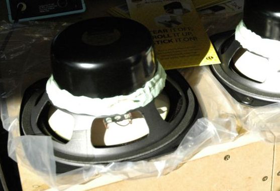

So far I have added some blu-tac secured with wool to try to damp the frame/magnet connection. (see picture)
There are various comments here and there I've made on related strings, I'll attempt to distill them here.
So far I installed the drivers to the cabinets about 4 days ago and gave them an 8 hour run at "watching TV" volume, a couple of CDs at "I'm listening to music" volume and a fair thrashing for half a Metallica CD at "let's see what they can take" volume this afternoon, (until my better half had a headache from it).
They are certainly sounding a lot better than when I first listened to them. (or I'm getting used to them) I have dropped the applied signal volume by about 12-14 dB since I started to maintain a normal listneing volume. my old Speakers are Tannoy M15 at 85 dB/w/m. These are a 2 way 8 inch bass reflex speaker. The worst sounding of the new and old speakers will be used for the rear surround channels.
Pit Hinder had some comments I cut and paste here and add my comments in <like this>:
Tweaking the drivers...YES! But taking a knife to them to add a phase plug amounts to open heart surgery. Try reversible measures first, you'll be astonished by what affordable drivers can do. <OzMikeH: if it helps a little bit I am not afraid to do it>
#1 The .98c trick. (Thanks GM for reminding us). Wrap a thread of wool around the whizzer, down where it meets the main cone. <I will try this, what size? thick and fluffy? what about a pipecleaner or too heavy?>
#2 Felt, or as innerconflict, the Nonphony from Caliphony, has proven to be good, simple household sponge. Use double sided adhesive tape to fix it to the inside of the basket legs. <I do not trust the double sided adhesive, I will try this tied on with string with some silicone sealant underneath>
#3 Caulking on the outside of the basket legs and (very effective) on the front of the magnet and in the gap between magnet and basket. <I have applied blu-tac so far, I was nervous about irreversible changes at first and blu tac can be removed, then I disassemble to finish/paint I will use caulk>

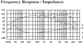

You obviously are free to do what you choose but the FE207E does not "run out of puff" at 12K. Check the spec sheet and ask some people who own them. They are essentially a shielded version of the FE206E with a little higher QTS. I have not found my FE206Es to fall off in the highs at 12KHz and I seriously doubt that Fostex would be selling many of them if they did since they state that the frequency response is "Fo to 20KHz". Just an opinion but you may want to listen to them by themselves in a suitable enclosure before you start diddling with crossover points and tweeters. Just a suggestion.
I know datasheets aren't everything. but what I see here is a 10dB drop between 11k and 13k
My ears tell me something similar.
At these frequencies it's mainly the whizzer, so the enclosure probably wont have a huge effect. I should have got the 206 I think.

I was going to put inside the basket with some 1/4 inch thick foam triangles near the centre, something as wide as the basket "spoke" tapering to a point about 2/3 of the way out from the centre. Will this help or will it increase the effective mass of the cone? (I am sticking it to the basket, not the cone) With an Xmax of 1.5mm i should be safe.
I want to glue some wooden wedges on the back of the basket "arms" back to the magnet cover to really stiffen it up and reduce turbulence over the sharp edge. I'll take pictures.
A passing comment from someone just made me realsie something,
The impedance of the FE207E at 10kHz is close to 16 ohms.
So should I be using 16 ohms as my driver impedance value for my crossover calculations?
I'm still learning about this speaker business, any advice is appreciatred

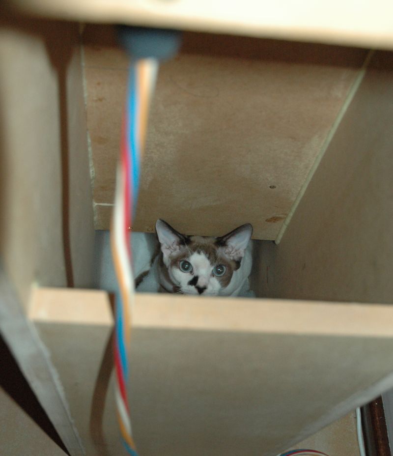

Interesting damping material
I have stumbled across some very dense damping material, the only problem is keeping it in place during loud passages.
It moves around so much I am worried about damage to the rear of the driver.
Any suggestions?
But seriously now, I think I need to make something to keep him out, any serious suggestions?
Any suggestions?
A fair question -having a cat enter your speaker cabinet could get expensive, and also damage the cat if it happens to be sleeping in there & you fire up Bruce Dickinson's latest solo album.
I'd try a stiff wire grill across the opening. It shouldn't ring significantly, and a touch of that is a sight better than a pair of ruined drivers or a deafened cat.
Guesstimating FE207E acoustic centre at 10kHz
How would I go about estimating the acoustic centre of the FE207E at 10kHz?
I'm guessing it might be something to do with a plane through the whizzer where it's diameter is a certain portion of a wavelength of 10k?
While I'm at it I need to do the same for the FT17H.
My test equipment consists of a PC for test tones and easily fooled ears. I can borrow a sound level meter (with A or C weighting scales) but it is a real hassle to get it.
The cabinets will be clad with ply, so I can chose the ply thickness to match my required offset between the two drivers.
Is it a horrible thing to mount the tweeters under the fullrangers? It's closest to ear height on these cabinets. I am also considering mounting them slightly off centre toward the outside - this appears to reduce the edge diffraction effects because the edges are now different distances. This leads me to believe there is an optimum offset distance so the edges null each other too.
I've bitten the bullet and ordered the crossover components and an inductance meter. I'll unwind some pre-made inductors until I get the right value. I may as well soak them afterward in some cheap varnish too.
For the 10k frequency the capacitances work out at 1uF and 0.5uF so I have ordered eight 1uf metallised polypropylene caps. I can match a pair and a double pair and use the last two for the playstation DAC output.
