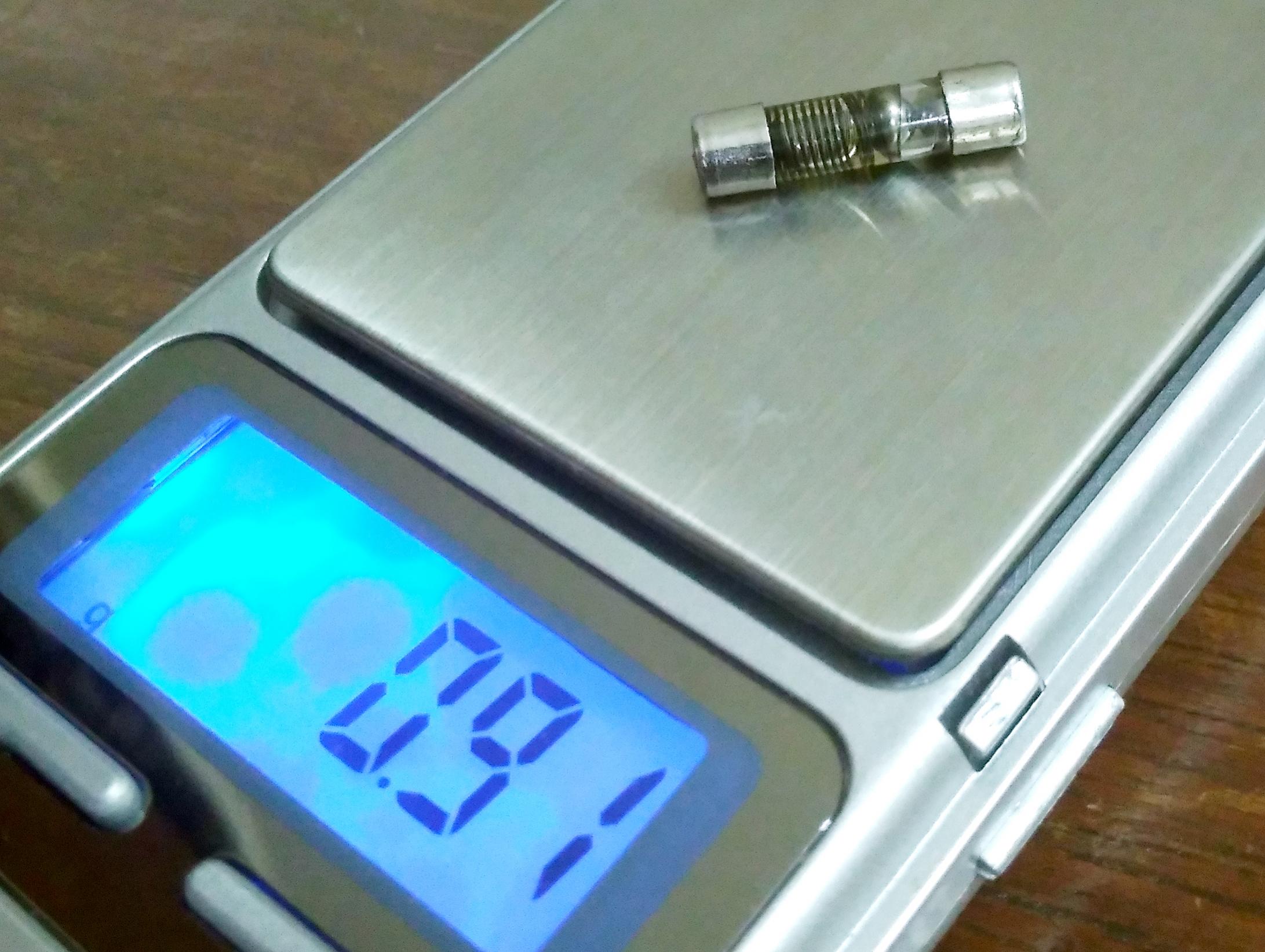

Hans, thanks for the numbers. The whole thing weighs 0.91 gms. The steel ball weighs 0.12 gms. I put in two. Obviously it did not work*
Bill, I wonder if we need spring at all. I observed while handling this feeble contraption, without spring, filled with sewing machine oil and held vertically the single ball settled at the bottom very very very slowly. If placed vertically and ball kept in the middle by a string will probably also work. OR discard the oil put on a appropriate springy flexible wire with weight attached at the end (Like angler fish) may also work. A 360 degree damper.
* Pardon me for not being clear. I was trying to see visible (As I don't have measuring tools as of now) damping of vibration of that particular track mentioned earlier which vibrated the whole headshell and not the resonance which is main aim of the damper.
Regards.

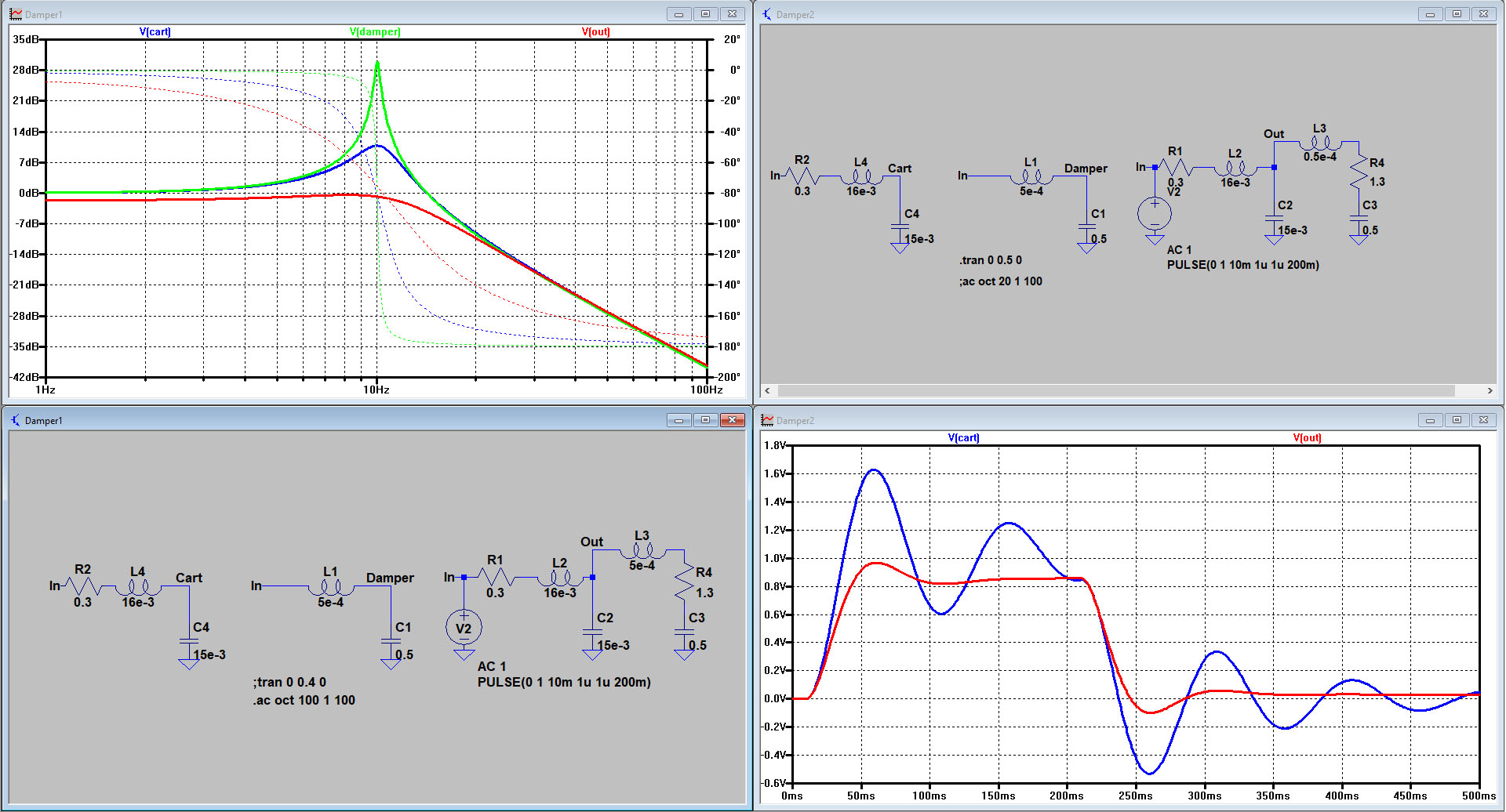

I have tried to put everything in a model to get a better feeling for quantities.
In the images below, you see 3 circuit diagrams.
The most left one is representing the Cart, having a compliance of 15um/mN (C4).
The weight of the cartridge is 12.1 grm, but to get the Fres of my Cart/Arm system, the effective mass including the arm must be ca. 16 grm (L4).
To get a resonance peak of 10 dB, the polymer suspension will have to present an internal friction of 0.3N (R2).
These parameters put in the model, are shown in the FR with the Blue line.
The FR of a 0.5grm ball (L1) on a 2N/m spring, or a compliance of 0.5m/N (C1) as proposed, having the same Fres as Arm/Cart, is shown in Green.
The combined FR of Cart/Arm with Damper is shown in Red.
To get the wanted damping, a Friction of 1.3N (R4) is needed.
The right side of the image shows the step responses of resp. the Cart/Arm without damper in Blue and the combination of Arm/Cart with damper in Red.
Hans

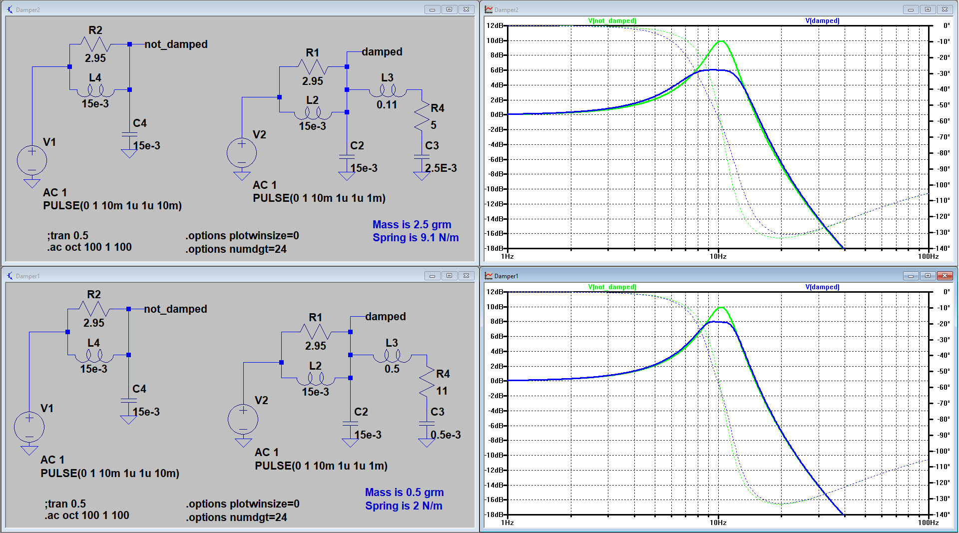

Never too old to learn, I was unhappy with the above results and started further searching.
Two things happened to be wrong:
1) The damping element in the Cart is integrated in the polymer Spring construction and should be parallel to the spring instead of in series.
2) I wrongly interchanged spring and mass for coils and capacitors..
For my MC cartridge this had no effect because compliance and effective weight happen to be the same, but for the attached damper it had a massive effect.
So I redid the simulations again assuming a Resonance Peak of 10dB, see Image below.
When using a 0.5grm ball with a 2N/m spring, damping at Fres will be 2dB when using the right damping fluid.
Going to a ball weighting 2.5grm with a 9.1N/m spring, damping will be 4dB with a more viscous fluid.
The first conclusion is that the heavier the ball, the stronger the spring and the more viscous the fluid, the more the damping can be achieved to suppress the resonance.
The drawback is that this extra weight is attached to your Cart/Arm, thereby effectively lowering Fres, setting a limit to how heavy the ball may be.
The second conclusion is that with a trough, filled with the correct damping fluid, a really critical damped system can be achieved, with hardly any weight added.
So more effective and much lighter and far easier to tune.
I also repeated the sim for a 6dB Fres Cart/Arm peak instead of 10dB.
Again using the 2.5grm ball, etc, the damping in this case was only 2dB.
So I must conclude that only with extremely accurate tuning, damping can be achieved, but the amount of damping is restricted..
It was a nice excercise, but for the above reasons, this option should be considered very carefully .
Hans
