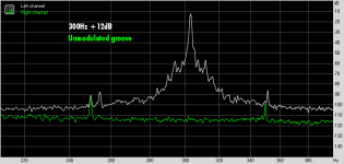

It’s not that low
I record 6db below the highest level of the test recording HFN S1 T9 (300Hz +18dB).
I haven’t changed settings since the beginning of the test recordings with the Stanton.
The Shure is 4dB lower than the Stanton.

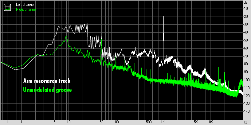

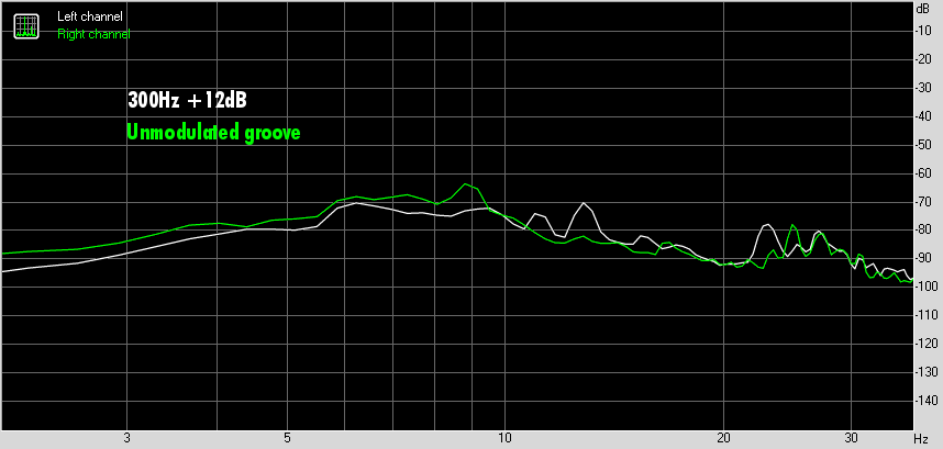

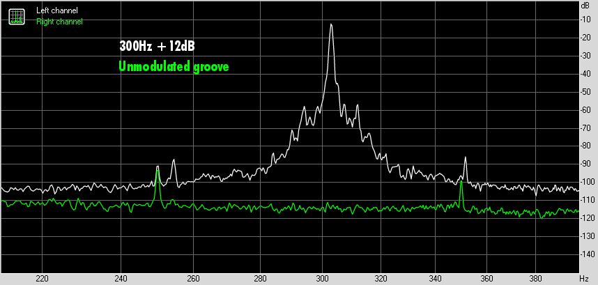

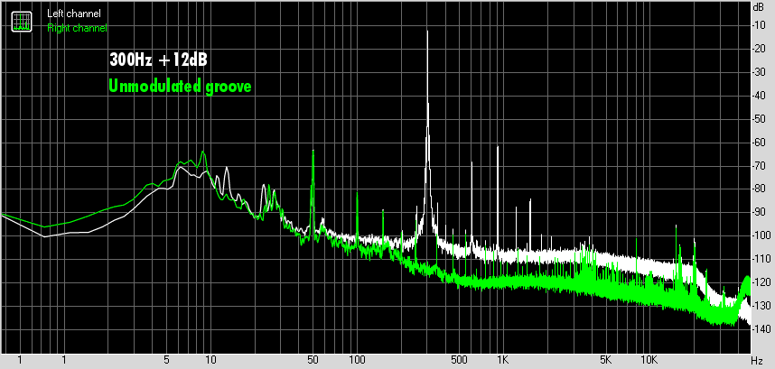

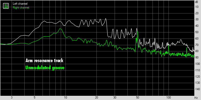

Here are some FFT plots of George's tracks from the Hi-Fi test LP.
I've put the unmodulated track on the right channel, and the test signal on the left channel for comparison. The arm resonance track certainly shows disturbance.
To me it looks like the JVC was running fast, and arm resonance is around 6-7Hz. Let me know what you see. Looking forward to Lucky's polar plots of this.

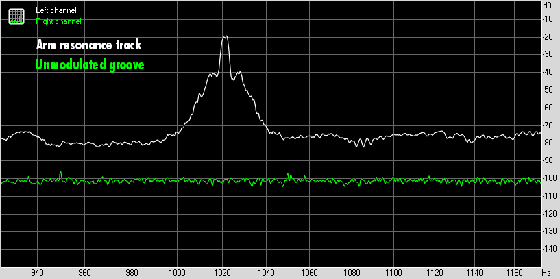

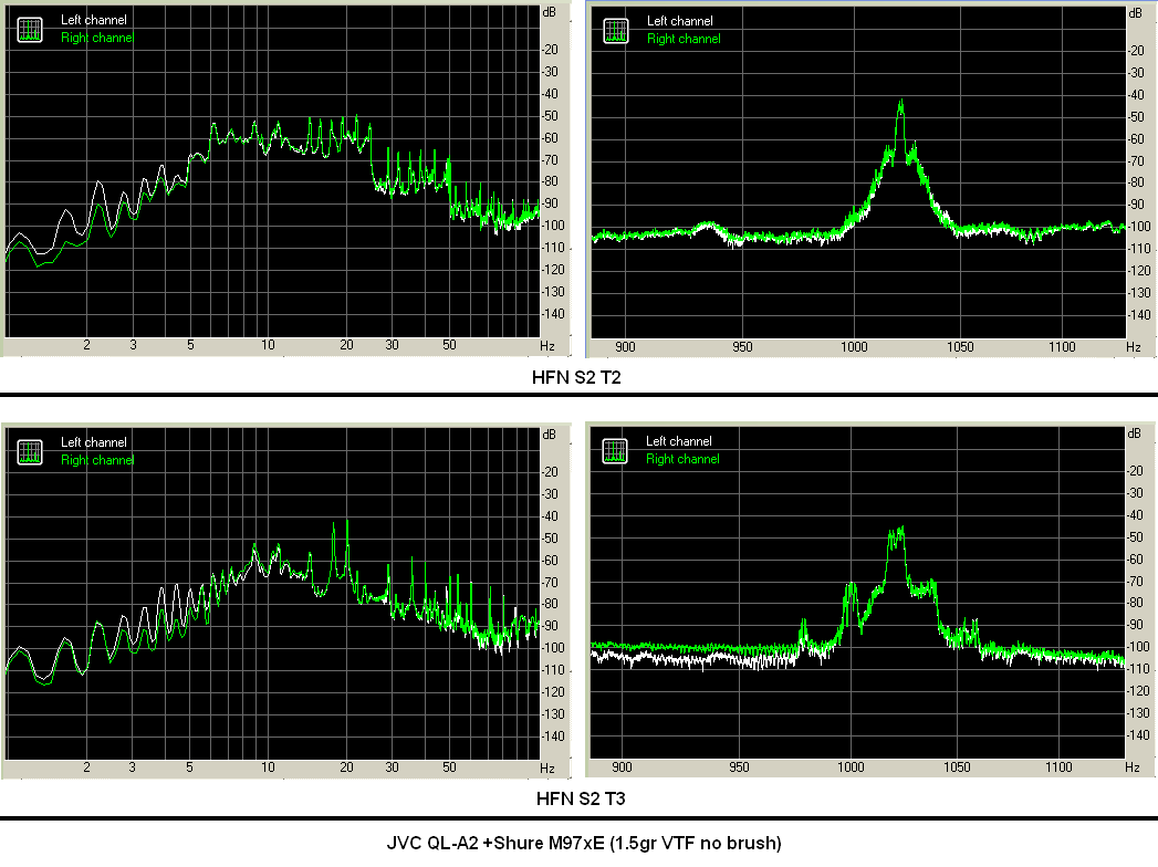

Thanks for an interesting post, Ray K - I agree, unwanted headshell motion is generally periodic, and in response to a sudden stimulus 'rings' for a time and settles. During which motion, there can be significant FM/pitch variation due to scrubbing.The only currently available test record I know that meets the criteria in option #1 is the “HiFi News & Record Review Test LP – Producer’s Cut”. Side 2, Track 2 of this disk has a resonance test that contains a fixed 1000Hz sinewave superimposed with low frequency tones swept through a range of 5Hz to 25Hz. At resonance, a spectral analysis should show the 1000Hz carrier, and 1000Hz +/- integral multiples of the mass/compliance resonance frequency.
Generally, this often shows up in polar plots, but depends on there being a suitable stimulus present. IMO the elephant in the room for stimulus is variation in stylus-groove friction, which depends on many variables such as vinyl surface, stylus profile, polish, geometric accuracy and cartridge alignment etc etc
Yes, programme material can/does, in principle, provide stimulus.

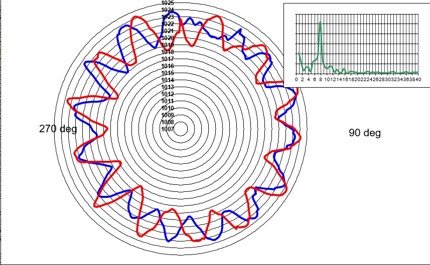

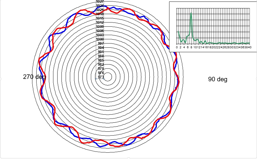

Thanks to George for providing a test recording of the HFN S2 T2 resonance sweep you mention. Attached is a polar plot of a section of George's file near 8Hz, which provides a neat continuous stimulus for headshell motion, which shows up clearly in the FM polar plot.
This shows the effect neatly, methinks.

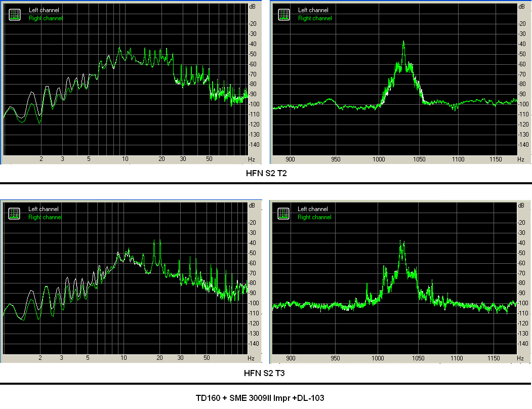

Here are the same tracks but through TD160 + SME3009II Impr + DL-103 (Feb 2, 2010)

I noticed that, too. Don't know why.The sidebands around the 1kHz peak are quite different between S2T2 and S2T3.

I realised overnight that I hadn't adjusted the polar plot radial line scale to accommodate the drop down to 1kHz. I try to keep each scale line to represent about 0.1% pitch variation - said to be about the threshold of audibility for most people.
So here's a re-plot of that polar plot of George's file JVC QL-A2 M97eX 1.5 HFN S2 T2, just the section around 8Hz.
At this (proper) scale, I think one can readily see the large significance of the cart-arm system/headshell motion to pitch stability. In this case, it even dwarfs record centring............

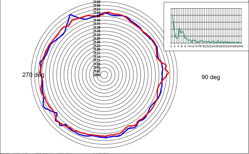

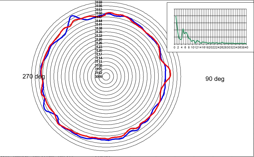

Take a look at the Left and Right balance with a vocal (centre channel) removal effect. I can clearly see the stereo position wobbling away from dead centre twice in a revolution, one position much stronger than the other. This means that we have stereo position modification on top of FM effectsHere is a 3150hz sample from a Phonosophie No3 turntable.
Phonosophie P3 3150Hz Tone /Phonosophie_P3_3150Hz_Tone.wav
msdin
Yes, there will be AM modulation of the R-L difference 'channel' according to the direction vector of headshell motion.Take a look at the Left and Right balance with a vocal (centre channel) removal effect. I can clearly see the stereo position wobbling away from dead centre twice in a revolution, one position much stronger than the other. This means that we have stereo position modification on top of FM effects
Although we discuss headshell motion as though it were vertical and lateral, in practice the system is continuous in 2D and the headshell is free to move in both lateral and vertical directions at the same time - and does so. A realistic path might be a lissajous type figure in 2D, and from moment to moment the vector might vary.
This is bad for stereo image stability, of course.
And yes, this is separate and supplementary to FM/pitch modulation, which depends simply on the relative velocity of vinyl past the stylus and is the same for both sum and difference signals, no matter what vector headshell motion has.
To show this, attached are sum (lateral) and difference (vertical) 'channel' polar plots for exactly the same section of that Phonosophie TT file - one can see they are pretty much identical, and have the same spectrum in FM. Red and Blue traces are two successive revolutions, as usual.
LD
