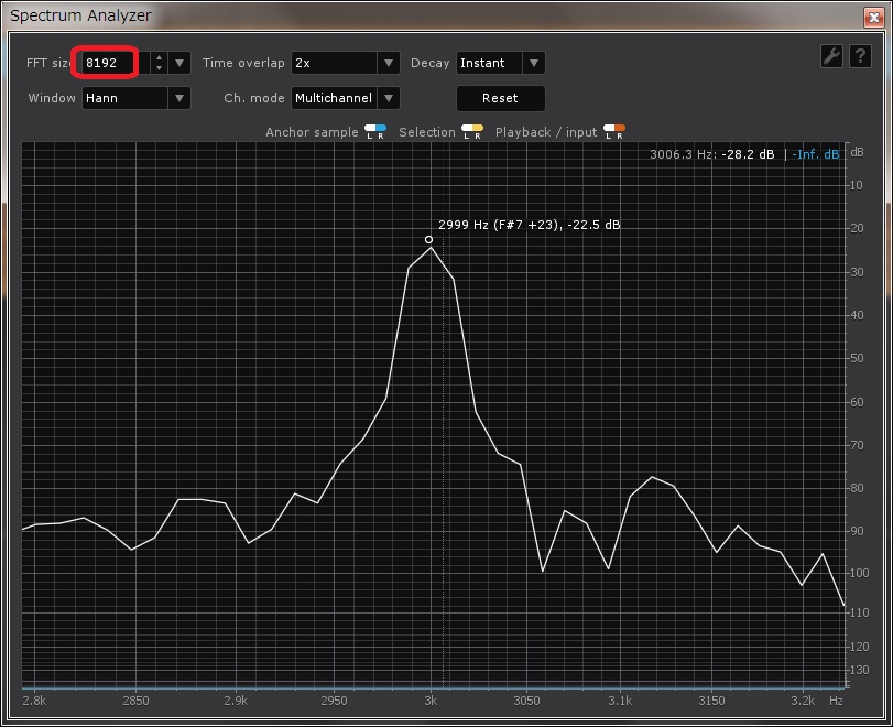

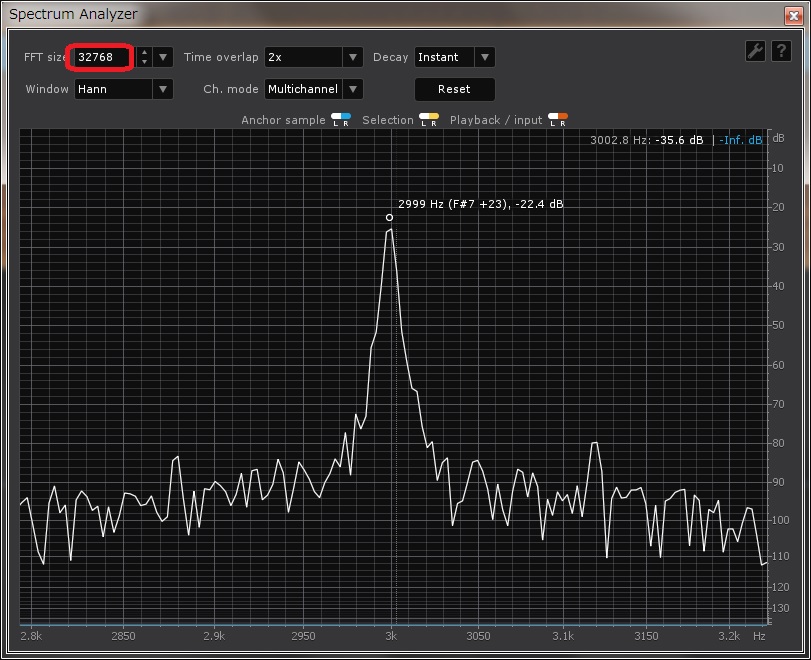

Here's FFT of my turntable PL910(kyocera late1980).Testrecord is "stereo reviiew's model sr12".When FFTsize is 32768, calculated data is about 0.3second.When 8192,about 0.085second.
I can't measure speed drift from FFT.But I suppose peak level of successive small size FFT(8192) is referrence to average turntable speed.They are fairly stable more than predicted.:hypno2:

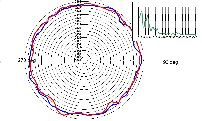

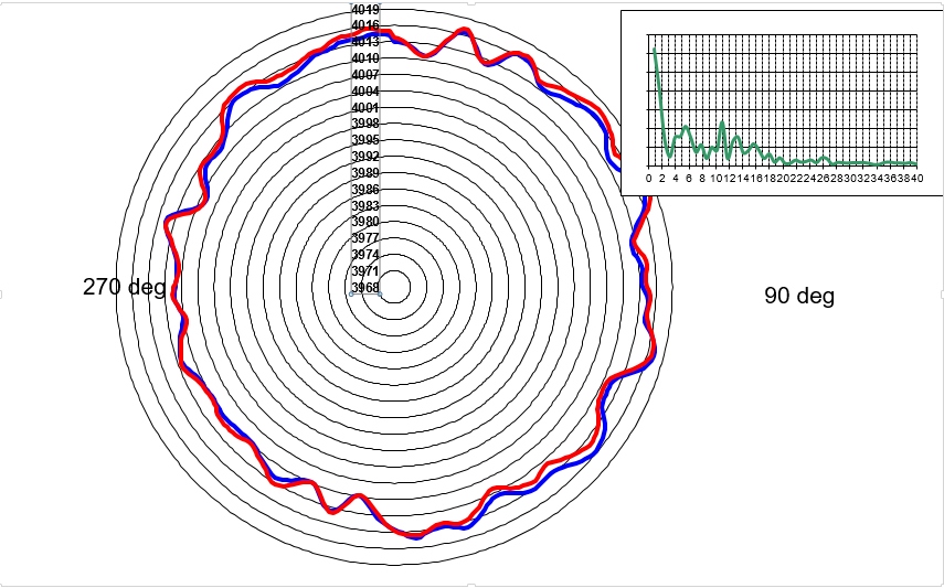

Here's the polar plot for that file from your Phonosophie P3. Also, another plot from a Phonosophie P3 file I had in the archive, for reference which happens to be at 4kHz but with the same scale so it's easy to compare. The archive one is the 2nd attachment.
Overall I would say your P3 is good and healthy. If you wish to improve it, something seems going on around 6Hz or so, which also occurs on the archive P3 so might be drive related. Also you have something going on at just over 2Hz which doesn't seem to crop up on the archive P3.
You have far more stable 'once per revolution' eccentricity like rotation speed variation than the archive P3, and also your cart/arm resonance seems more stable.
BTW, the y-axis on the inset spectrum auto-scales. So when there's a lot of eccentricity, as in the archive P3, it looks as though all other contributions are smaller, whereas that's just an artefact of the scale.
Hope this is interesting/helpful ?

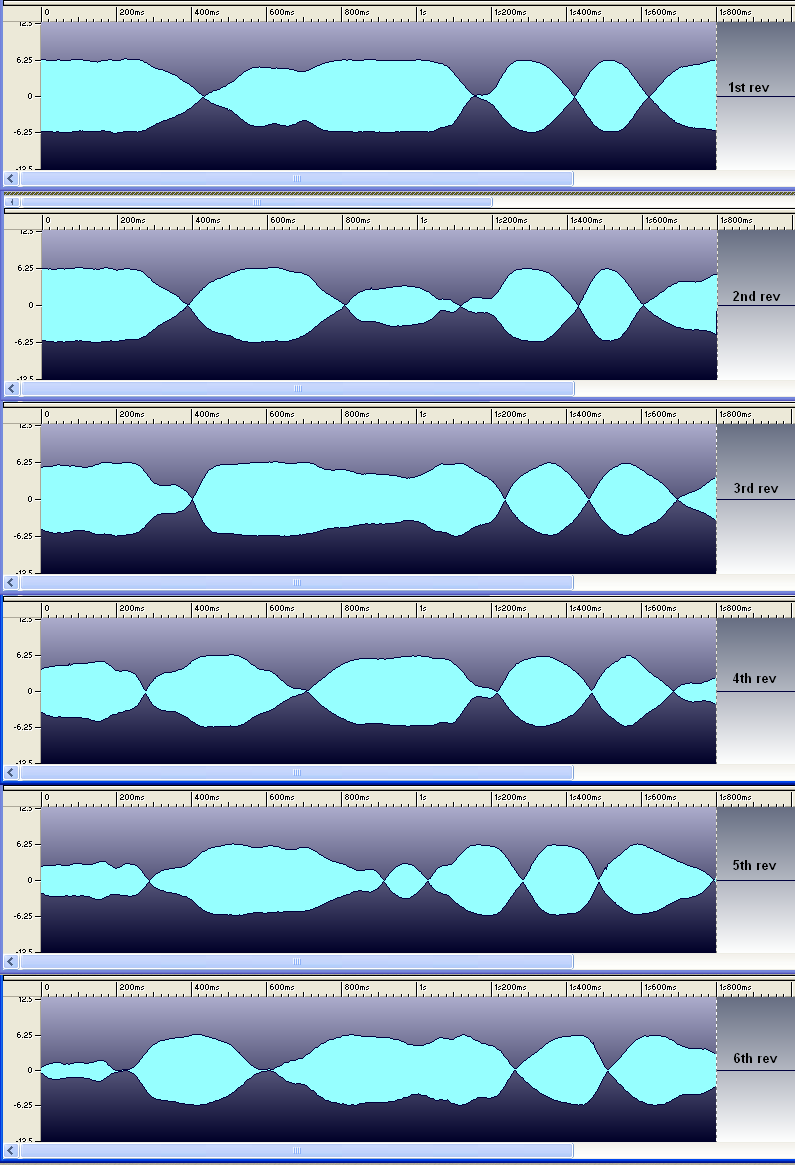

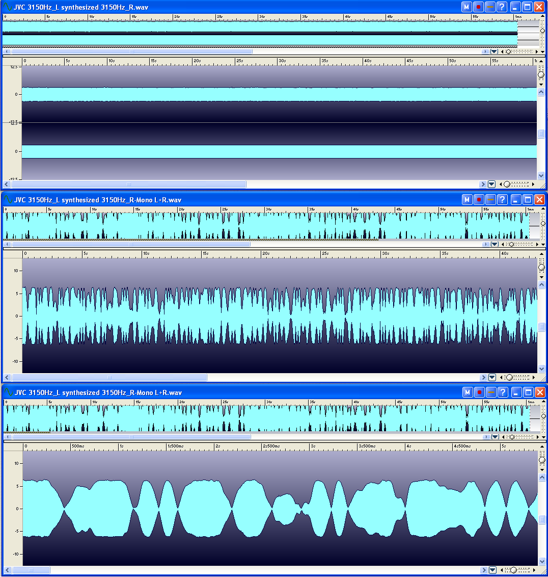

As the lowest tech possible :D, no math approach, I tried heterodyning a single frequency vinyl playback file with a computer generated test tone of the same frequency and same level.
I made a new file. L channel is the vinyl playback tone, R channel is the synthesized tone.
I synchronized the two tones at the beginning of the file.
Then I saved the file as a mono (L+R) file.
See the outcome for a 3150Hz track from the JVC QL-A2, for which Lucky kindly provided the polar plot in post #1257.
I measured the period T in sec of each pattern .
1/T is the frequency component of this pattern.
The more times the same pattern appears, the stronger it’s freq component is.
1.8sec frame length is one revolution of the platter.
This way I can locate all the modulating components, i.e. the Cartesian Freq-level inset from Lucky’s analysis.
