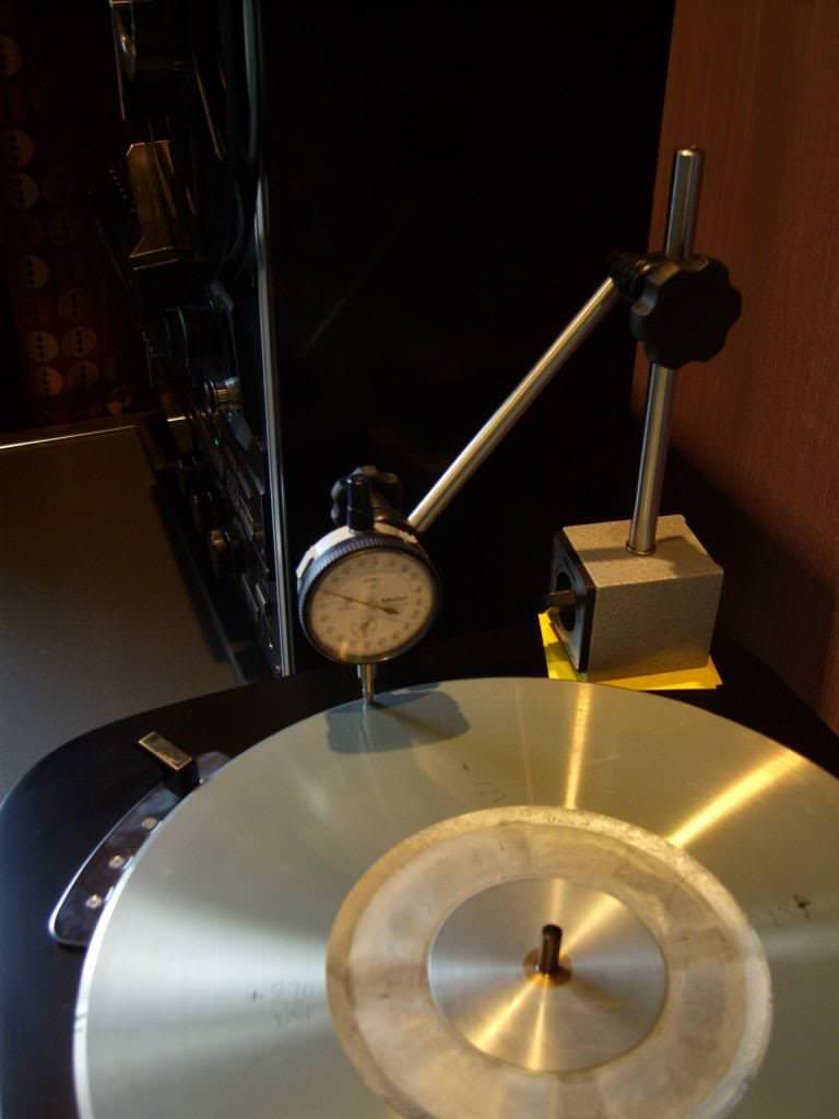

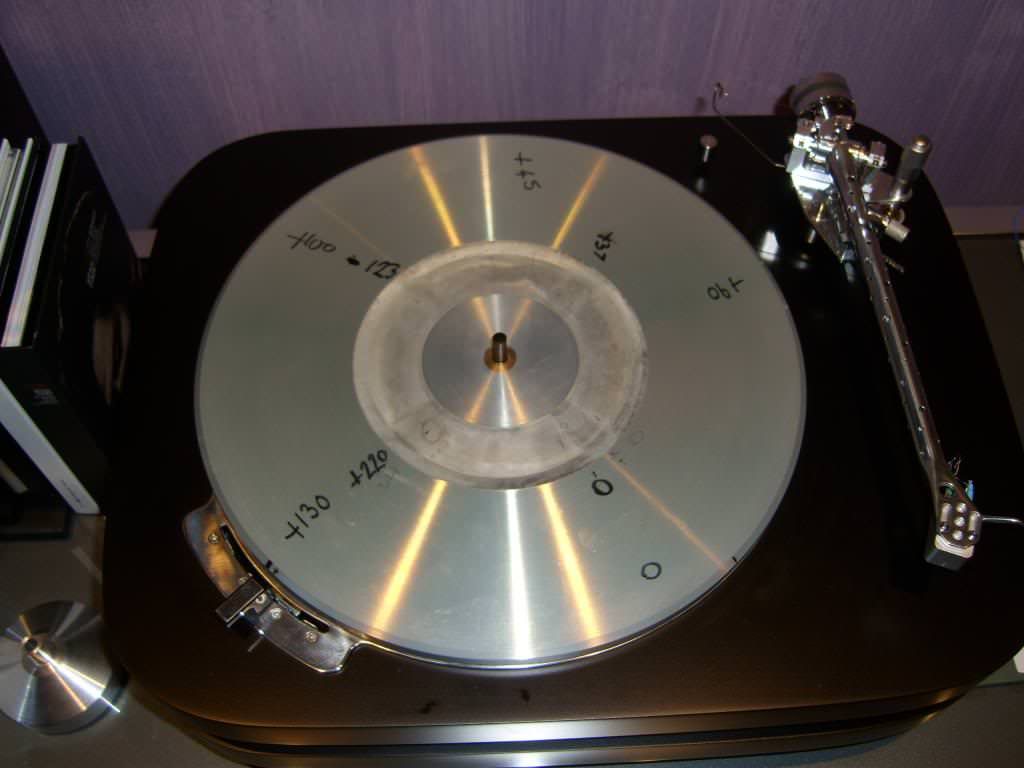

... how to know vertical eccentricity of the platter ?
This is how I checked the platter flatness of my Lenco. And the result -
I obtained another platter which, whilst not perfect, was better than this one.

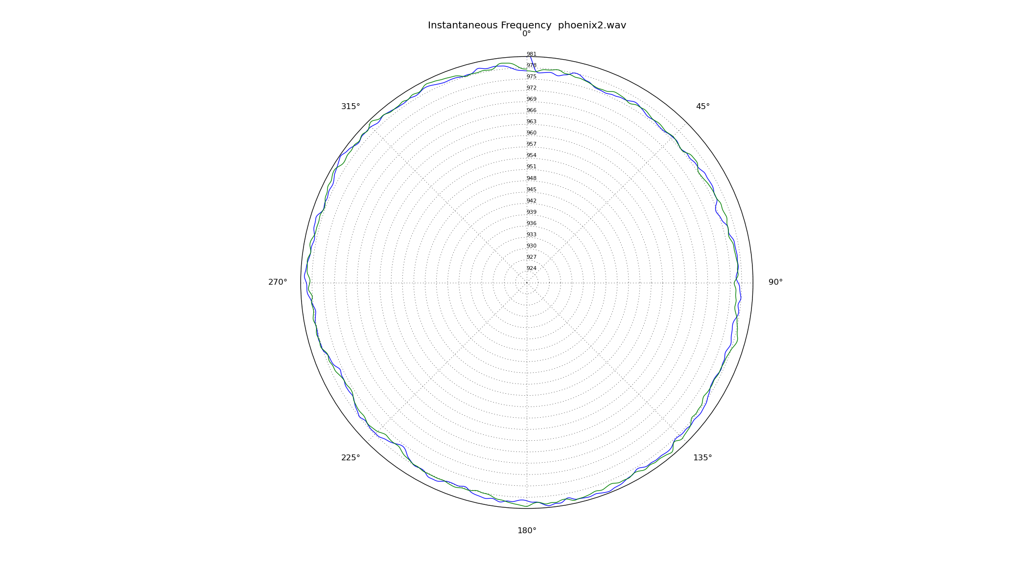

Here is another one this time with 1khz at 'Normpegel' whatever that means (odB?) from german Analogue Audio Association Test LP.
This time pitch is off too, but downwards, so one might conclude indeed the testrecords being unreliable not my platterspeed.
So, what problems can you spot looking at that plot?
It is good to remember that these tracks were often just there for amplitude calibration or wow and flutter measurement where the absolute frequency was not that important. There remains the option to actually count a revolution of cycles (there must be somebody out there crazy enough).
EDIT - Those USB scopes are good enough that one could probably take a fine needle and raise a burr on two consecutive bands and do it in software. I know there are folks that use a microscope and needle to remove skips and bad pops. CRAZY!

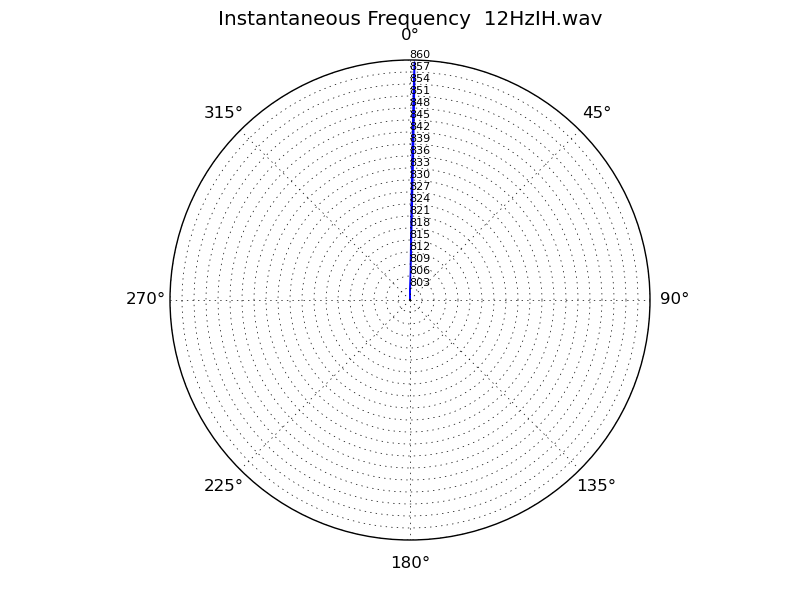

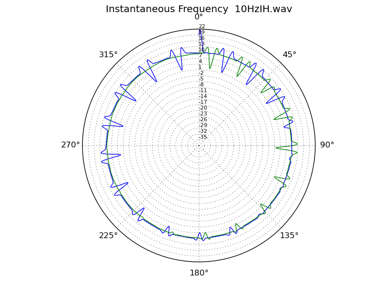

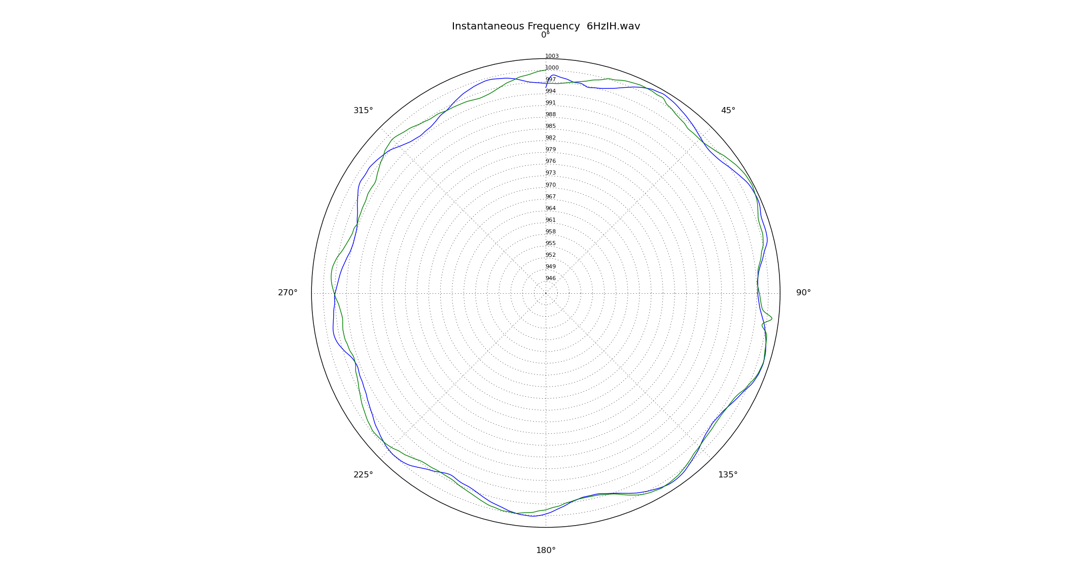

This time with the tonearm-cartridge-resonance test from the Image-Hifi Test LP.
Scott, it seems your script can't lock on some test tones (the resonance of my arm-cart combo is around 10Hz).
10Hz sounds and looks wobbly, 12Hz & 6Hz sound reasonably well.
Only now I see that in the 10Hz the script locked on the Resonance-F, not on the 1kHz-tone...

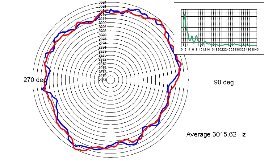

LD, would you consider processing the attached file 12.zip as 12.wav and see what you get? Any obvious conclusions to draw from my circular plot (resonances, bumps, whatever)?
Thnks,
R.
OK, got the file this time, thanks.
Here's the polar plot, which is similar in form to yours but includes the inset spectrum which might provide some pointers.
It's unusual in shape in that there appears to be a strong near 2x rev component. I'd assume most of the remaining quasi-random content is from the cart-arm system, perhaps with resonances c 8Hz and 12Hz.......?
Without knowing the drive system, it's tough to comment further, other than it's unusual and a suitable case for treatment perhaps ............
HTH!

You'll see that several odd things appear to have happened: the 0 deg file speed is significantly slower than the 90 deg file, and the eccentricity has moved by nearer 180 deg than 90 deg.............
Any ideas what else might have happened between recording the 2 test files ?
LD

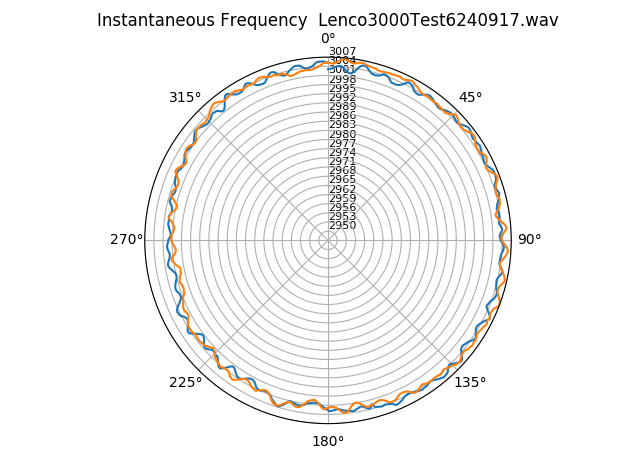

Whilst I use the KAB Strobe Disc to set the TT speed for normal listening, when carrying out investigative work I resort to the PlatterSpeed app to check the speed and note excessive Wow and Flutter. This clearly is not accurate enough although to be fair I am trying to set the speed using a moving target. Further, I do find it difficult to centre test records certainly to the accuracy we are looking for. So a combination of the record being centred slightly differently and me adjusting the TT speed to compensate are probably the reasons for the variations between traces.
I have just repeated a speed test but this time set the Lenco’s speed using a frequency counter. The result is below and the sound file is attached if required (no position pulse recorded).
View attachment Lenco3000Test6240917.zip
From the polar plot is can be seen that the frequency is, between 315° and 170°, 3001Hz. It decreases by 6Hz @270°; this could be due to the test record but also the platter flatness (or lack of!)
Otherwise, the spectrum looks very like a Lenco - that characteristic ~ 25Hz variation from the motor shaft. It looks quite healthy, though - I've seen far worse Lenco's by measurement, and I've never seen one without the ~25Hz content. I'd assume the ~9Hz content to be cart/arm resonance, but can't remember how many poles the Lenco motor has (4 I think?).
LD
I agree with your observations, the 25Hz is motor shaft rotation although my Lenco has display significantly reduces amounts as can be seen here. I think my motor needs a service!
The 9Hz is arm/cart resonance and the motor is a 4 pole one. And thanks for the comments about the TT’s health. It was by carrying out speed accuracy testing that I gained a better understanding of the Lenco’s drive system and hence was able to tune it up to give the performance it now has; it was somewhat worse when I first started!

I've played around further.
Could you post the files, typically tonearm cartridge resonance tracks have no 1kHz only the low frequency tones which are far outside the parameters that we are checking. The fact that you actually got a 10Hz circle amazes me.
