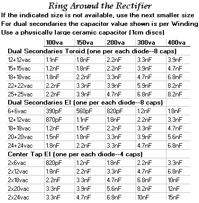

Hi Dave!
This transformer, suitable for an economical LM3886, LM3875, TDA7294 build, is a 48v center tap, which is 24vac, 0v, 24vac. Transformer Example
48volts x 3ampers = 144VA
(48 * 3) = 144
In this thread, you can find a "cheat sheet" chart and spreadsheet where you can look up the estimated capacitor sizes to use.

Here's a handy smaller chart for it (attached).
*And, if you get unwanted audio effects, its probably because the capacitance size is too large. Expected results are "less shout" in direct proportion to "less dynamics" and a cooler heatsink temperature (as measured by temp probe).

With that said, the table specifies estimated values for use with either ei or torroidal type transformers. Im using a chinese sourced unshielded dual-25v p-core split bobbin type transformer to reduced noise coupling between primary and secondary windings.
With a p-core, which table of values would i be best served with, ei values or torroidal values? Or might a pcore need different values all together? I would guess a pcore has more in common with ei types but would like some thoughts.
For those competent and trained with the maths, im using 25 + 25 split bobbin 50va 1a p-core. Im assuming then 1.1nf or 820pf across each secondary, prior to the rectifiers.
I've seen a word of mouth recomendation to use .22 (uF?) snubbers as per the original designers recommendations. Thoughts on that? Its a huge value discrepancy from the suggested values here. The pearl likely draws less than 100mA of dynamic load..

Hi guys.
I read all that thread but I found nothing for my case.
I use a 300va 25+25v but secondaries are parallel to give 35V 12Amp.
If I read table on post 22 http://www.diyaudio.com/forums/chip-amps/128278-tuning-ps-transformer-gainclone-3.html#post1588611
Can I conclude I must use a 12nf capacitor like on 300va 25-0-25?
